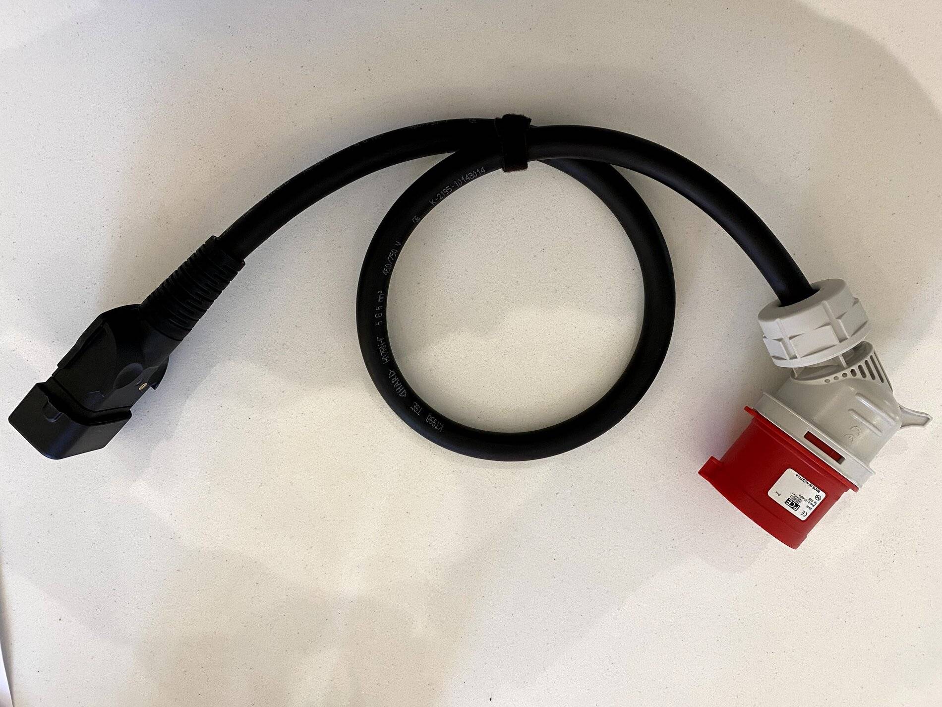

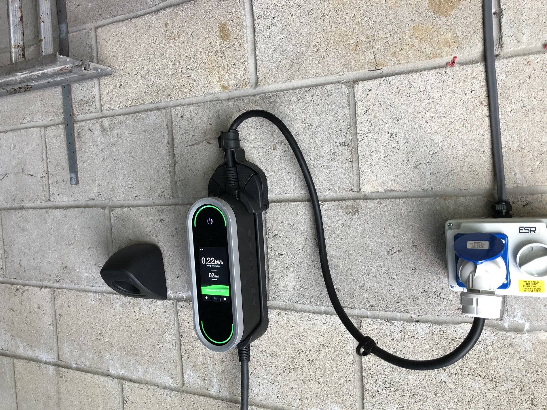

Has anyone fitted the charger to 3 phase? I’ve took a picture of the industrial socket in the demo last weekend and just noticed it is not 3 phase? Any ideas? I want to charge at 11KW at the office.
I certainly have mine connected to three-phase, neutral and ground at 400V AC and the Porsche Charger Connect output is 22kw ! However, the Taycan only takes 11kw (hopefully at some point a retrofit for 22Kw will be available).

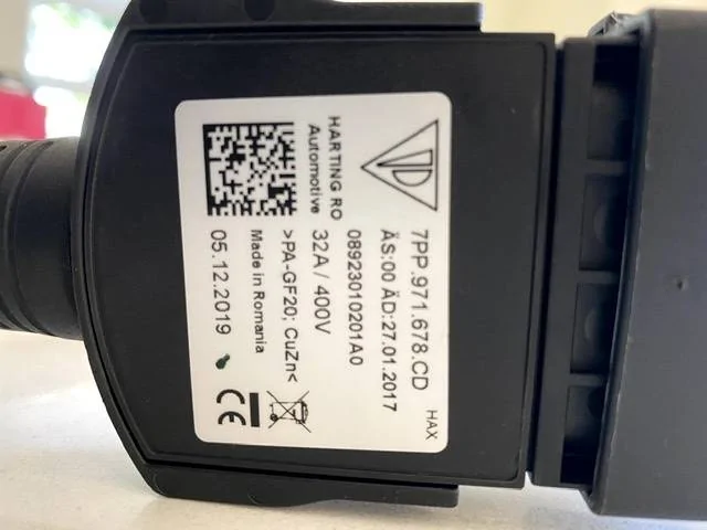

Thanks, do you need to order a three phase plug? The blue one that comes with car is only three pin single phase 32 Amp.
You must order the cable in 5 pin 32Amp (22kw) industrial connector (red) configuration when configuring the car. In Spain it is a no-charge option, as is the 7,5 meter long cable, which I ordered. I had to install a very heavy gauge 125 meters-long cable to withstand the current draw with no heat or significant power loss from the electrical mains to my garage. I also ordered the Porsche Home Energy Manager, which we shall install in a couple of weeks after receiving the extra probes needed for three phase and solar three-phase inverter installation.

You must order the cable in 5 pin 32Amp (22kw) industrial connector (red) configuration when configuring the car. In Spain it is a no-charge option, as is the 7,5 meter long cable, which I ordered. I had to install a very heavy gauge 125 meter cable to withstand the current draw with no heat or significant power loss from the electrical mains to my garage. I also ordered the Porsche Electrical Home Manager, which we shall install in a couple of weeks after receiving the extra probes needed for three phase and solar three-phase inverter installation.
Thank you. That’s what I thought with the red connector. I do not believe that was a option when I ordered so there will need to be a chat on collection to get this sorted.

I have a home charger that is installed with a tethered cable to the Taycan (when it arrives). But I've bought an enclosure for the porsche charger and will fit that at my office with 3 phase supply, meaning 11KW charging.

it’s a bit of a con, the charge is really a charger for use at home mounted either in or out of the optional case.
it’s way too bulky for mobile use but as I’m getting a Zappi installed next week (so I can charge from solar) then I’ll just keep the Porsche one as a backup via the 5 pin 32 amp socket as it will allow 11kw charging.

Brilliant. Thank you. I’ll send the pics to my parts guy as he was quite confused. But he did say he liked a challenge. Which to be honest, I find it amazing that these guys dint have this kind of stuff in stock for Porsche.
