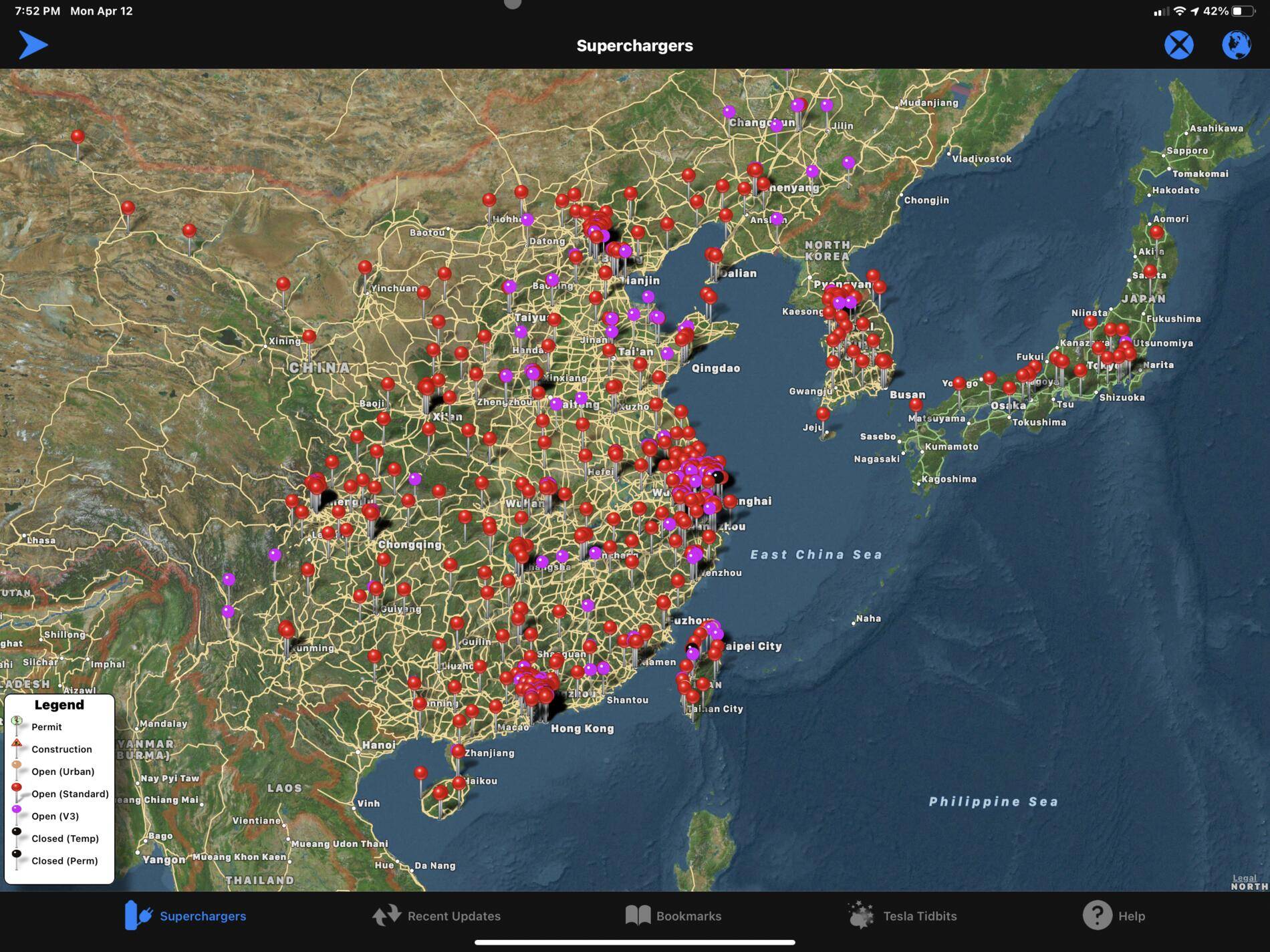

also look slike more than Shanghi has Tesla superchargers - or is this data inaccurate?
Including Korea and Japan. Going skiing from Tokio to Niseko, after the ferry crossing you run out of juice.
Driving from Shanghai to any other place you need lots of planning.
Zoom in and you see how thin it is.

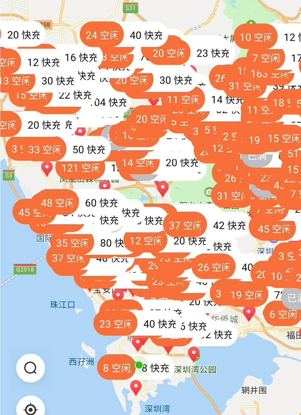

Porsche Taycan Model 3 vs. Taycan Turbo S Track Race 1618286524093
This is local district level, you can only find about 4-6 SCs.

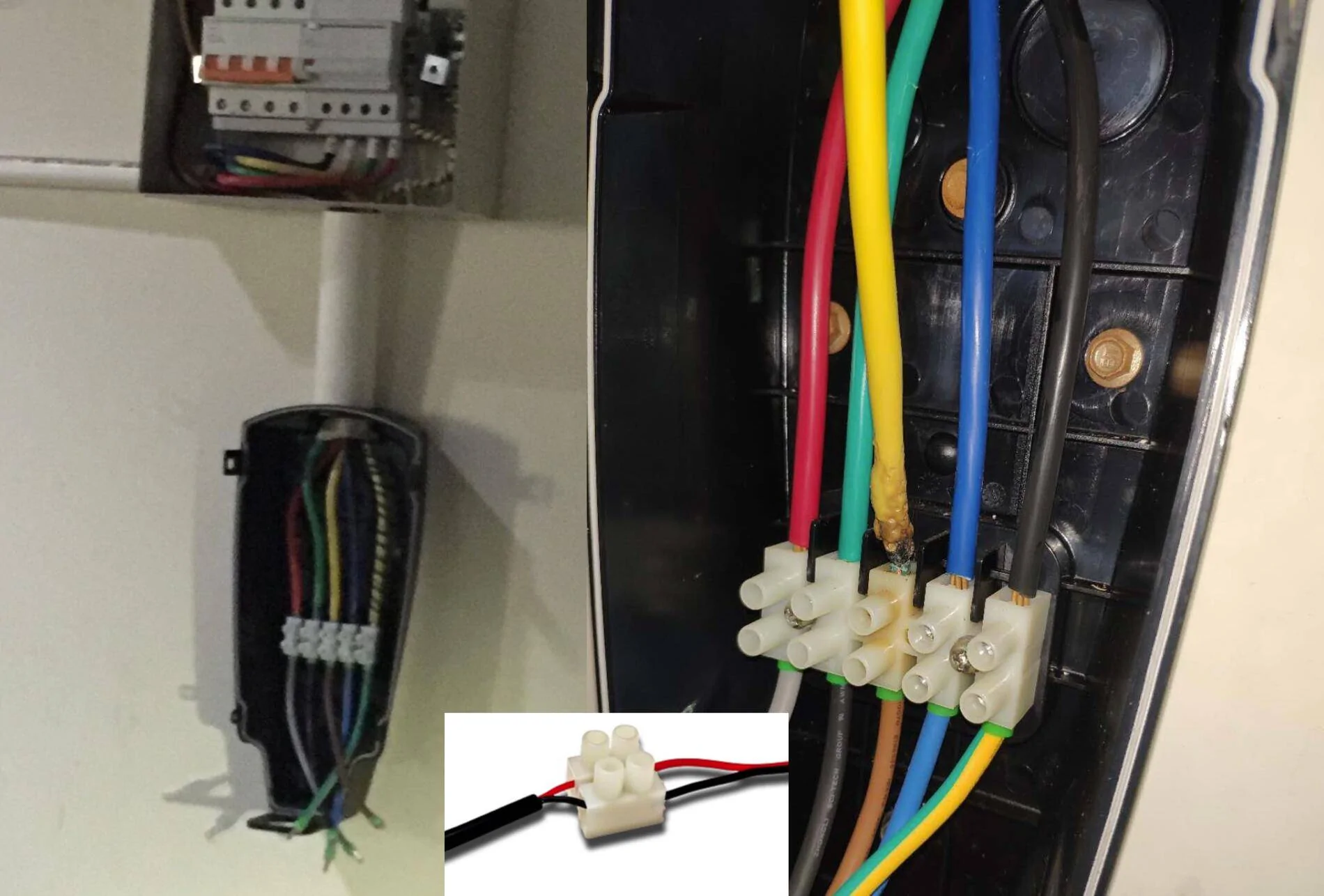

you wall box melt down was bad wiring connection not equipment failure.
No it was not! The connection is part of the wallbox. This type of terminal block connector is very cheap and usually used for low amp connection like inside a lamp.
Porsche Taycan Model 3 vs. Taycan Turbo S Track Race 1618887847386
These connectors cannot guarantee a proper connection when installed with physical wear and tear. The wallbox was installed in a shared car-park.
  • The cable was thrown over with every charge
  • The building had many construction works (vibrations) done over the years
  • The wallbox was switched on and off with the fuse box above many times.
Result is know.
This is NOT an installation problem, unless the electrician hired by T to install the wallbox was indeed too stupid to screw in 3 screws properly. It is a design problem, particularly when a fault like this destroys the whole wallbox!

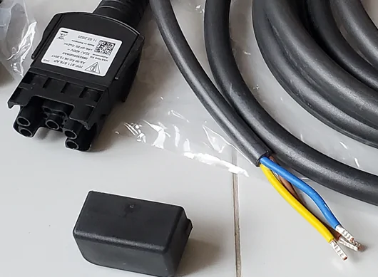

This is how a proper connector looks like, double locked, guaranteed to withstand weather, wear and tear, vibrations and comes with cables reaching straight into the fuse box.
Result is know.
Not an equipment fault!!
This is a serious bad workmanship by not tightening the screws to specified torque.
I you look at the top of the picture you will see exactly the same installation done in the fuse box.
We all know you have something against Tesla, but this Is not a Tesla fault.
Yes it is! They designed it, they produced it, they installed it including the cable and the fuse box! You can make excuses all you want but crap is crap!
