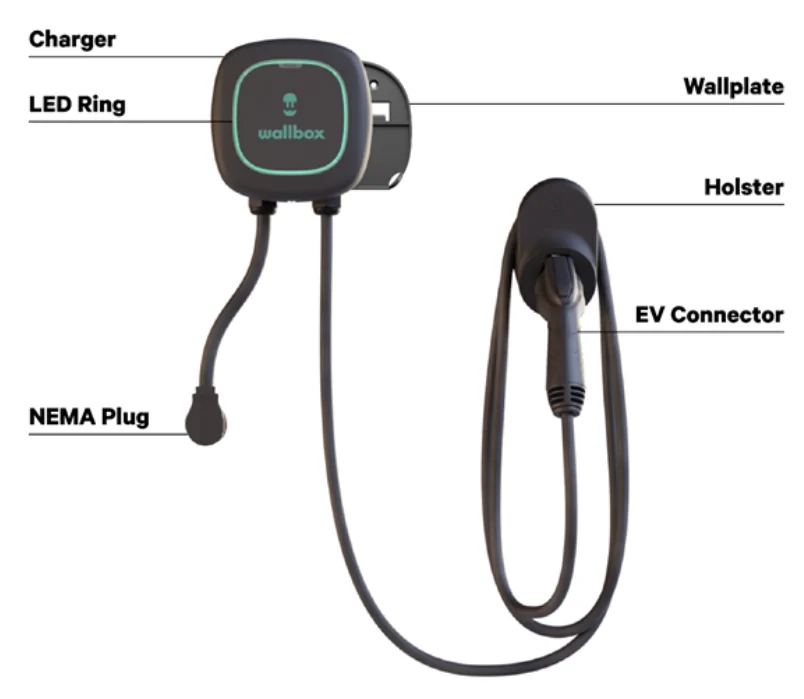

No! Most likely the problem is the switching on/off via the fuse box. Had similar problem of overheating/meltdown with electric floor heating units - that was indeed an installation problem but also NOT a loose screw!
The wallbox meltdown is a design problem. Check out other wallboxes, which have solid built in cable coming out of the box straight to a socket or a fuse box.
1,100
835
I do not understand what you are trying to prove with this Picture?
Would be more interesting to see how that cable is connected under the charger lid. Probably with the same connections and screws!
I have my whole house with its fuse boxes and housings prepared with connections with screws at incoming power as well as at every fuse and earth leakage switch. And we are talking three phase supply with over 60 amp per phase. And the Tesla charger properly installed, with the same installation as yours and 22 kW power for a Zoe.
