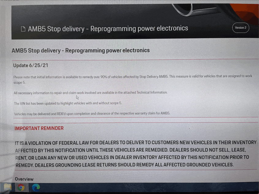

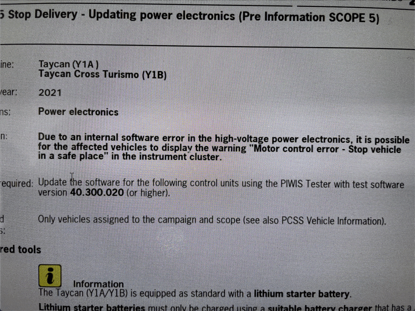

My new 2021 Taycan 4s arrived last week and I was planning on picking it up Saturday. I've been told that there is a AB5 Stop Delivery - Reprogramming Electronics hold on it and that the "update" will be available on Monday 6/28 or Tuesday 6/29.
Here are a couple of screen shots my sales rep sent me.
Porsche Taycan Motor Control Error Fix (2021) AMB5 Stop Delivery
Porsche Taycan Motor Control Error Fix (2021) AMB5 Update Description
I'm hopeful that this will fully address the Motor Control issue. (Sorry the second picture isn't more clear - this is what my Rep sent me.)
I can't tell you how helpful this is. Your sales rep is to be praised for his transparency and knowledge. It's frustrating because the level of professionalism and expertise from dealer to dealer varies widely and veers in many cases towards irresponsibility. Thanks for posting.

I emailed a contact of mine who works for Porsche to get the skinny on the AMB5 software update that is currently required before the dealers can release any newly arrived Taycans for sale. Here’s the details (edited for clarity):
“The AMB5 Stop Sale campaign is for sudden power loss which is due to faulty communication with the High Voltage Power Electronics system which needs to be reprogrammed via this update. The new software is available for most Taycans as of Friday. Most likely your dealer will complete the Stop Sale either Monday or Tuesday as the instructions were just released to the service teams for most Taycans.”
I hope this doesn't muddy the waters any further and I don't know if this is an update available to current owners. I'd recommend reaching out to your dealer to see if this is something they can perform on currently owned Taycans.
