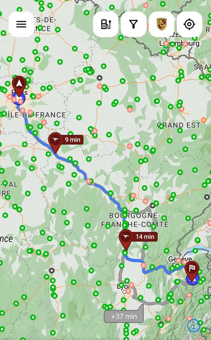

A nearly 600 km (373 miles) trip from Paris to the Alps showcased the Taycan Turbo Cross Turismo’s strengths and some areas for improvement. The Ionity charging stations along the way were busy, but charging sessions were impressively short. Even with battery pre-conditioning, it wasn’t possible to reach the full 300 kW charging speed. However, stops were extremely efficient—just 15 minutes per charge, which is 5 to 10 minutes faster than my 2020 Taycan Turbo. The charging curve stays remarkably high for a long period, which is a clear upgrade.

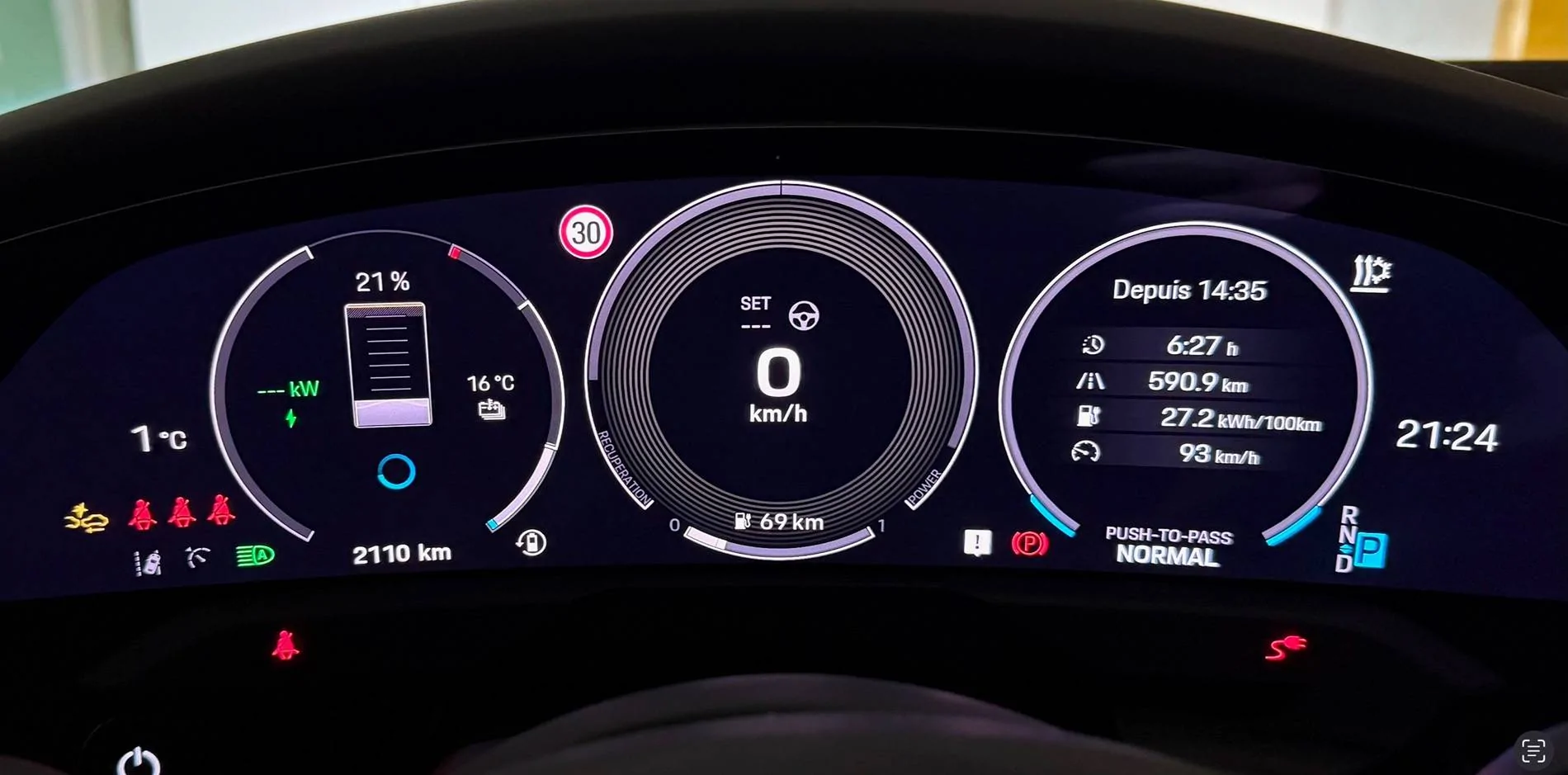

This is where the experience was slightly underwhelming. While the cold weather (around 0°C/32°F), a brisk average speed of 93 km/h (58 mph), 20-inch winter tyres, and mountainous terrain certainly played a role, the range fell short of expectations. With a 97 kWh battery and a consumption rate of 27.2 kWh/100 km (2.28 miles/kWh), the estimated range was 360 km (224 miles). For comparison, my previous model never exceeded 25 kWh/100 km (2.48 miles/kWh) under similar conditions.

do you have some kind of detailed data ?
I guess you charged once, the app should be able to give you the consumption on the 1st part, and on the 2nd part of the trip. You went up (more than 1000m ?) and that costs a lot. you'll see the difference when found down.
But that won't explain why your consumption increased by 10% compared to the 2020 model.
I do the same trip (about 750km) twice a month. Consumption can be very different, depending on the weather (wind, rain, temp.), average speed, initial condition (batt. temp), etc.
I wouldn't come to a conclusion on a single trip

The journey included two 15-minute stops, partly due to crossing the Morvan massif with nearly 800 metres of elevation gain. Consumption was high from the start due to wet road conditions, but I can’t comment on the wind.
You’re right, the app is providing more detailed data for each segment (27,3kWh / 26kWh / 27,6kWh). The elevation gain had an impact, and I expect better consumption on the descent. I’ll gather more data on future trips to confirm. Thanks for your insights!
