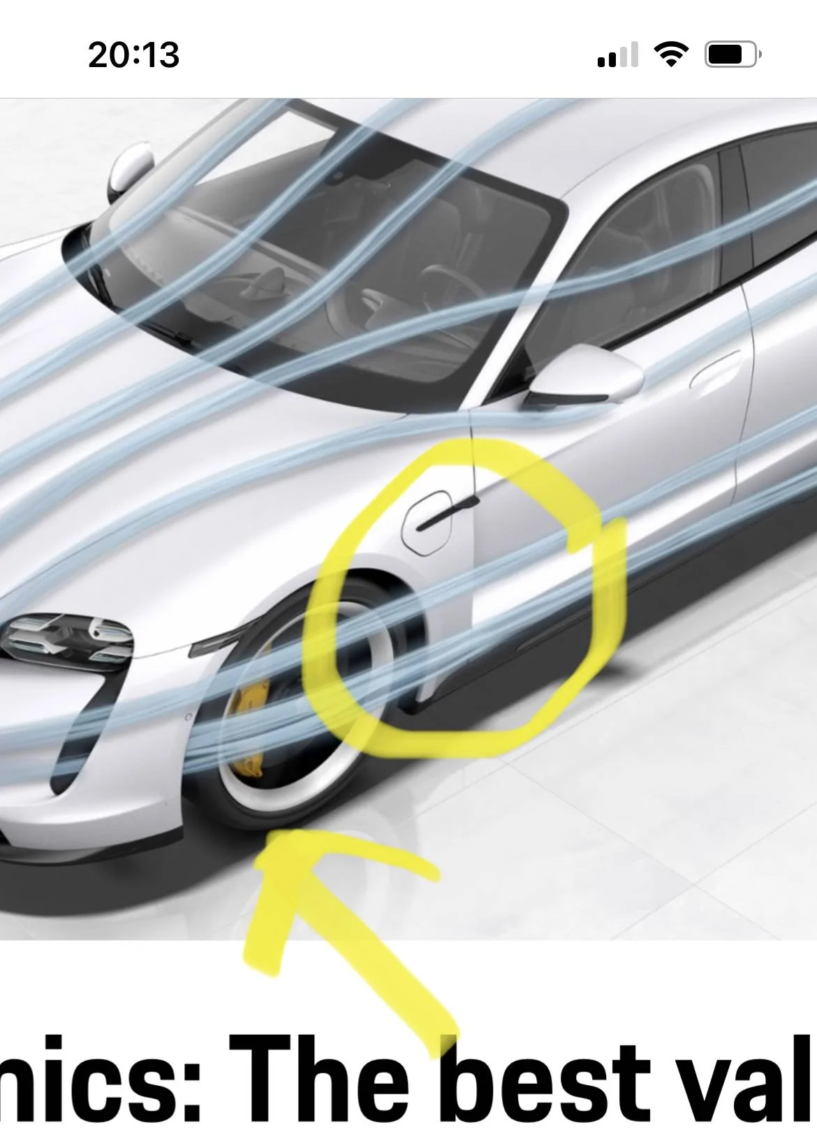

Electric charging cover is not really recommended, having air ducts improve range, track performance and you will have no issues when it gets extremely cold. In fact this option was the primary reason I decided against getting a Turbo S. Watch this:
There is some discussion in another recent thread if the air channels behind the front wheel really do anything for aerodynamics.
I wonder if it will have a major effect on range.
I prefer the look and function of the automatic charge cover. I hope I won’t be sorry the first time I am stuck somewhere with a non functioning cover. Still can cancel this option until next week.
