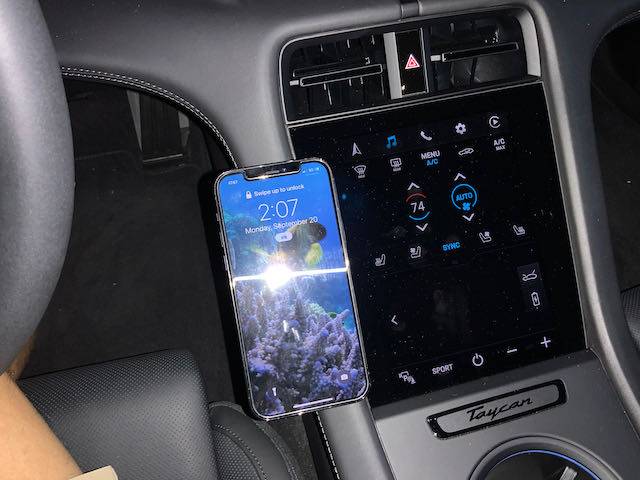

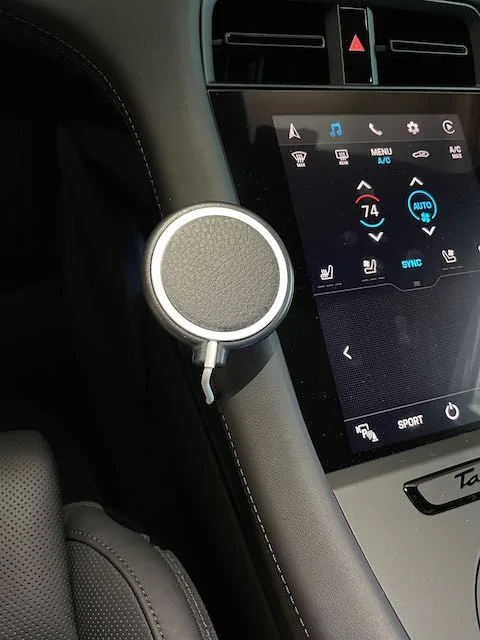

Struggled to find a perfect way to mount my iPhone so decided to custom print my own magnetic holder.
Designed it to match the shape of the center console side, but not too tight in order to avoid marking the leather. Then screwed on the top a magnet from a previous phone holder I had.
Perfect for my needs and been using it for a month without any impact on the leather, and phone holds even in Launch control !
Let me know what you think and would be great to get any additional suggestions. Happy to also share the 3D print file if anyone is interested.

This is a great design. What type of magnet are you using to keep the phone on the holder?

So when you put it on the center console and push up, does the center console get a bit thicker and that is what is holding it in place?

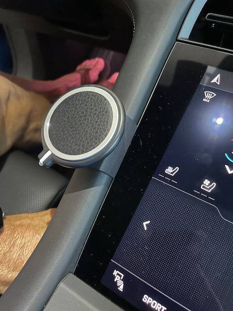

Any of these vents magnets that come with a thin peace of metal that you can put inside your phone cover would work:
https://www.amazon.com/Magnetic-Wiz...ords=hanna+phone+holder&qid=1630863324&sr=8-3
I just dismantled and screwed the magnet to the holder. Next version will be done with integrated grooves for Neodymium magnets inserted into them for minimalist design.

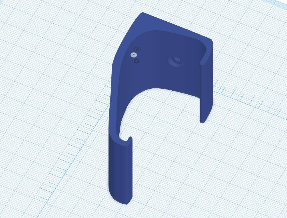

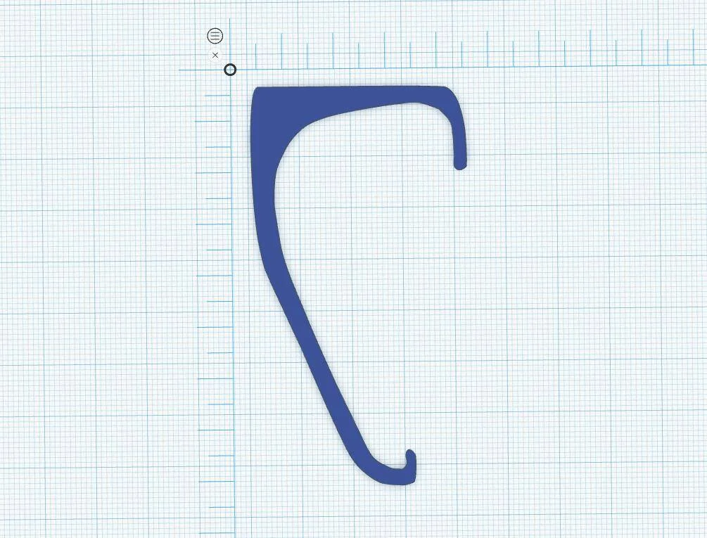

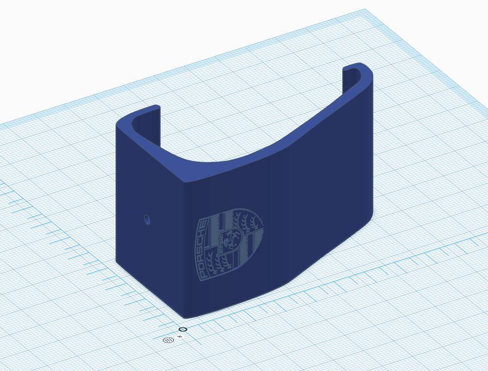

Here are more details on the 3D design where you can see the whole I made to screw the magnet, but could also be glued.
