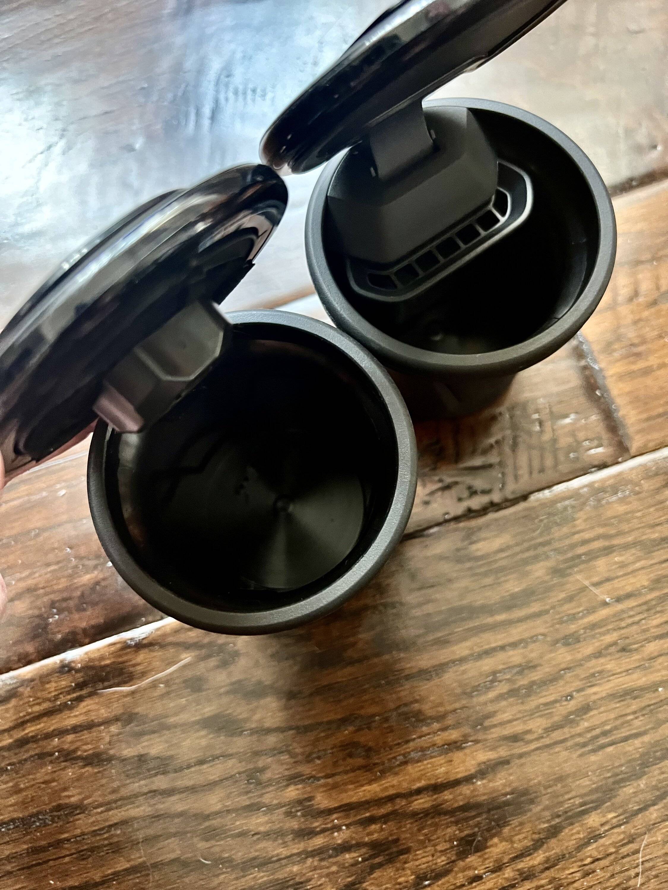

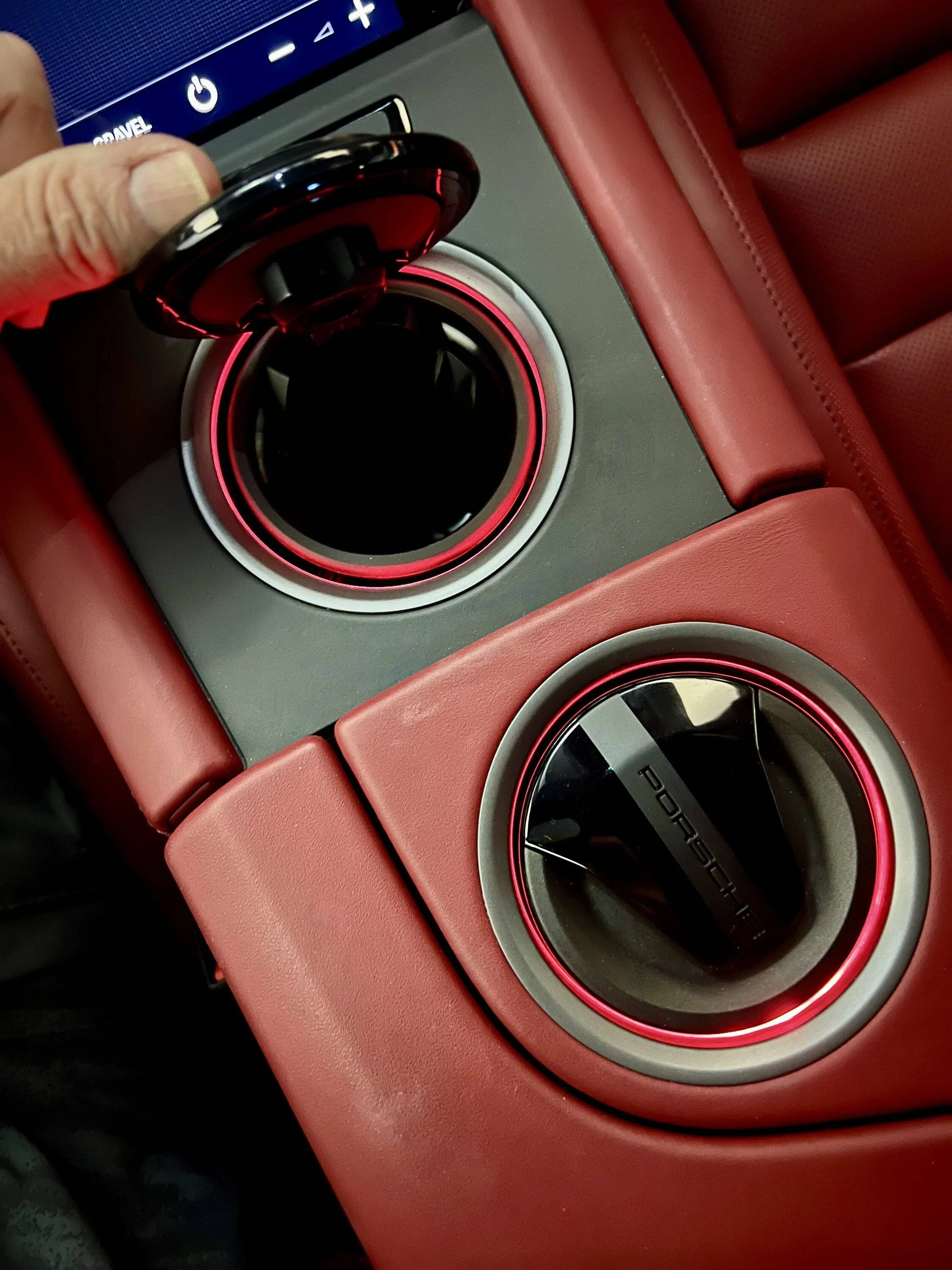

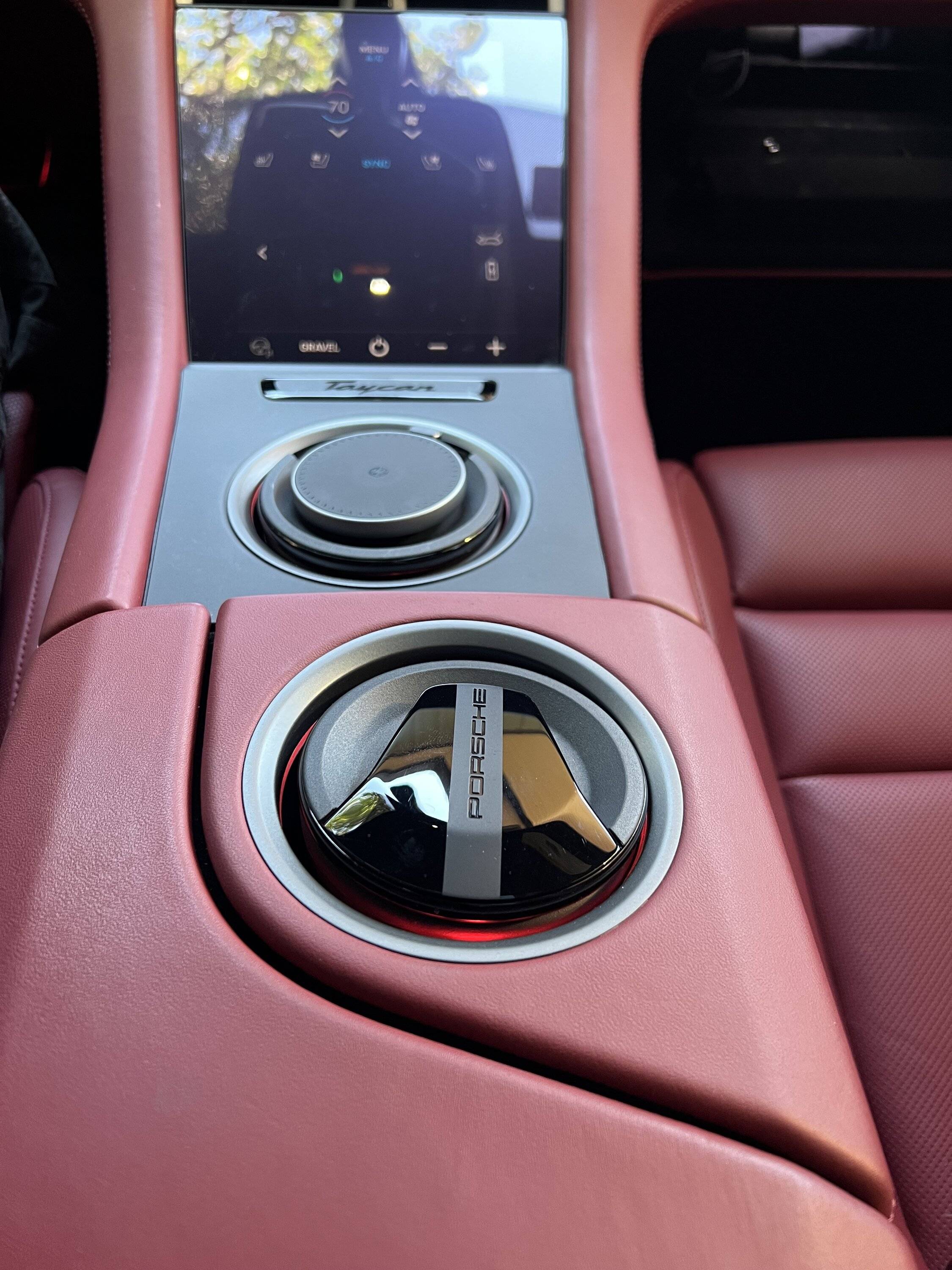

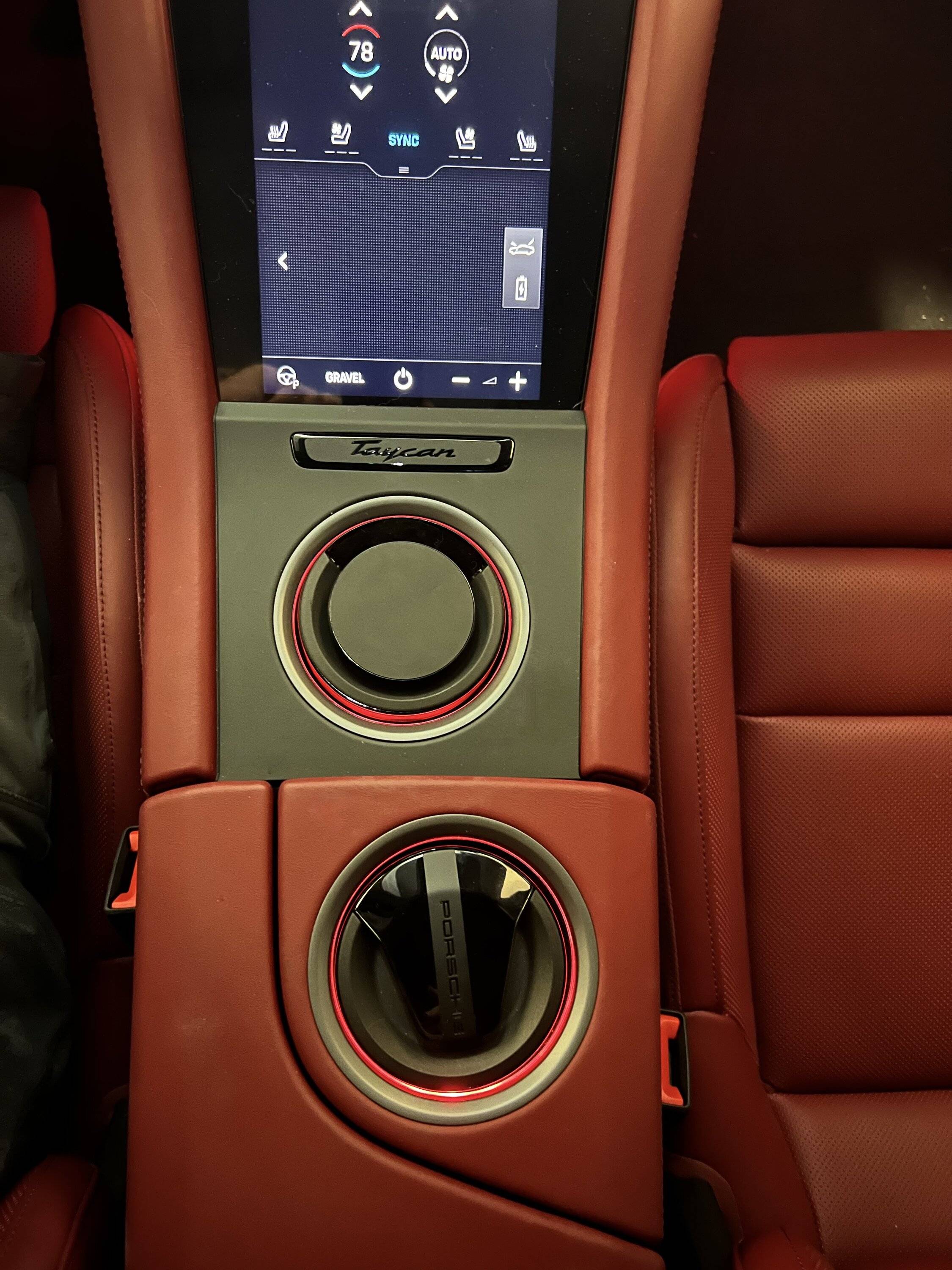

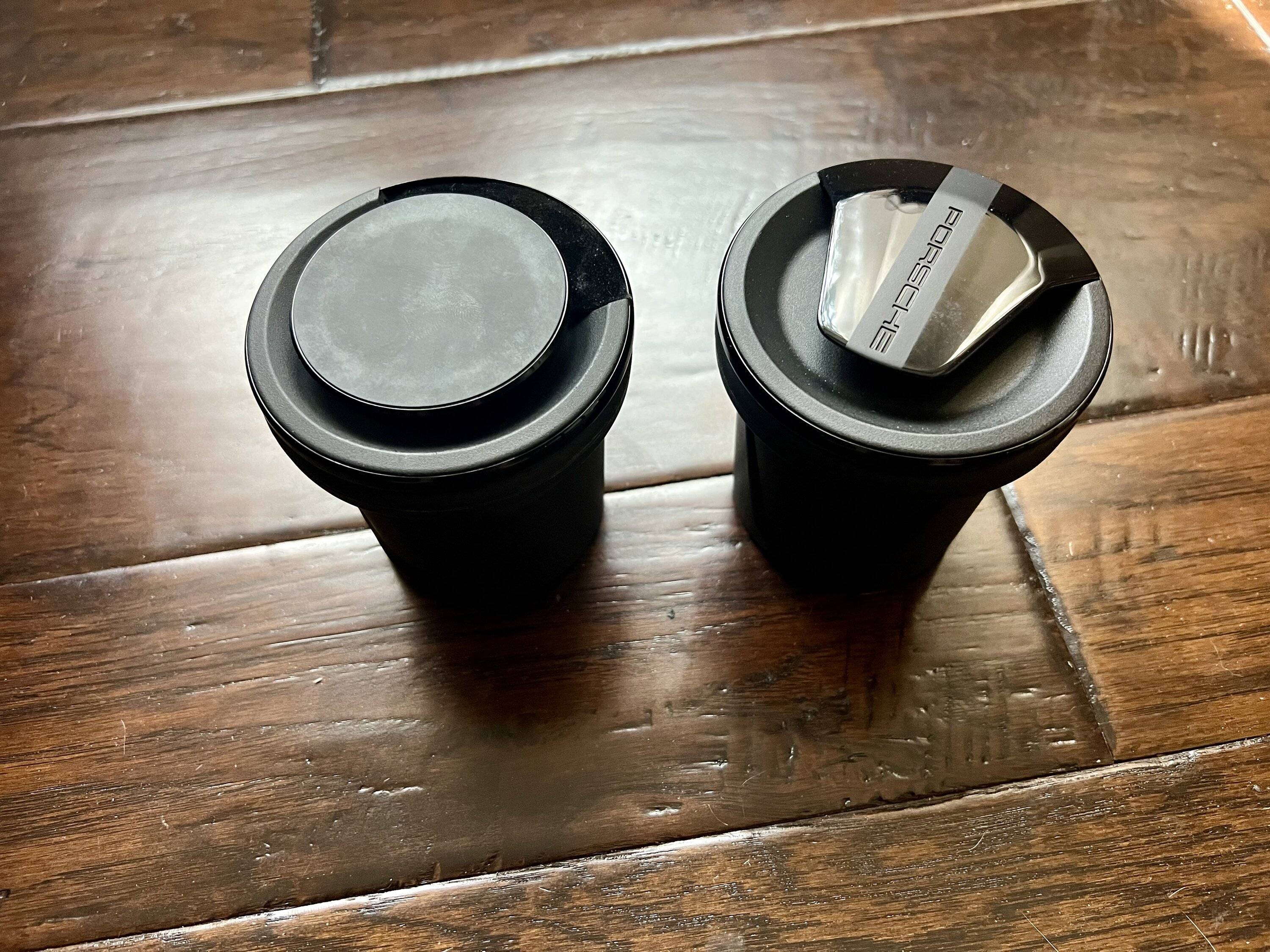

OK - decided on a very different route - I had two Porsche cupholder ashtrays and was really only using one to cover up the cupholder on the armrest which just makes it way more comfortable with your arm there.
Actually forgot I had the spare so decided to chop it up :) and transform it into a magnetic mount for the phone which of course keeps the cupholder light rings visible - seems to work like a charm and still even works as a hinged storage cup - good for keeping other keys out of sight or whatever! Mount cost $14 and even has the matching gloss black surround :)

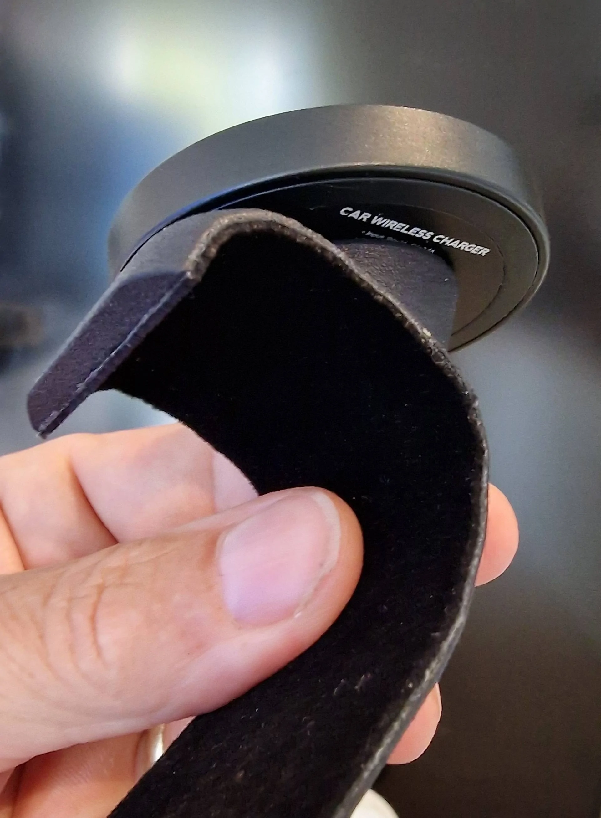

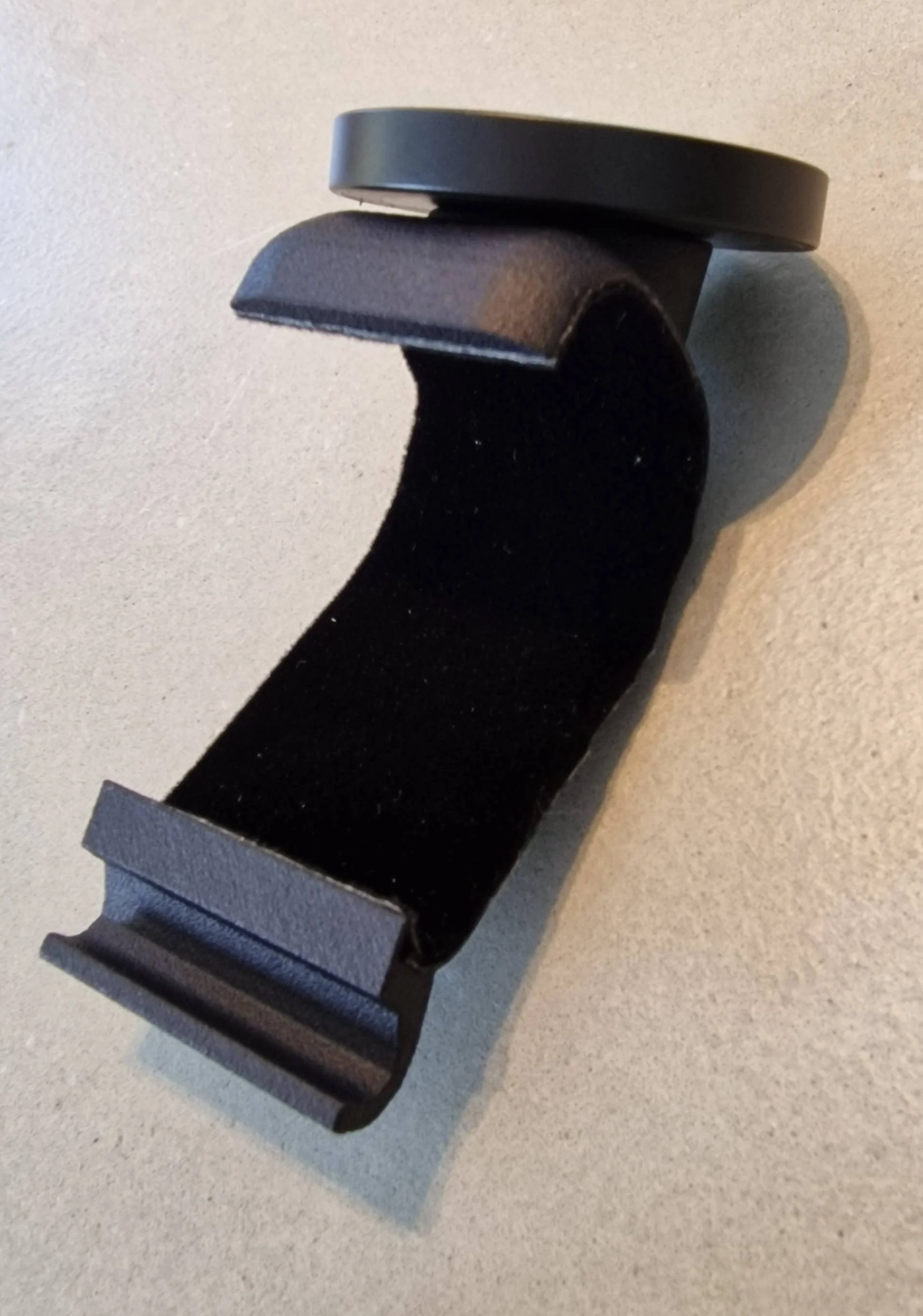

The top end which was the base for the Porsche logo'd cap handle is covered in an Alcantera-like black felt - this just a quick patch but will replace with better (some gaps obvious!) - but actually looks really good, almost OEM!
PICS:
1: Armrest cupholder with OEM ashtray at bottom - top cupholder with my modified OEM ashtray with and mag mount - can easily switch this out for a mag charger if desired but of course more involved if you want to hide the chord completely.

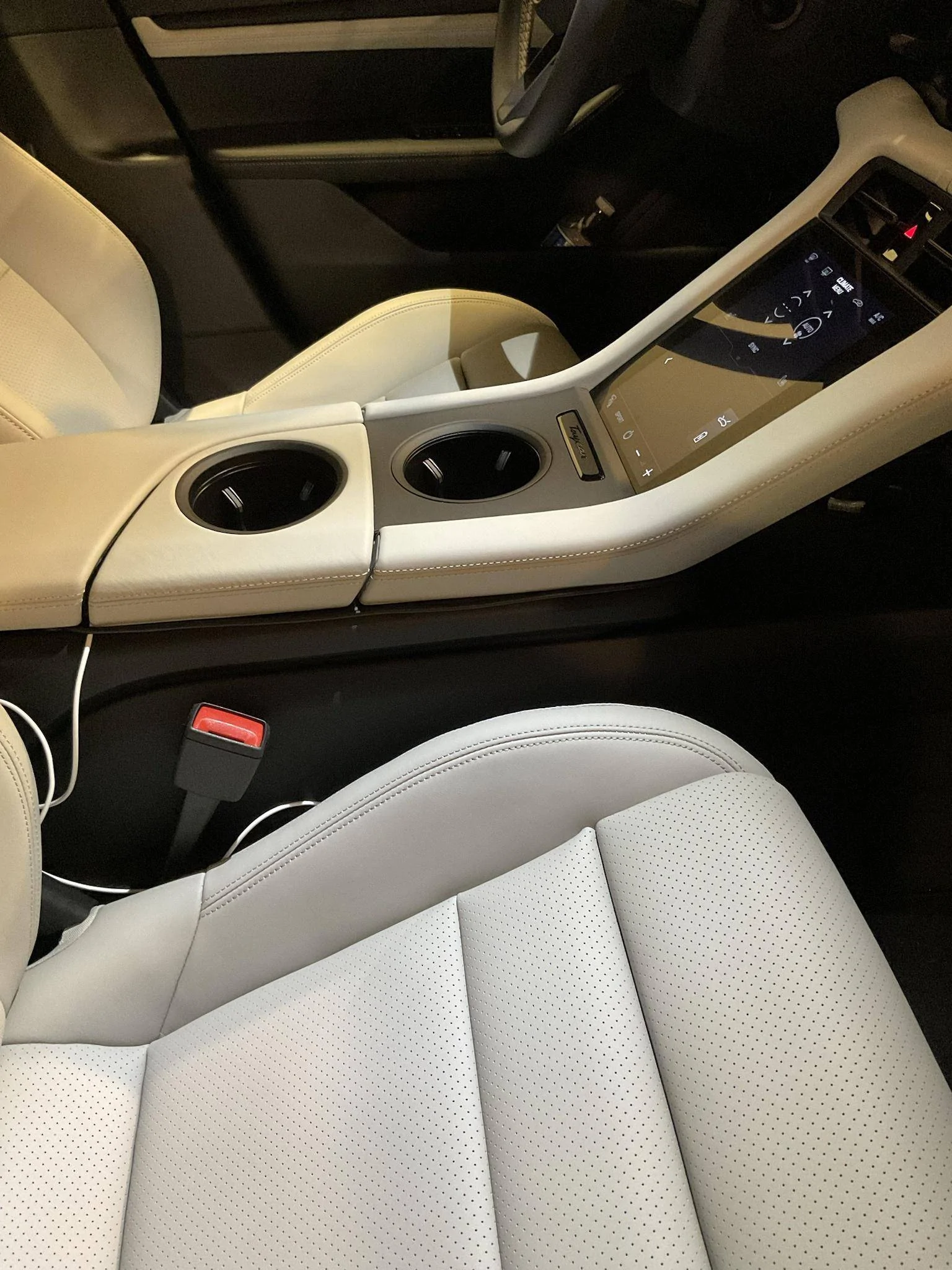

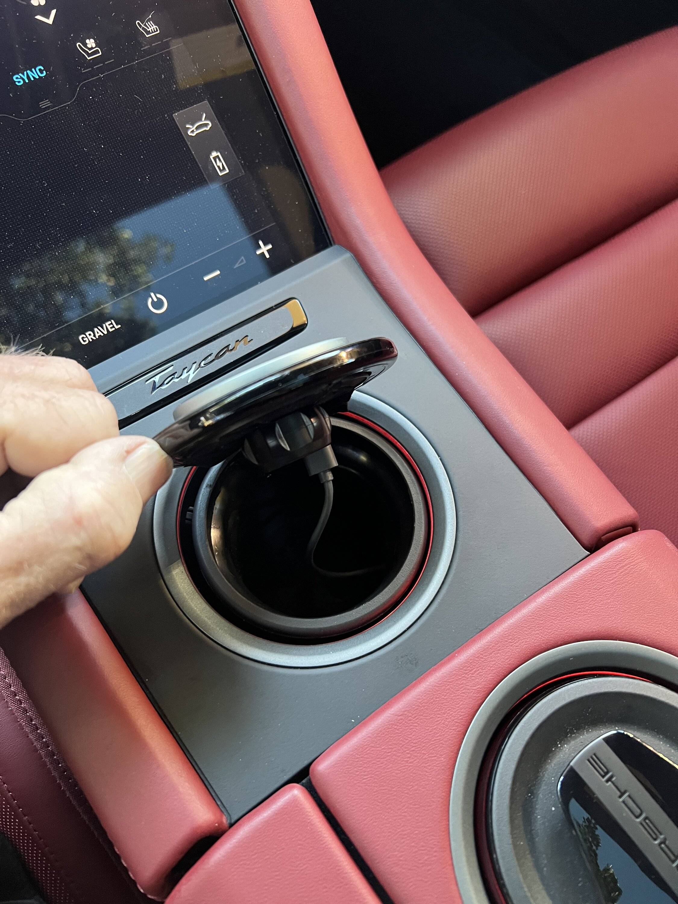

2: I ut out the inner workings of the ashtray and provides ben more sam for keys etc - you can see the twist off locking nut on base of lid that holds the mag mount to the modified lid. All super easy to swap out.
My solution cost me ca $55 (OEM ashtray) + $14 (mag mount) to have this modified Porsche ash tray now storage insert that retains the cupholder lighting - bought my OEM insert back in Nov 2021 - just looked on Suncoast and that same insert is now $65(!!), but still essentially same price as other options here it seems.
This solution is perfect if all you want is a holder (more work to convert to a charger) i.e. I do not interact with my phone whilst driving - others may need to and more upright holders probably preferred. My iPhone 13 Pro sits perfectly edge to edge with the black top of the console :)
The cool thing about this mod is that you are not mucking with any part of your car with clamps etc and of course the cupholder pops right out should you actually need to revert to a cupholder vs a mag mount-storage.
I cleaned out the interior of the ashtray parts to make a full usable storage bin - and the mag mount is simply secured to the lid (via modded hole) with the screw nob it came with i.e. can be swapped out with any other 3rd party mag and/or charger mount.
PIC 1: Porsche's ashtray cupholder right for the Taycan (and other models) - my modded version on left with black mag mount:
Porsche Taycan My 3D printed Taycan phone holder IMG_7029
PIC 2: Interior of ashtray is not usable space other than for ash/cig butts - I cleaned out mine of those parts and now usable storage.
Porsche Taycan My 3D printed Taycan phone holder IMG_7031

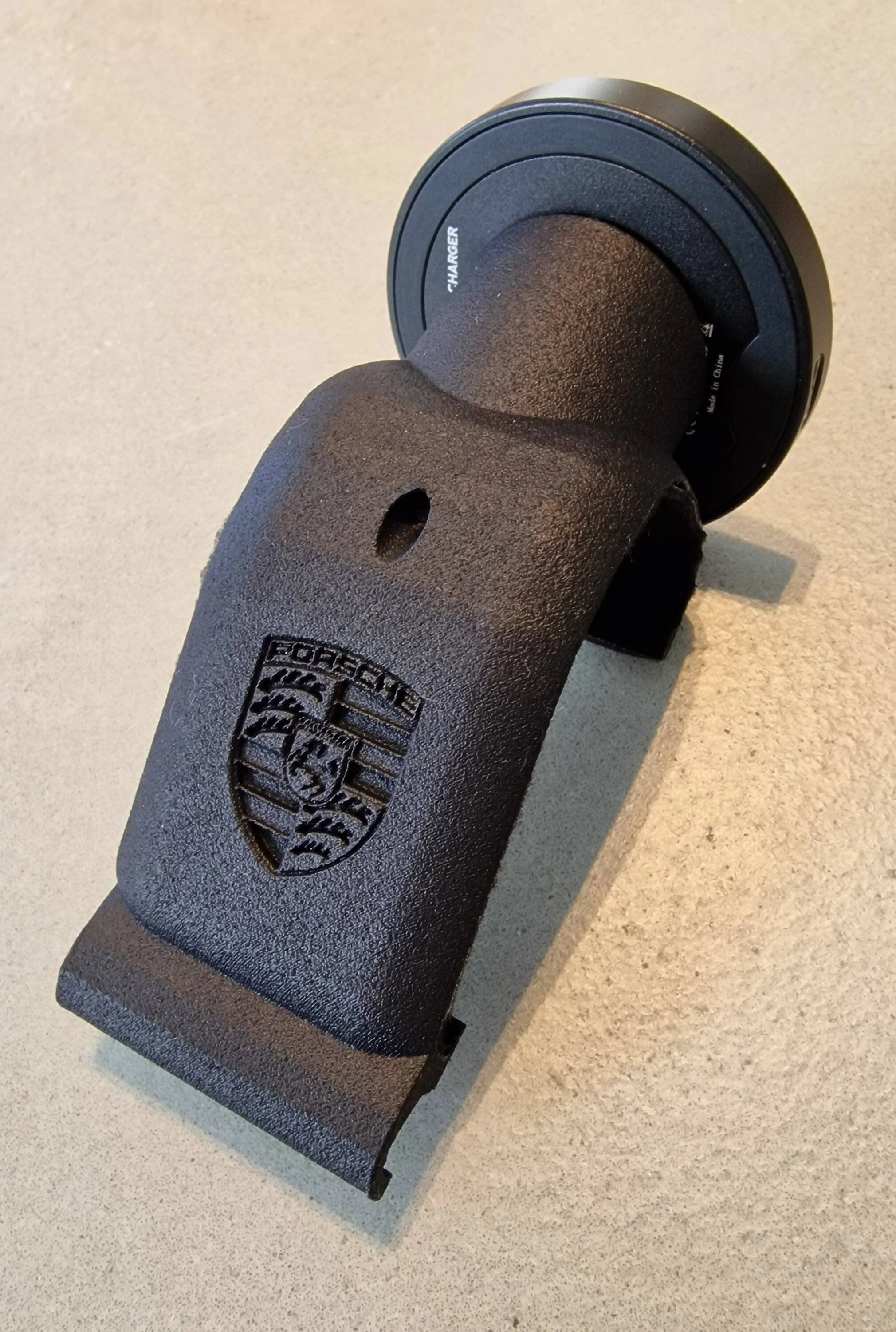

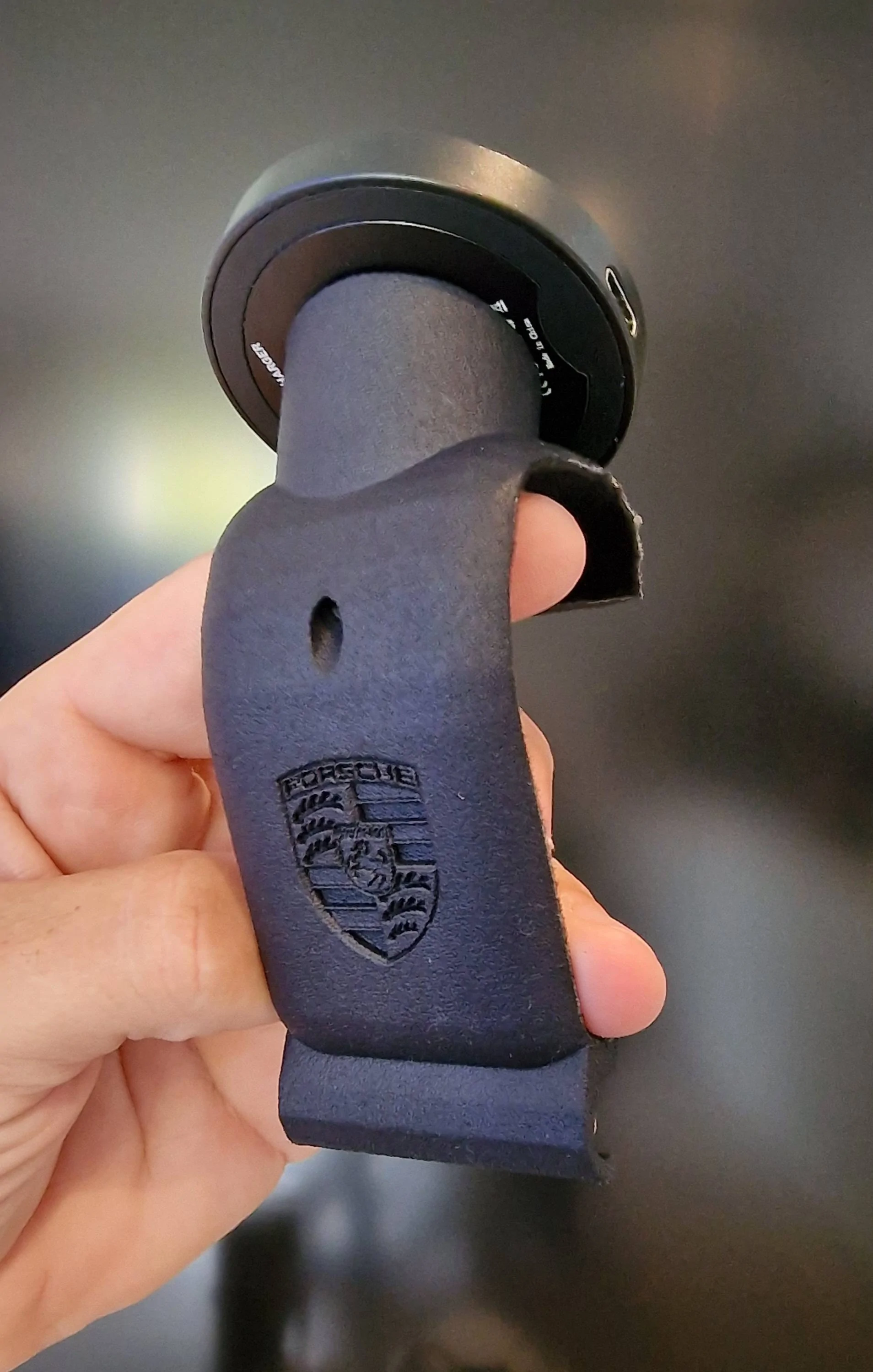

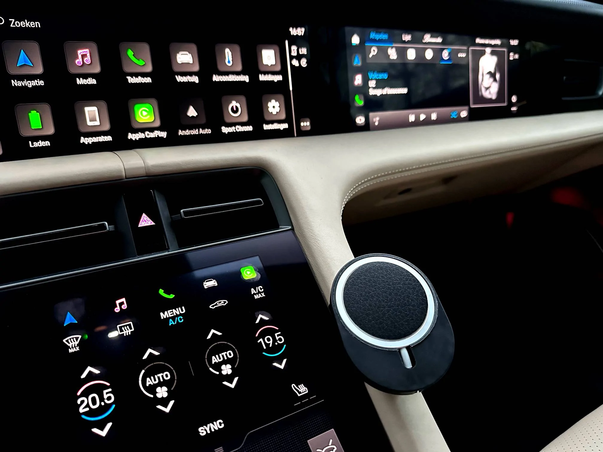

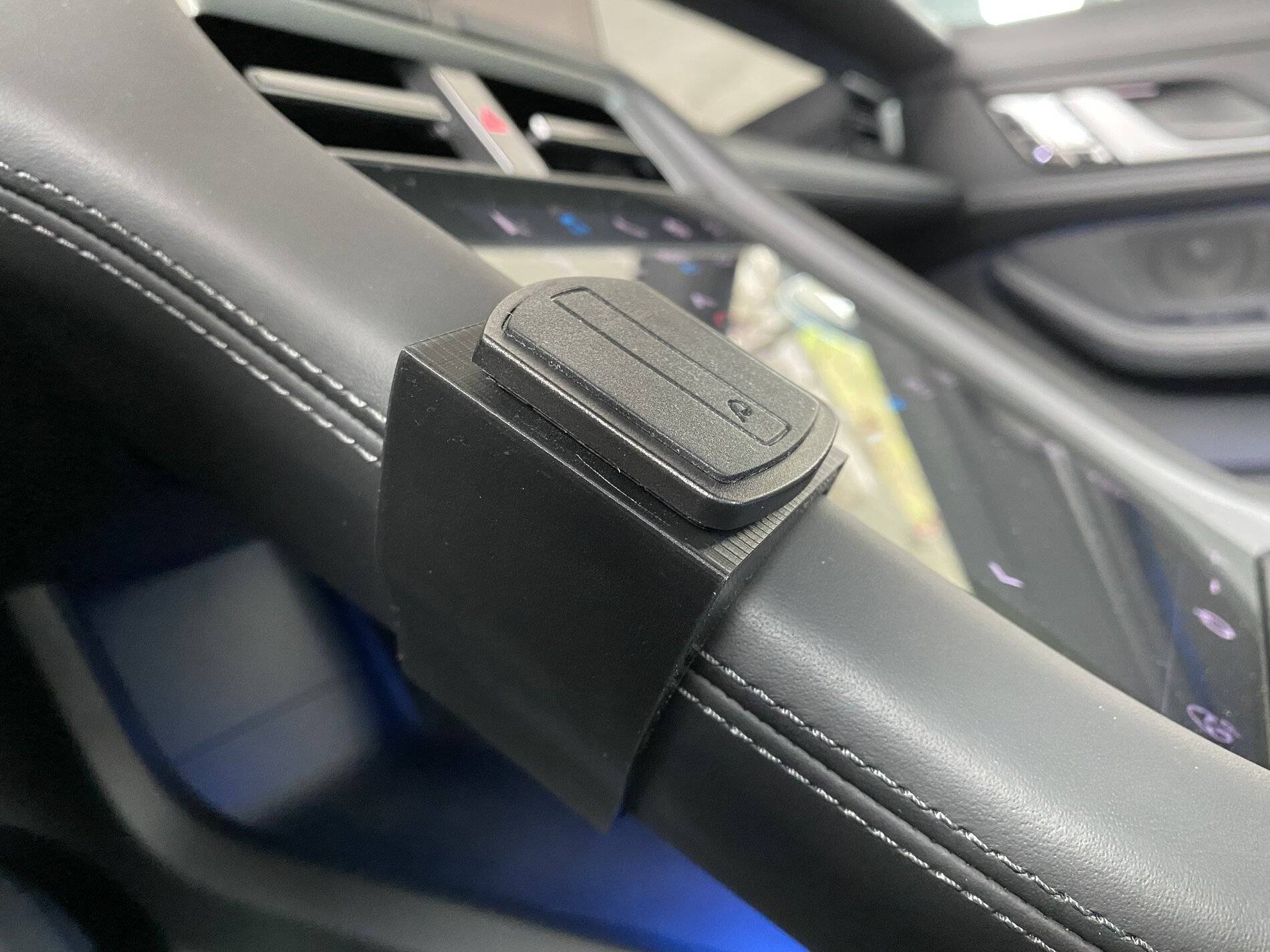

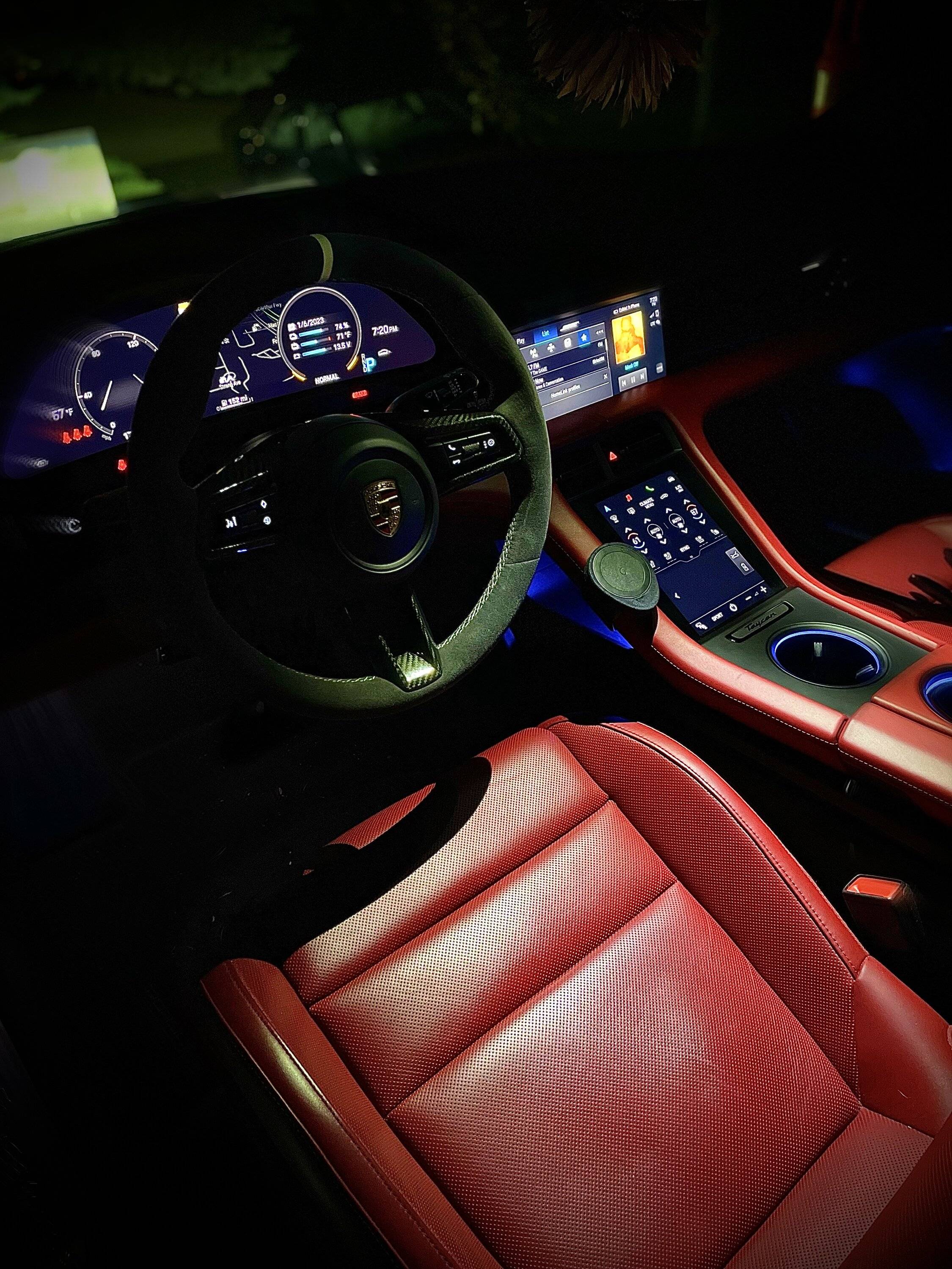

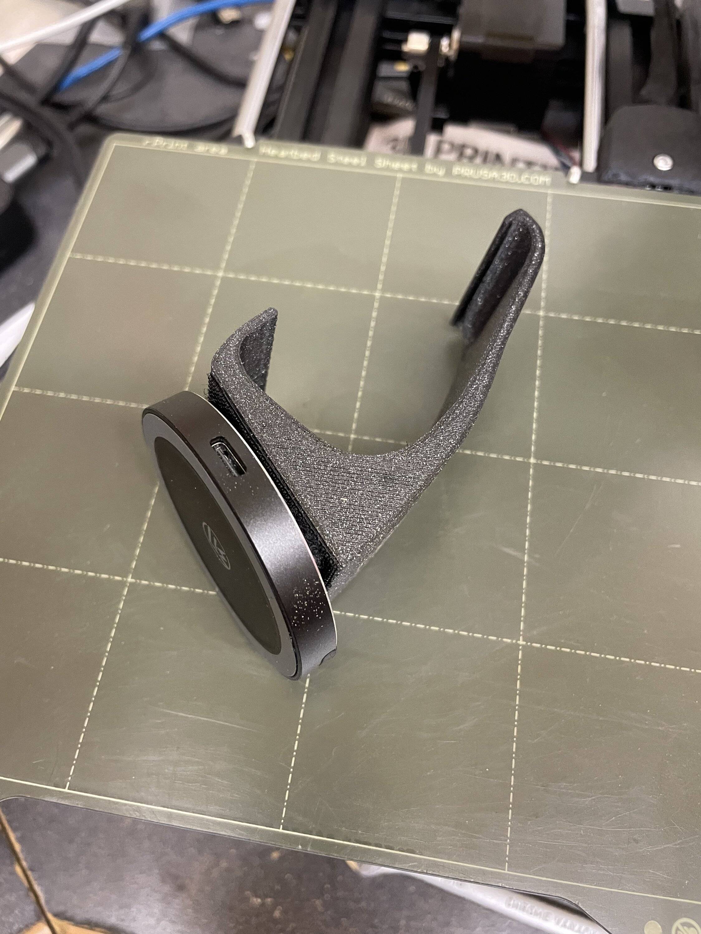

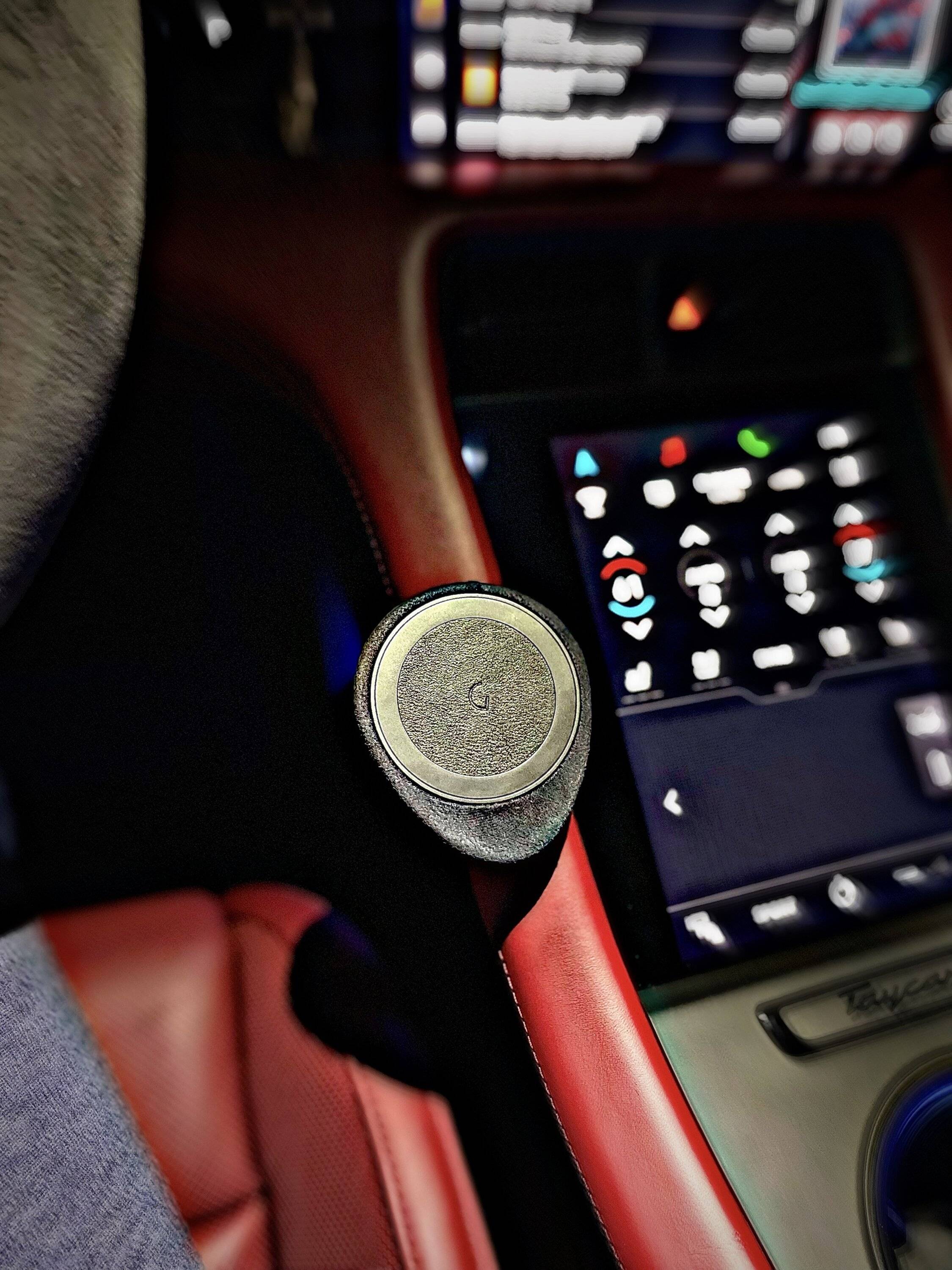

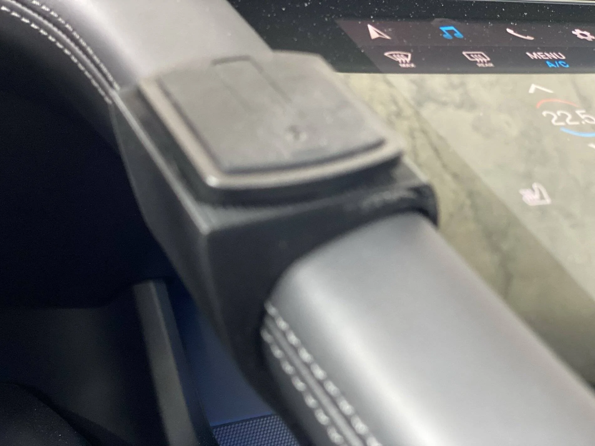

Struggled to find a perfect way to mount my iPhone so decided to custom print my own magnetic holder.
Designed it to match the shape of the center console side, but not too tight in order to avoid marking the leather. Then screwed on the top a magnet from a previous phone holder I had.
Perfect for my needs and been using it for a month without any impact on the leather, and phone holds even in Launch control !
Let me know what you think and would be great to get any additional suggestions. Happy to also share the 3D print file if anyone is interested.

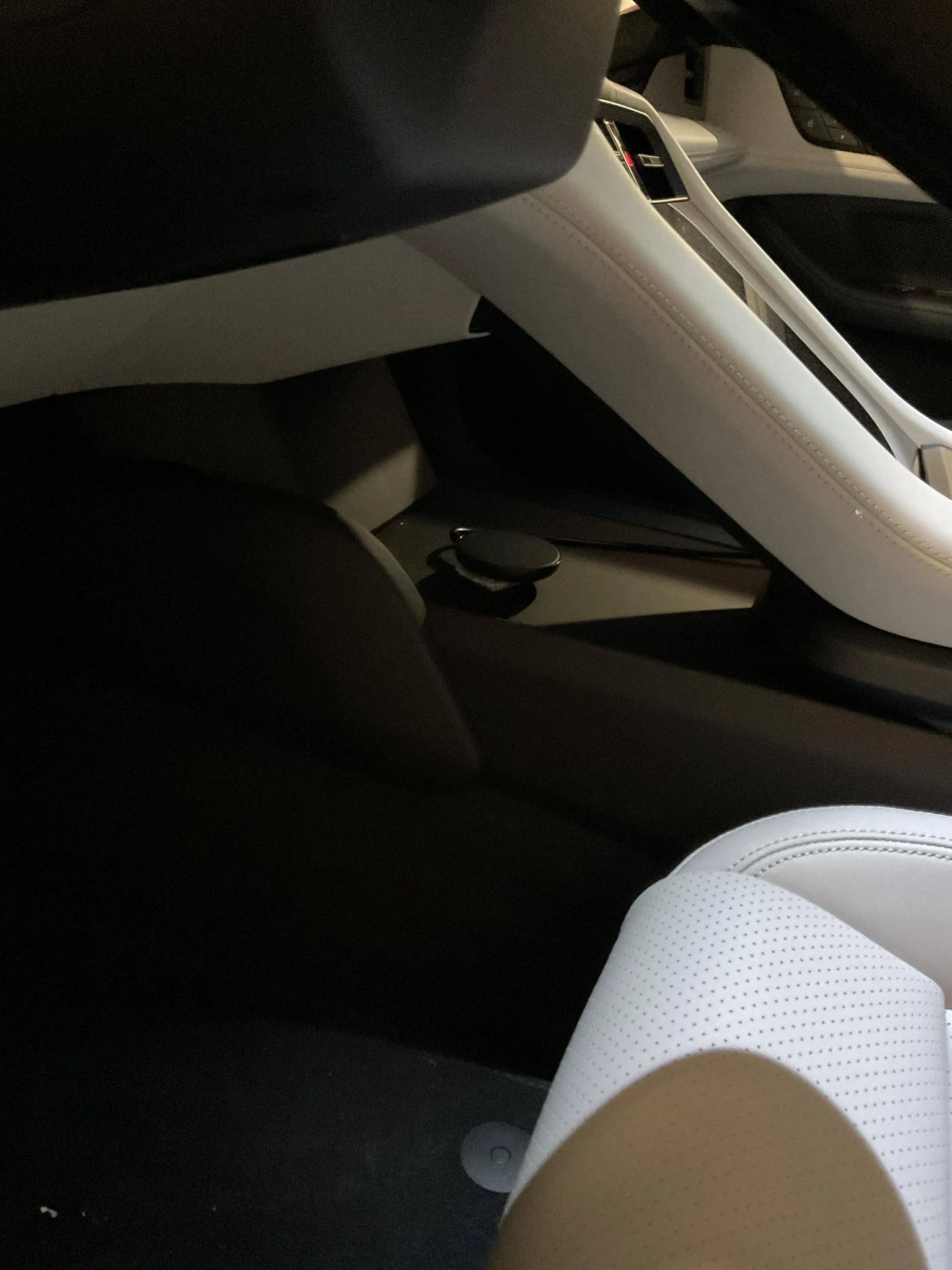

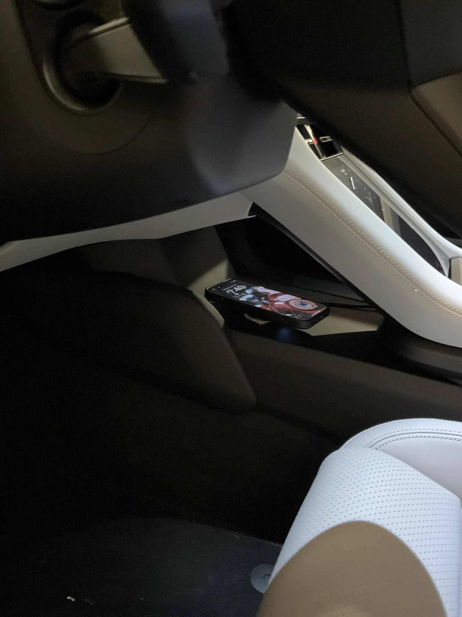

I just double sided taped (for me with velcro tape, but you can use whatever you want) an aftermarket magsafe charger (to allow a 2ft black cable) to the space under / behind the lower screen that was unused.
I don't need to look at my phone when driving, but this way I can still easily place it there to charge, as well as grab it if I need it quickly, since it's magnetic

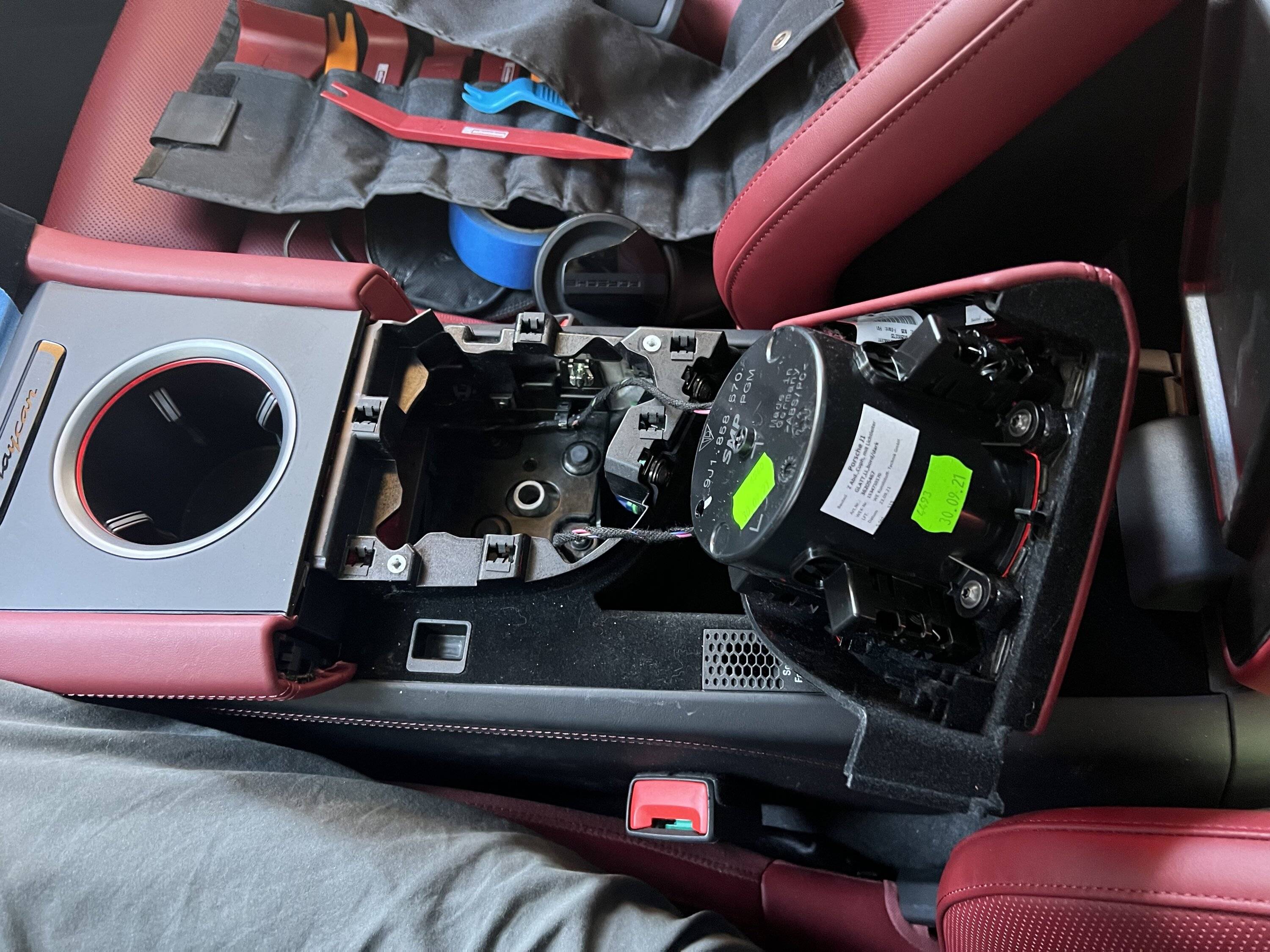

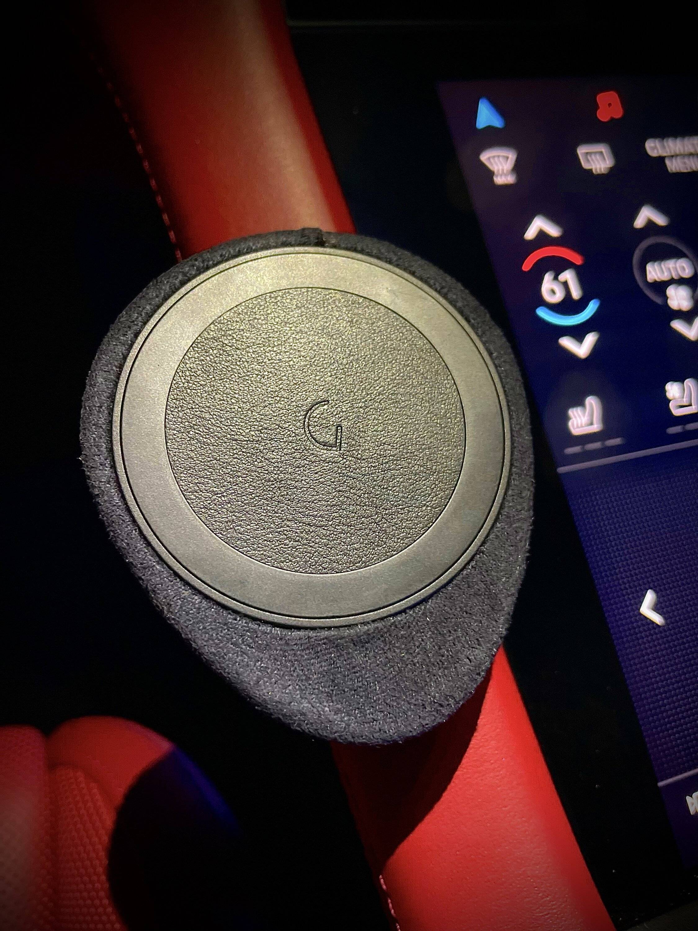

My removable converted ashtray holder now a fully functioning charge pad and storage device with completely hidden usb-c power cord routed back to console hatch.
Finished installed pics - my converted ashtray holder storage for house keys etc:

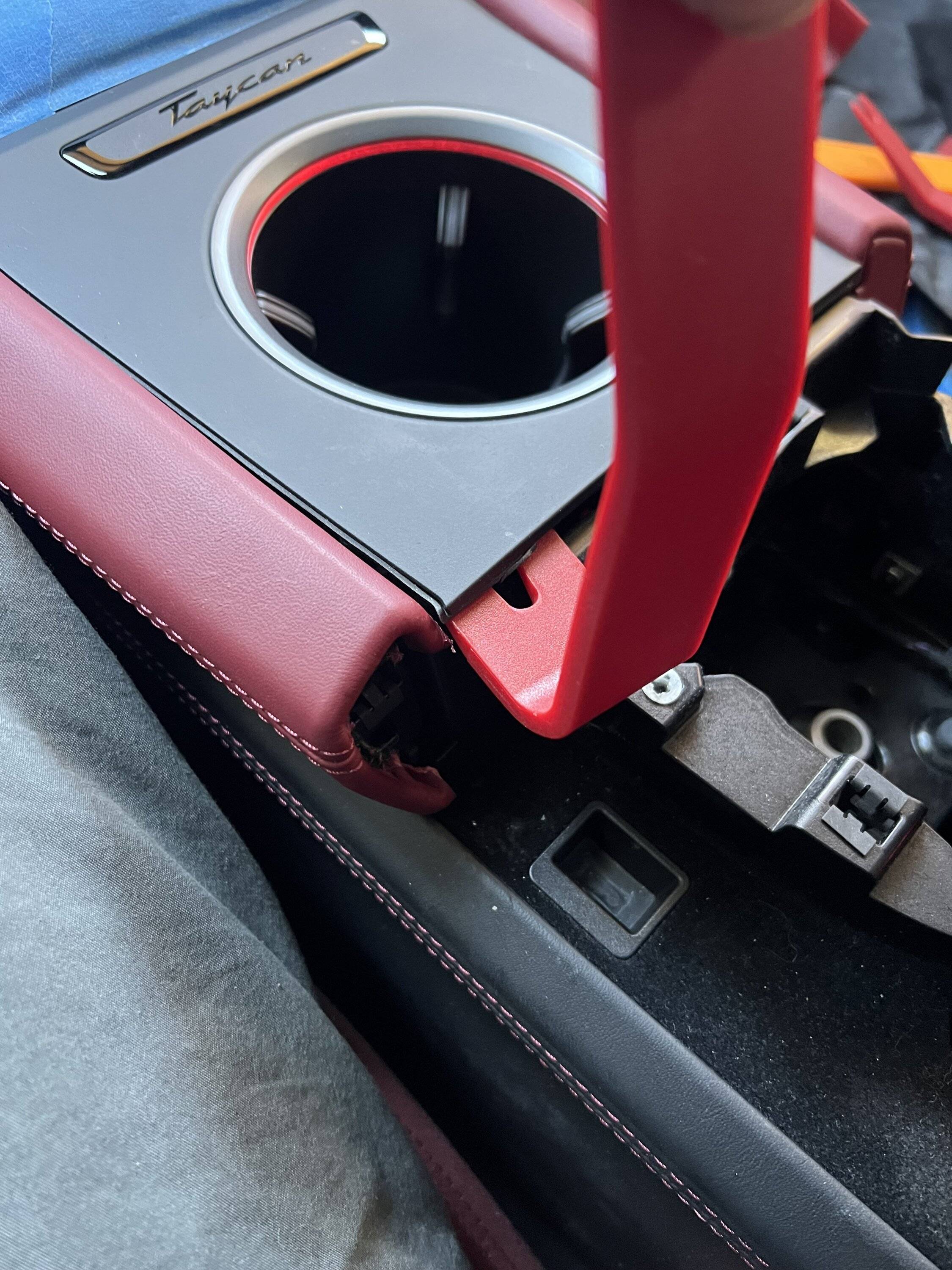

Part 1 - removing the rear cupholder assembly - I actually used a trim/removal tool to pop the first retaining clip on the front cup holder with far less effort than using thumbs/fingers as suggested elsewhere.
Porsche Taycan My 3D printed Taycan phone holder IMG_0172
Porsche Taycan My 3D printed Taycan phone holder IMG_0176

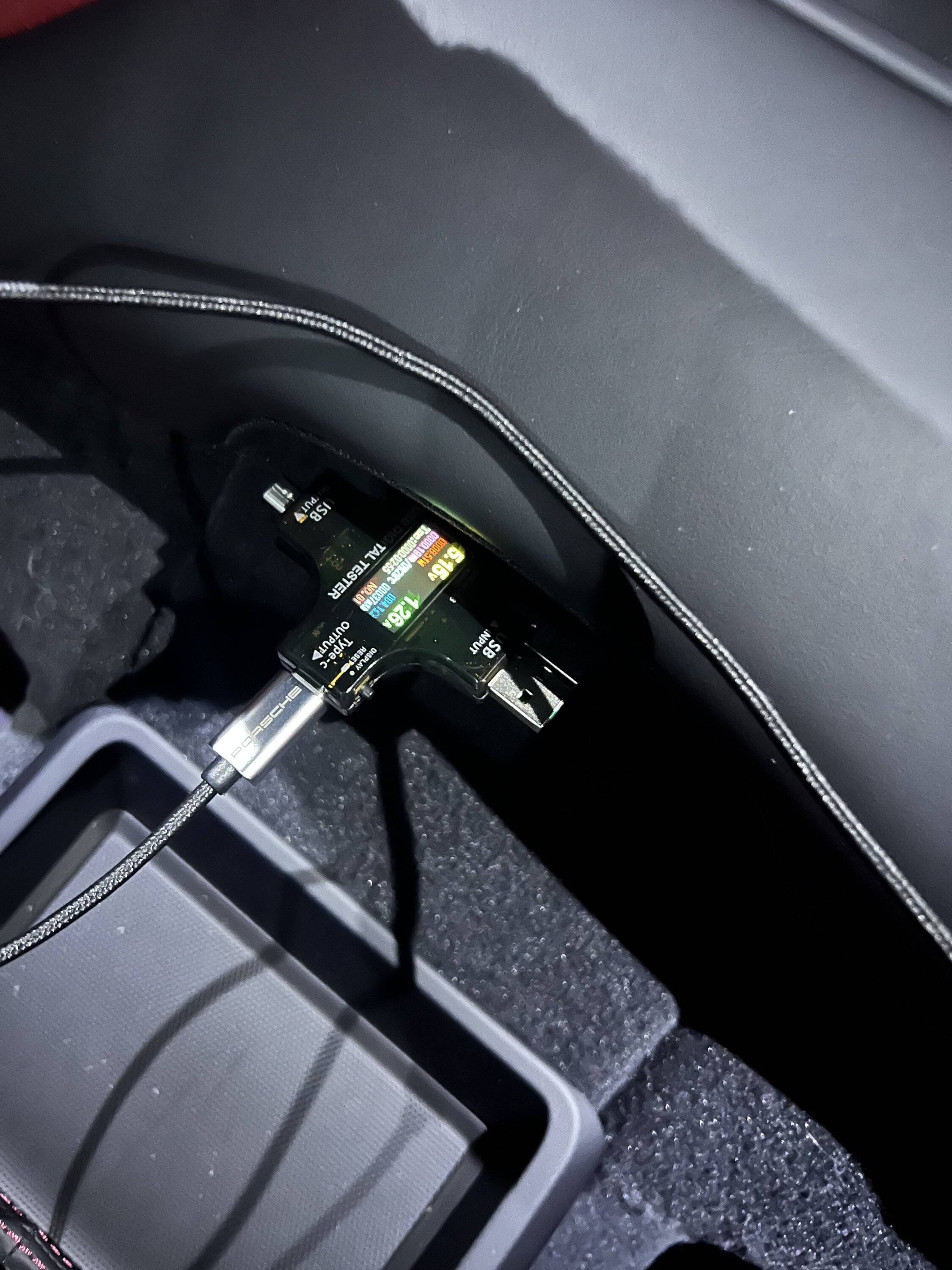

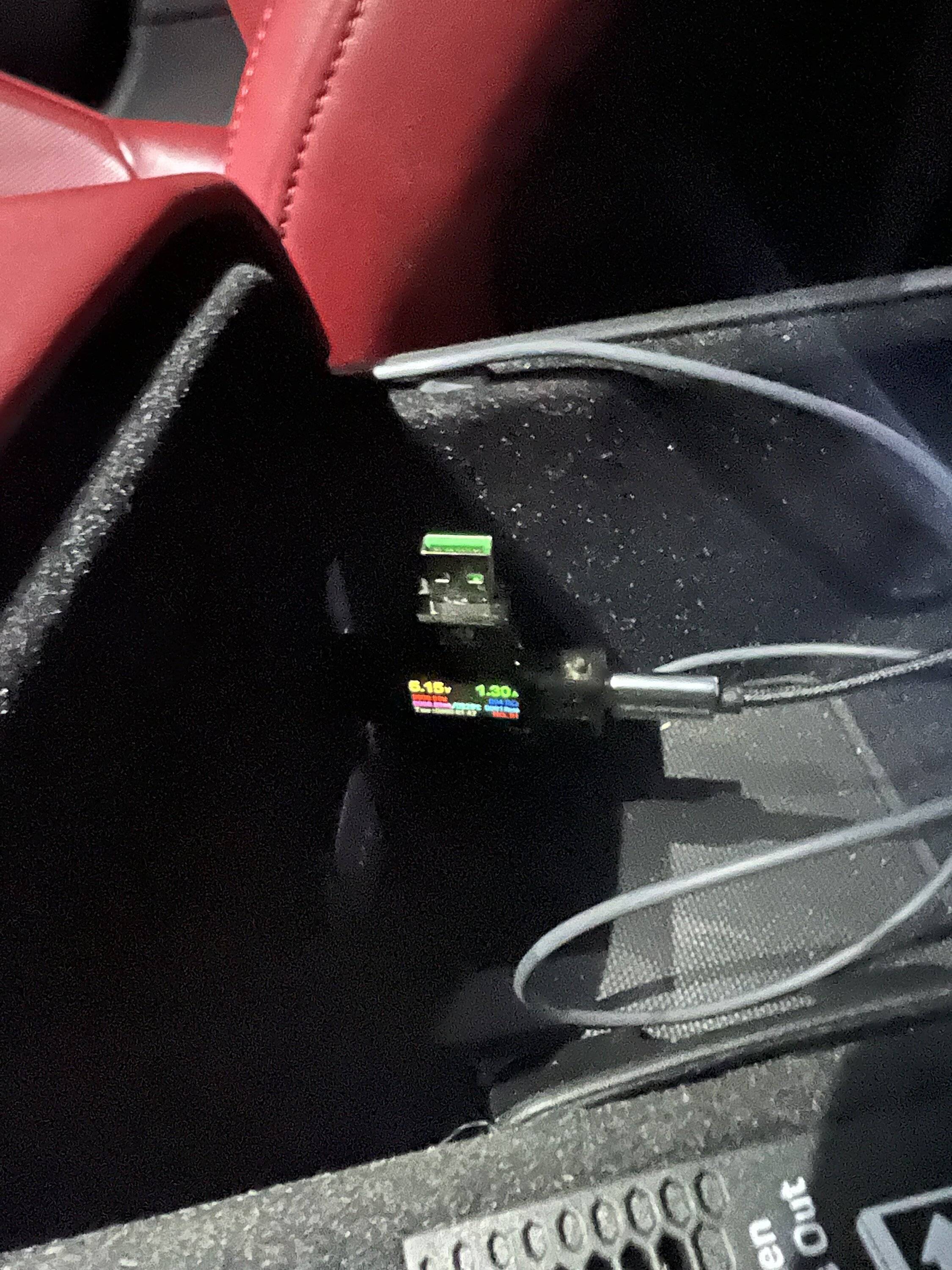

OK - results are in :)
Want ahead and tested the voltage and amperage from the rear (specifically the fast ) charging USB-C plugs and compared to the USB-C slots in the cubby of the console .
Bottomline is they are essentially identical which TBH surprised me! So yes the console multi-function ports appear to offer the same level of change capability as the rear dedicated charging ports.
Voltage/amperage fluctuates for example between having the iPhone awake vs asleep and even then to some degree in either state.
It is true that the highest amperage I briefly saw was in the rear at ca 1.5 A but the front reach 1.4+A too. Voltages from front and rear are essentially the same and varied from 5.15 to 5.19 averaging about 5.17 v.
Some pics (obviously with iPhone active) - when put to sleep mode the voltage and amperages decrease in both sets of ports.
Here is an example from one of the front console usb-c ports again with iPhone attached, charging and awake

And here is an example again with iPhone attached, charging and awake from the rear seat charging usb-c port:
Porsche Taycan My 3D printed Taycan phone holder IMG_0192
