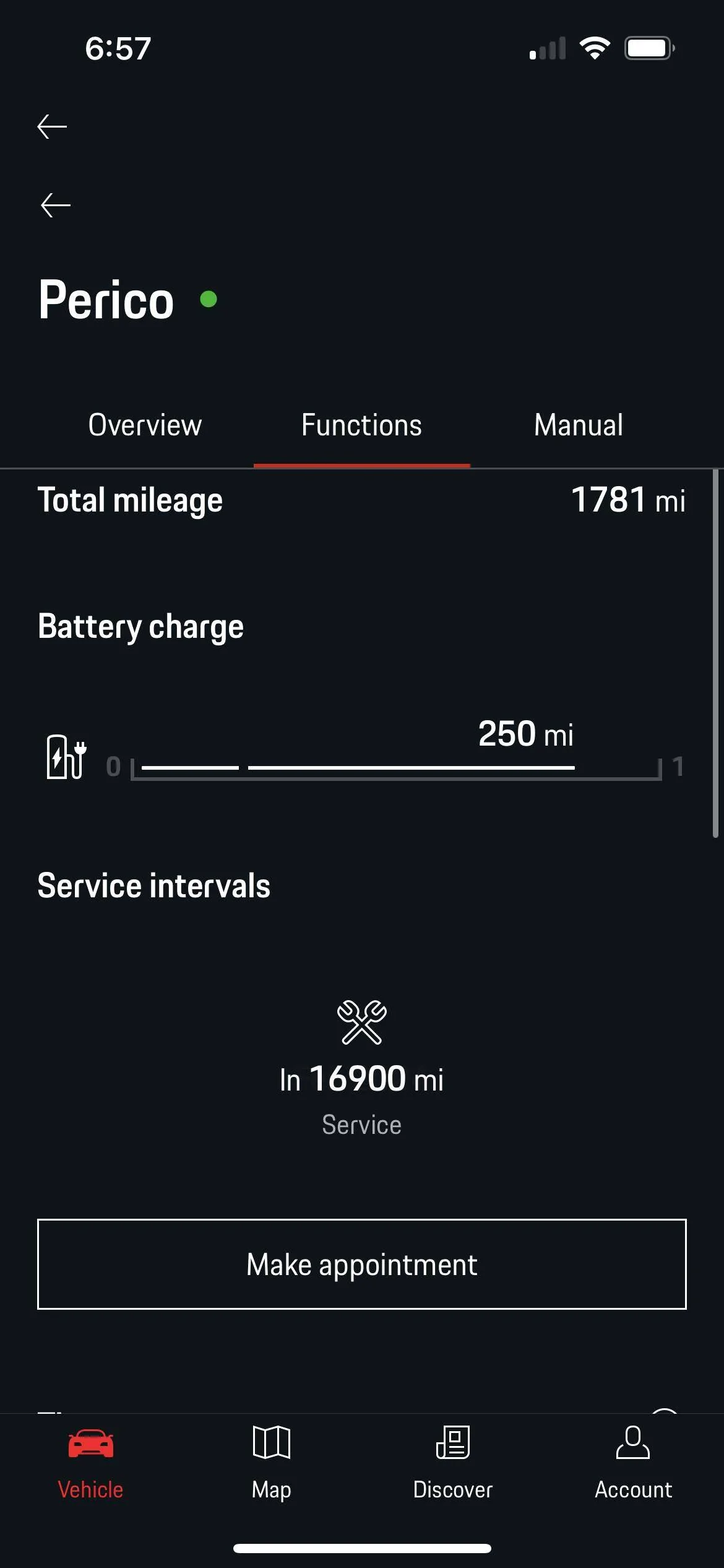

Found this yesterday when trying to access my pre-conditioning timer. The “Functions” section of the app does not work.
I had the uPdate finalized last week and this functionality worked at that time.
As you can see from the picture, I have clicked the “Functions” tab but the screen does not change from “Overview”. I’ve quit the app and restarted multiple times and no change.
Anyone else have this issue?

Try uninstalling/reinstalling?
I don't currently see this issue, FWIW.

I experienced the same issue yesterday after my uPdate. functions and owners manual not working. they told me maybe it was IOS6 update and to wait a few weeks but I don’t think that is the issue.

Good point, I did update to iOS 16 a couple days ago. But that shouldn’t affect the in-app functionality like that.
I tried uninstall and re-install and no luck. And the my.Porsche website doesn’t seem to want to connect the vehicle.
Porsche needs to real help with their software. This is unacceptable for a car that’s been out for 3 years.

Just swipe the whole screen over to it then it works. Clicking the button doesn't.
:surprised: That works... thank you!

Reported issue and got this :
Thank you for contacting Porsche Cars Great Britain Limited.
Porsche AG have advised us that there is a glitch with the current app version that selecting the tabs is currently not working. You can however still swipe left or right on the app to access these tabs.
This is planned to be resolved in the next MyPorsche app release.
