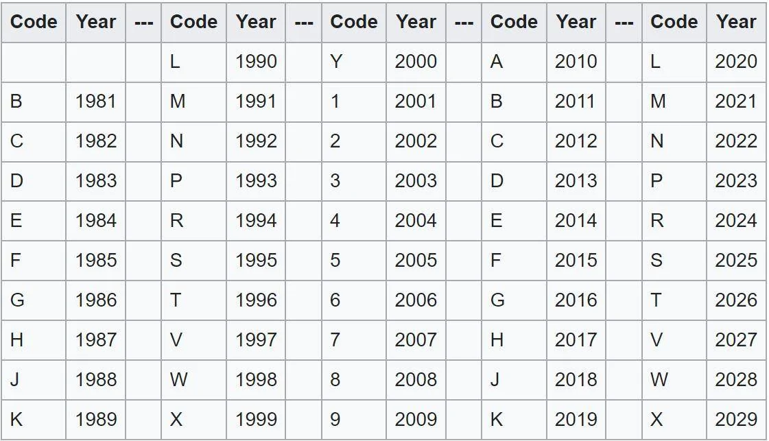

As "P" was the identifier (10th digit in the VIN), will "Q" be the identifier for MY24? Anyone know?
CroquetMan Member Joined Dec 3, 2021 Threads 6 Messages 23 Reaction score 5 Location South West Vehicles Taycan 4S May 15, 2023 Thread starter #1 As "P" was the identifier (10th digit in the VIN), will "Q" be the identifier for MY24? Anyone know? Sponsored
Taycian Member First Name Ian Joined May 3, 2021 Threads 0 Messages 8 Reaction score 4 Location UK Vehicles Taycan 4S CT May 16, 2023 #2 MY24 will be R. There is no Q.
OP OP CroquetMan Member Joined Dec 3, 2021 Threads 6 Messages 23 Reaction score 5 Location South West Vehicles Taycan 4S May 16, 2023 Thread starter #3 Taycian said: MY24 will be R. There is no Q. Click to expand... Thank you - much obliged! Sponsored
