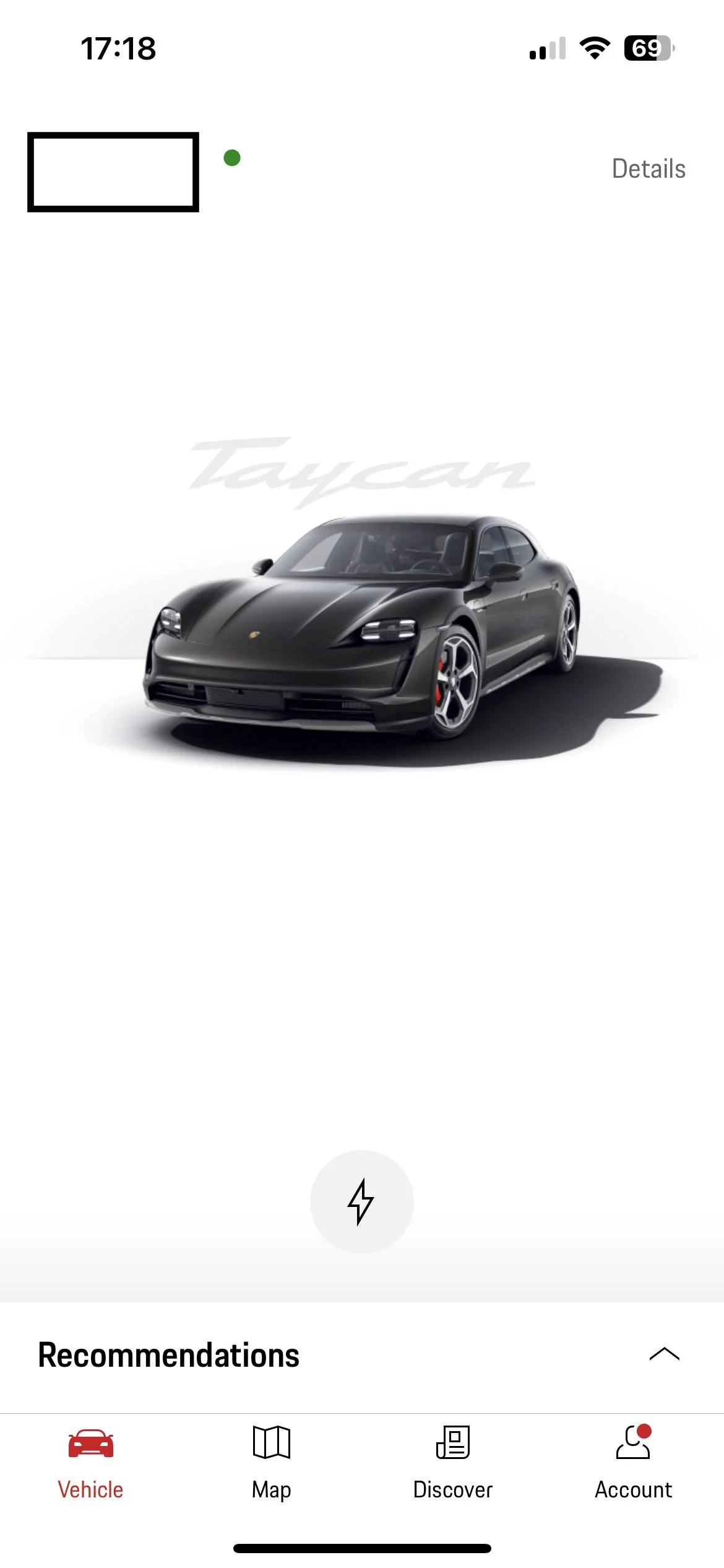

Hi
I've just had my car back from having it's heater fixed and they also did 2 campaigns - WNK7 and WNV0. WNK7 is to do with the antenna i believe, not sure about the other one.
Anyway, I seem to have lost all connectivity with myporsche app/website. I can't see anything to do with charging or tyre pressures or the the tracker etc. However it does have the green 'ready' dot showing in the app which implies the app/car are speaking to each other. Green sos light in the car too.
2 finger reset hasn't done anything and it isn't in privacy mode.
Any thoughts?

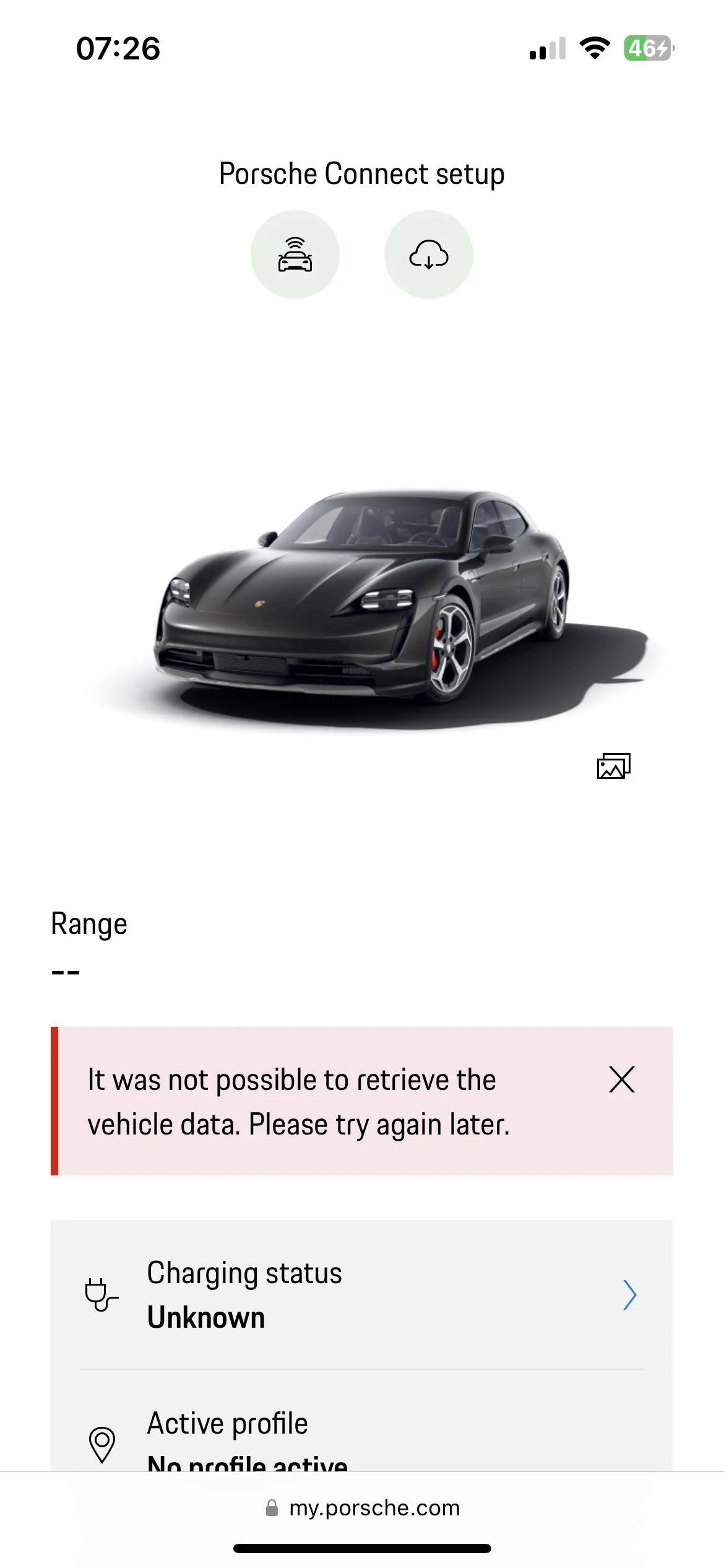

Adding another data point to this issue.
I'm also having similar connection issues. The My Porsche app and website has been working fine until this morning when I tried to remotely heat the cabin via the app. I've never had any issues with heating or any recall/campaigns done on my Taycan GTS, literally just happened today out of the blue.
The My Porsche app is showing a red dot (no connection) unfortunately - the website is also unable to connect to my Taycan. No mentioning of privacy mode, neither in the app nor the PCM. The "2 finger" engineering reset didn't work either. Green SOS light in the car and I'm seeing the LTE icon on the side.
I'm a bit hesitant to disconnect by 12V battery because I'm going to be traveling for the next few weeks and would really not want to deal with another issue in case that goes wrong. I'll give PCNA a call tomorrow and see what they say.

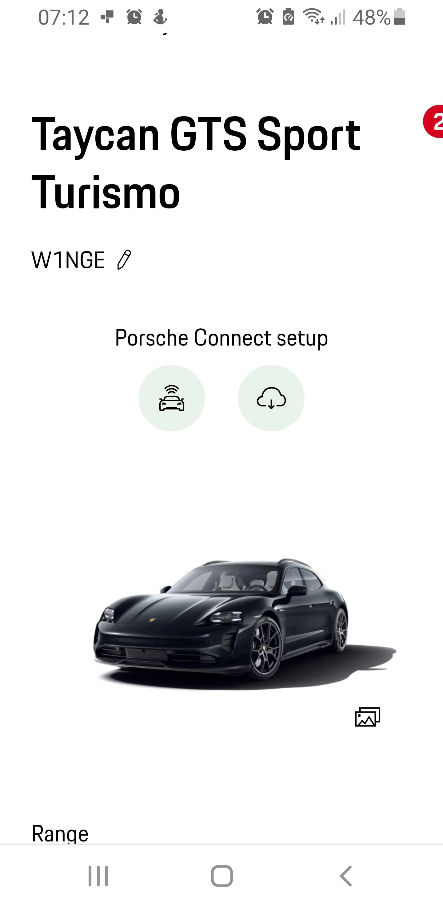

Are online services active in My Porsche website - Porsche Connect Services? Two green icons.
Don't think it is a series issue - I had connectivity yesterday.
Yes they are green. But still not working after loging back in to car this morning.
oddly/coincidentally I had an email from smart mobility overnight telling me they couldn’t renew some of my connect services overnight (coming up to car birthday) and to log in and pay again. Taking my money seemed to work ok but app still dead.
You might want to check that the heater and precool/heat functions are still working without an error. See this post.
