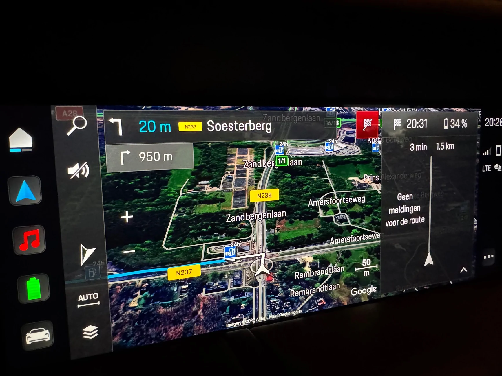

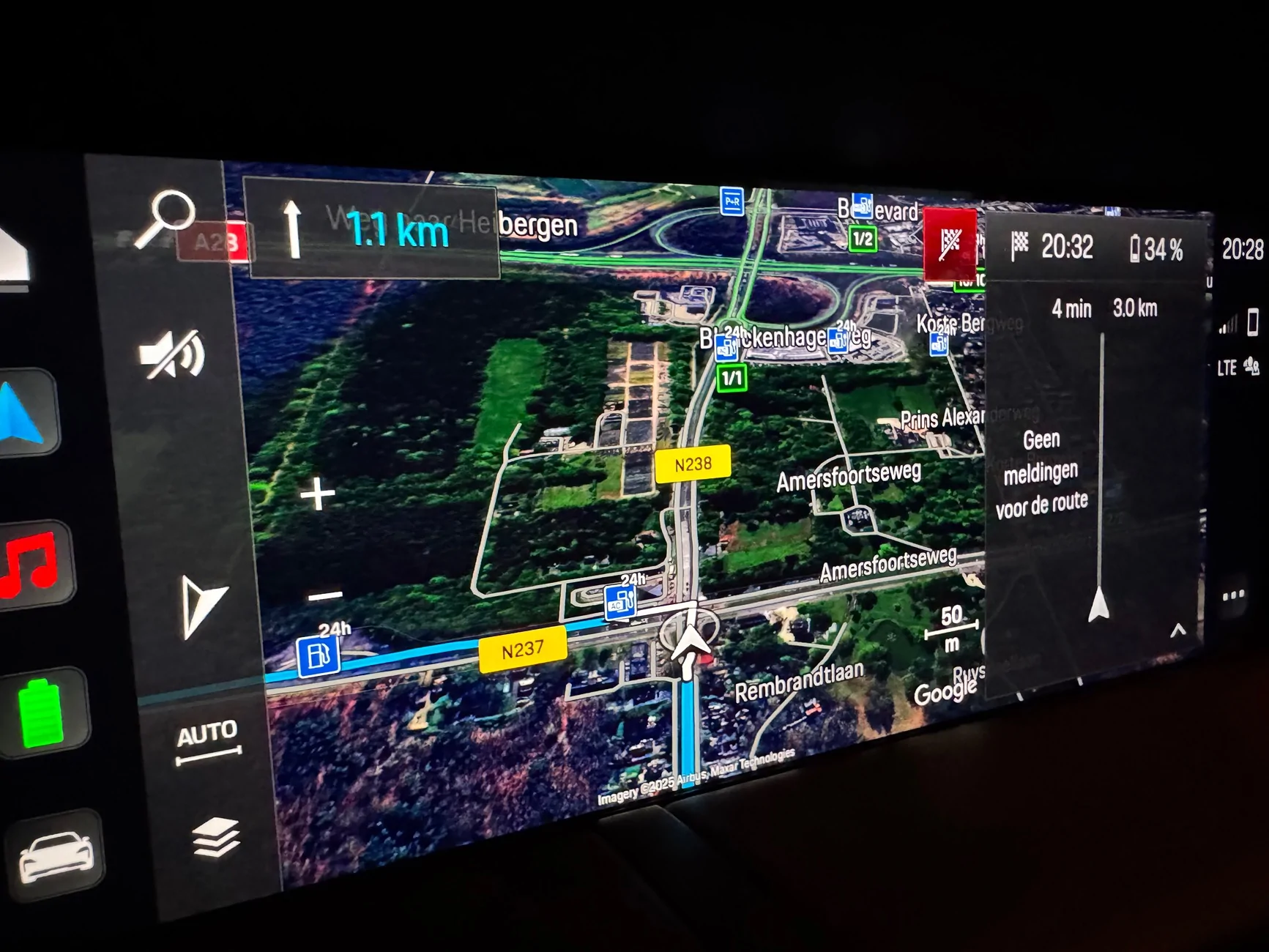

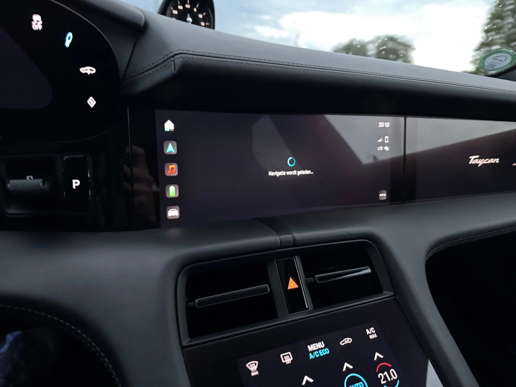

I celebrated too soon. Tonight, during a trip of about 50 km, the navigation lost track 3 times. Each time, the turn-by-turn instructions were showing directions from about a kilometer earlier. On top of that, the navigation app crashed once; when that happens, the navigation screens (HUD, cluster, and center display) all go black and then reboot after about 20 seconds. You have to re-enter your destination after the reboot.
I’ve attached some interesting pictures for anyone who wants to see the issues. You’ll notice the same image twice: once with the wrong turn-by-turn info, and once with the correct version. I was stopped at a traffic light when it managed to pick up the route again - note the turn-by-turn info of 1.1km straight and afterward 20m straight with the info about the next turn. The pictures are taking at the exact same spot, 20 seconds apart. The other picture shows the crash.
When I got my car back on Tuesday, I agreed with the dealer that from now on, hardware components will be replaced one by one. The importer first wanted to test the updates before incurring costs on hardware replacements.
Two pictures at the same point, one when the fault occurs, one when it corrected itself: (quality is low, I was behind the steering wheel)
Porsche Taycan EU/UK: Ongoing navigation issues [Solved with PCM v3892] IMG_0622
Porsche Taycan EU/UK: Ongoing navigation issues [Solved with PCM v3892] IMG_0623
And what I see during the crash;
Porsche Taycan EU/UK: Ongoing navigation issues [Solved with PCM v3892] IMG_0615
