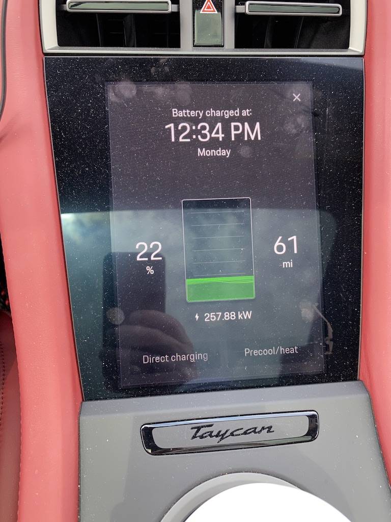

So, to help wrap this particular adventure up, I set up a drive up to Ipswich, MA (Little Wolf Coffee FTW, not to mention the Clam Box) and then to Seabrook, NH, arriving with a SOC around 12%.
Before I left, I checked with Electrify America to ensure the 350kW chargers were working, and they indicated they were, so - Adventure Ho! Because if they weren't, I'd be in some trouble.
Arrived to find a repair truck (same repairman you talked to, @louv - he was working on charger 2, one of the two 350kW chargers), so I was rather concerned, but charger 3 is 350kW and was free.
Plugged in, initiated charging and - hey! look at that! - it worked, and not just a little:
It went significantly higher than that, up to about 266kW, and I went from 12 to 83% in 18 minutes.
Well and truly fixed.
Repair guy verified that EA has been doing updates to all these chargers recently, so hopefully things'll be getting better soon network-wide.

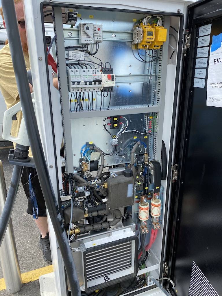

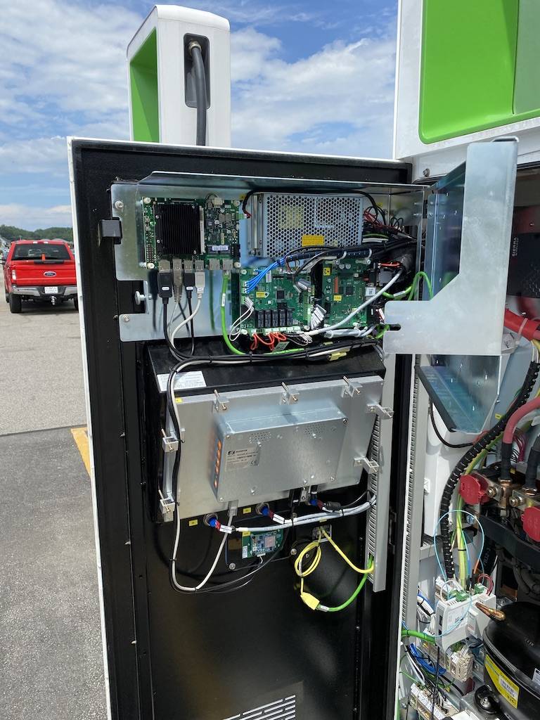

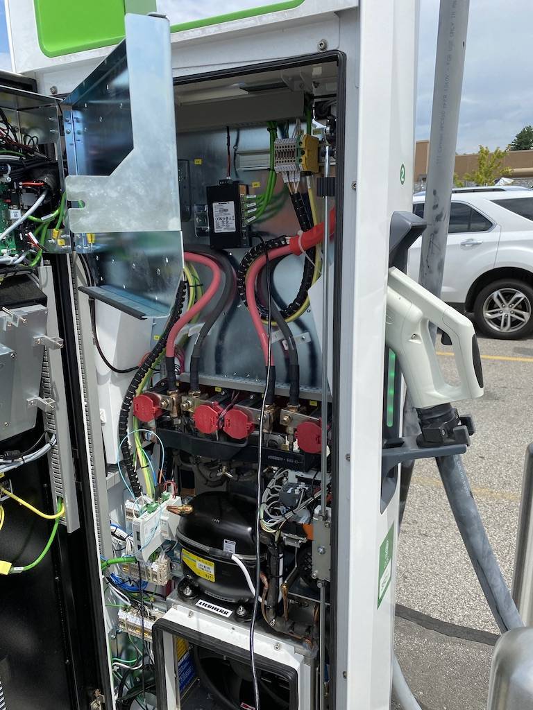

Also, got some interesting shots of the internals:
FYI - in order to reduce the diameter of the cables, and decrease the heat produced by the resistance of the thinner wire, the cables are actually actively liquid cooled, and one thing that takes out the chargers -- including unit 4, here, which means out of the four chargers only two were working, even though EA said all were -- is being out of coolant.
So, this case, at least, is closed.

also they are running Windows 7 as the base OS for the charging control software/screen/POS system - again what could do wrong?
