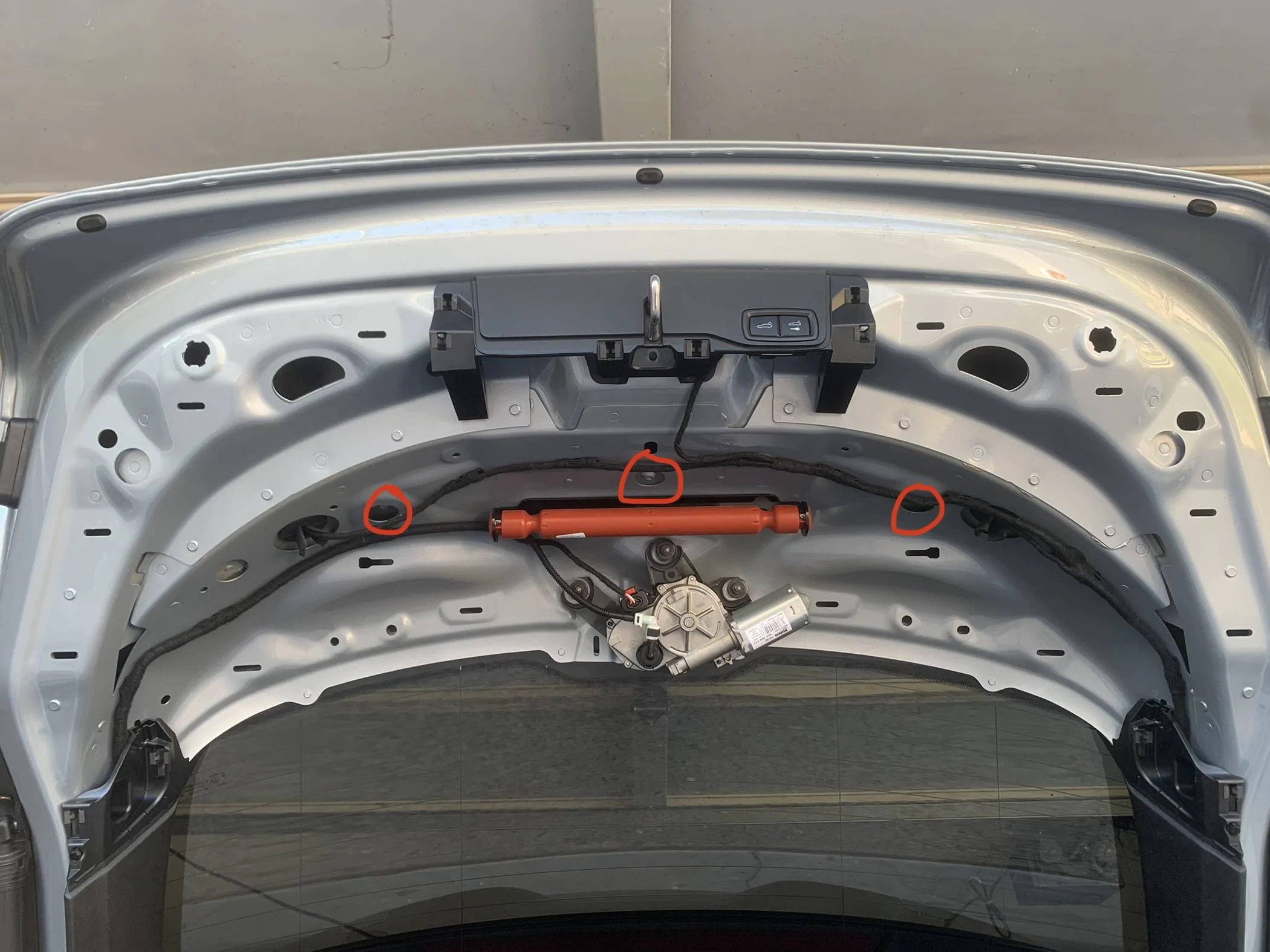

I need advice on how to remove some trim panels on my Cross Turismo so I can route the rear cam wire. I believe I need to loosen the headliner (at least in the back), Maybe need to detach A and B pillars. Definitely will need to remove the tailgate trim panel. If you have experience or advice on how to remove any of these panels it would be greatly appreciated.
I already have installed the FitcamX front camera so I know how those trim pieces work. @DJBlack I noticed you commented about the tailgate trim panel in another thread and I'd appreciate any insights you can share here.

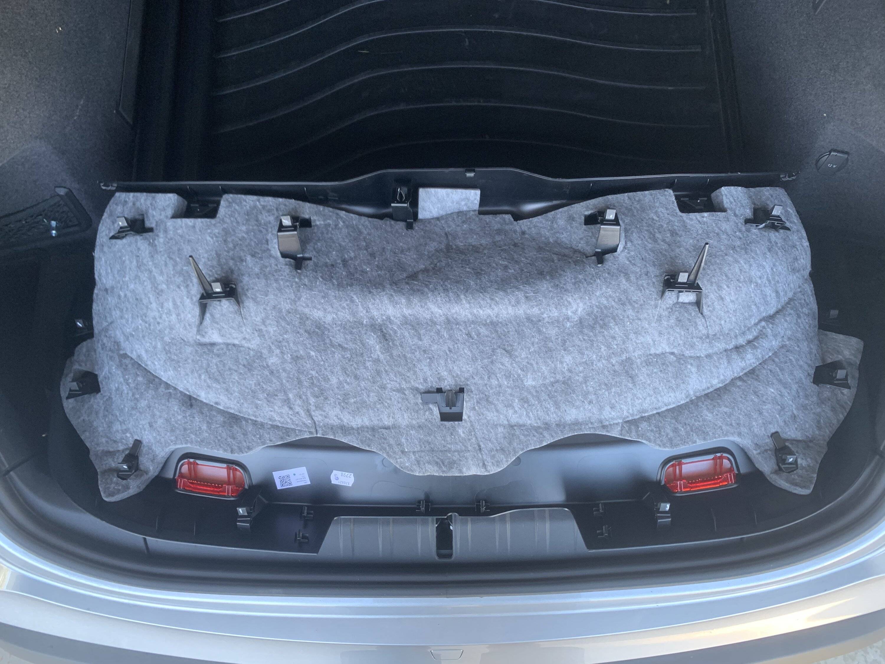

Here’s a pic of the lower tailgate panel removed. If I recall I pried the sides loose first, followed by the clips near the center and finally the tabs around the striker plate.
Thank you. This is great!

The upper doesnt need to be removed, you can pry it open enough to fish a long zip tie ( pick your non marring favorite fishing apparatus) from top to bottom of the upper trim.
Agreed I used your tip to get the cable through..just released the clips where the two pieces join
