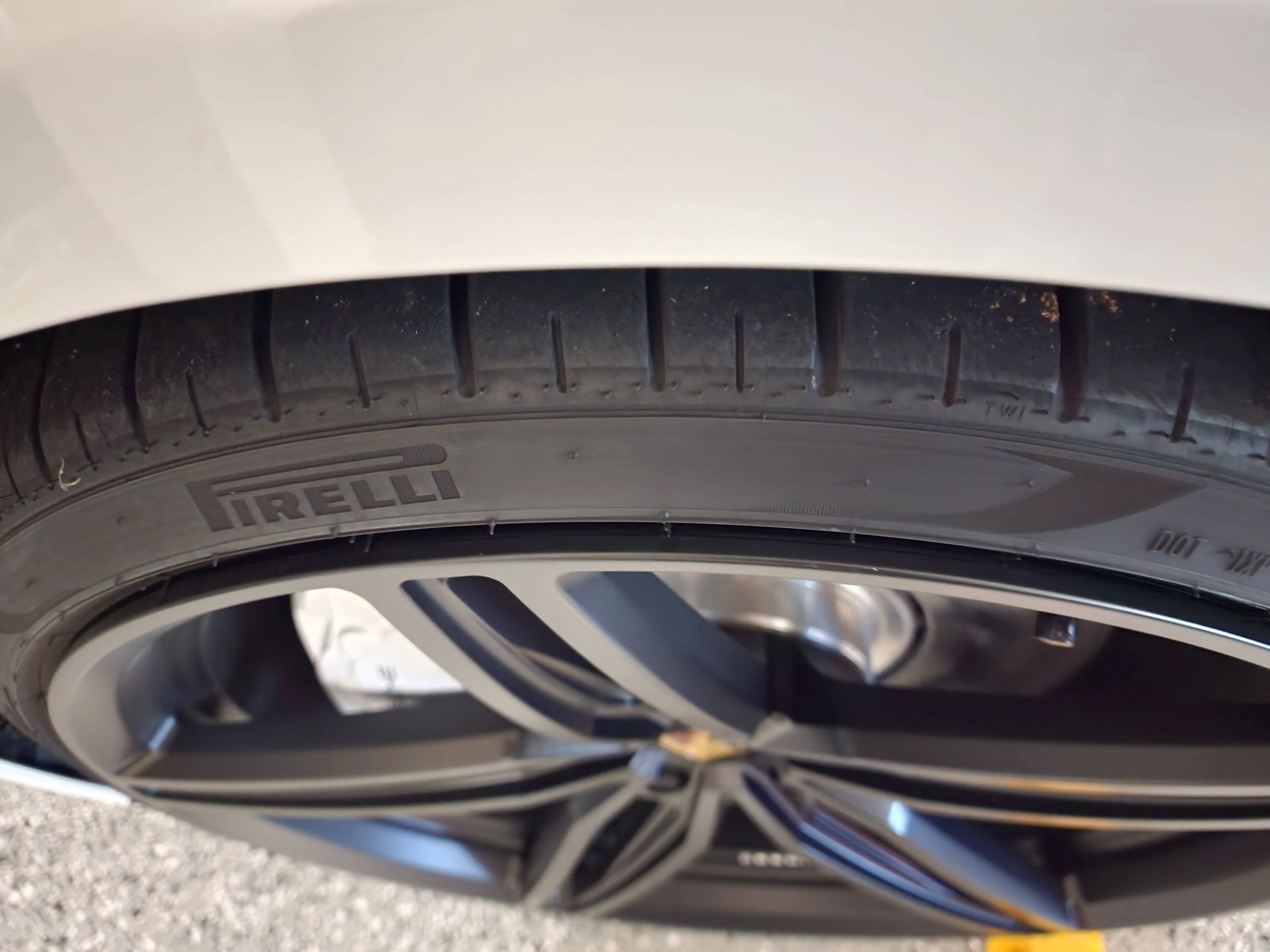

Front:
Porsche Taycan Need help with new 22 Inch Tire Sizes - MY20 Turbo 2022-09-13 12.57.12

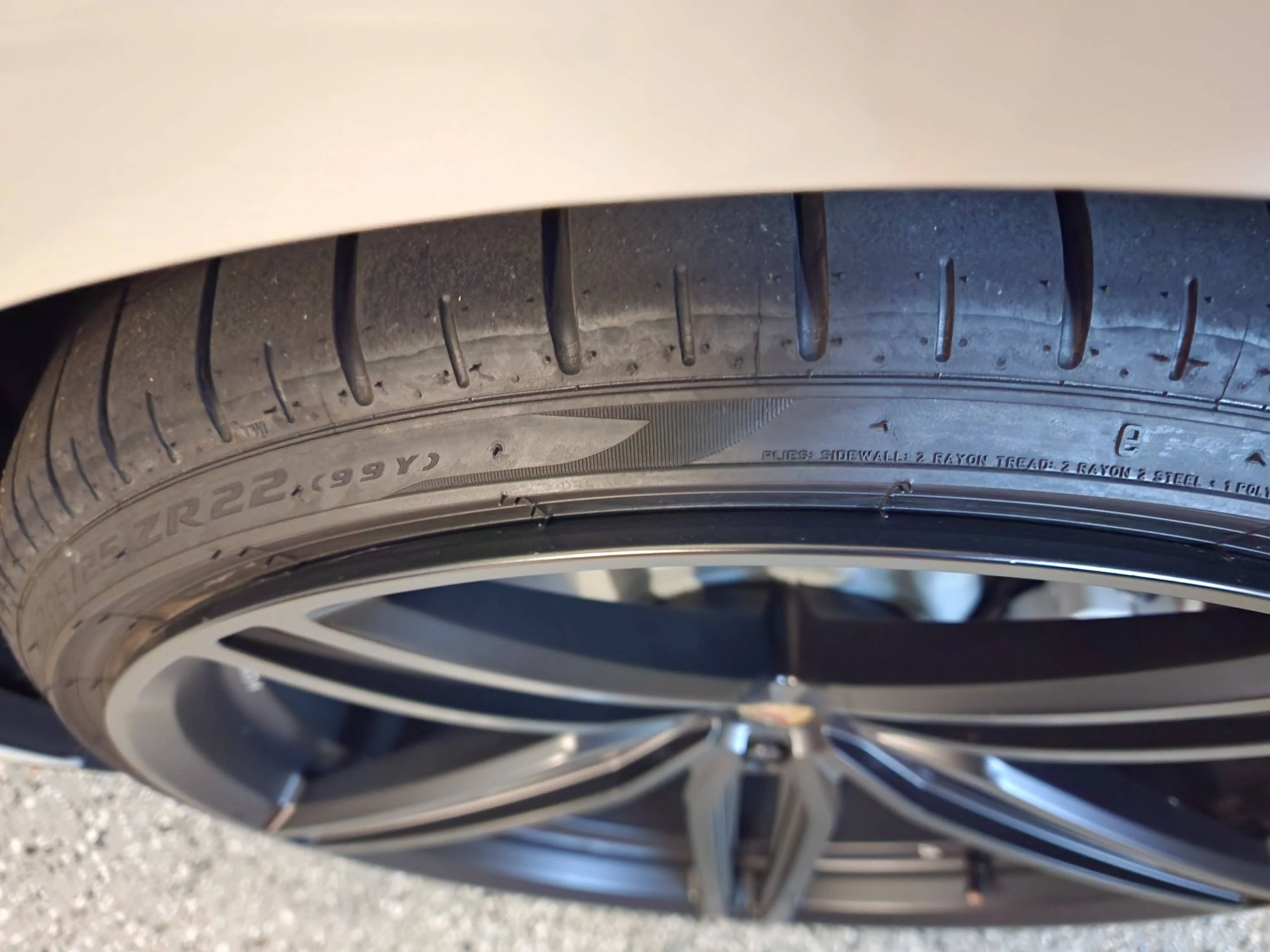

Rear:
Porsche Taycan Need help with new 22 Inch Tire Sizes - MY20 Turbo 2022-09-13 12.56.59

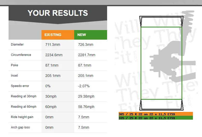

willtheyfit.com is a pretty good tool for checking rim/tire size and how they fit on the rim or on the car.
Hope that helps!

Thanks. This gives a good visual for it. There were a bunch of threads about 22 inch tires, so apologies in advance if I missed a thread with my specific issue. It seems like the "updated" recommendation from Vivid may solve my issue, but was hoping for first hand accounts or confirmation of that thought process!

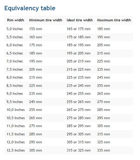

see for the front: 275 is the perfect size, 285 will protect you a lot but is the widest you can go but it will look too meaty IMHO.
Porsche Taycan Need help with new 22 Inch Tire Sizes - MY20 Turbo 1663624185507
For the Rear :
Porsche Taycan Need help with new 22 Inch Tire Sizes - MY20 Turbo 1663624141030
Full table for reference:
Porsche Taycan Need help with new 22 Inch Tire Sizes - MY20 Turbo 1663624239588
source: https://www.tiresandco.ca/tire-equivalence-advice.html
