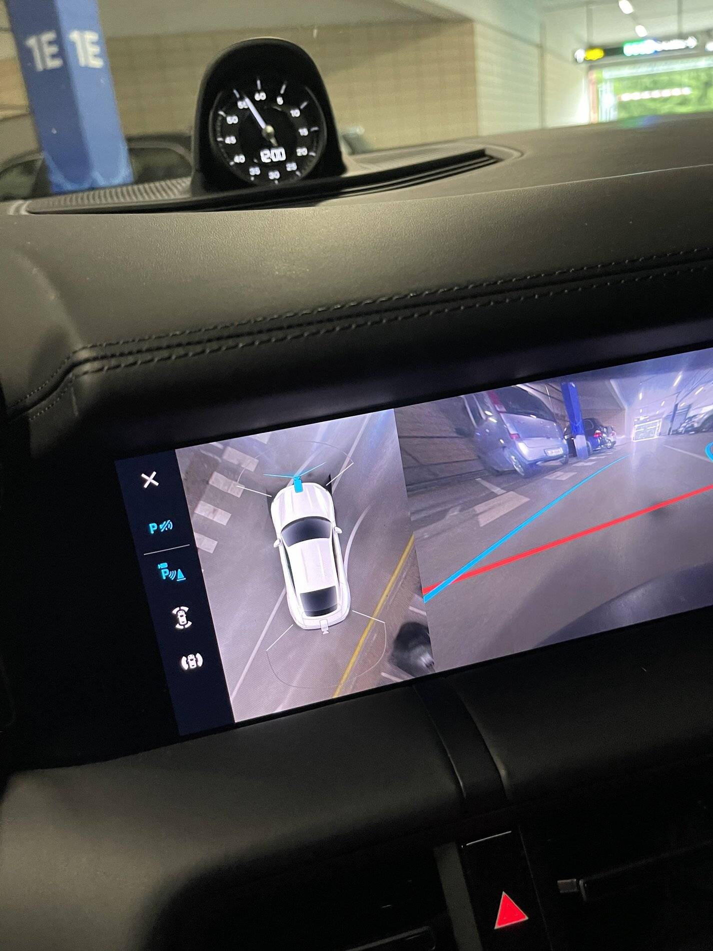

Surround is clearly a better choice as you can get 3rd party chargers instead.
surround is realy nice option.
Porsche Taycan Need Options Advice - Questions on Options before Freeze Approaching Soon 51FBC164-2DF1-47D3-94F4-516756C7970D

Thanks for sharing the pic- I guess it does look a lot easier to park from having the top view I guess. This is making me think to upgrade to the full premium package rather than layer on options.
