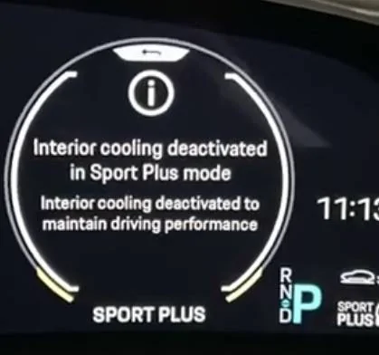

Here’s a pic of the message you’re likely seeing. Pulled it off of an Out of Spec Reviews video. I have not seen it myself, even on the track running near peak temps, and wondered if it was something new or if I just didn’t notice.
Porsche Taycan Never noticed before.  Launch control turns off AC? D4AA471A-86EF-411D-B67E-DF088E13C5AB
frankchn
Jun 20, 2021
69
64
Bay Area, CA
992 TTS, Taycan TTS
I’ve had this happen on track, when ambient temperatures are 90F+.
