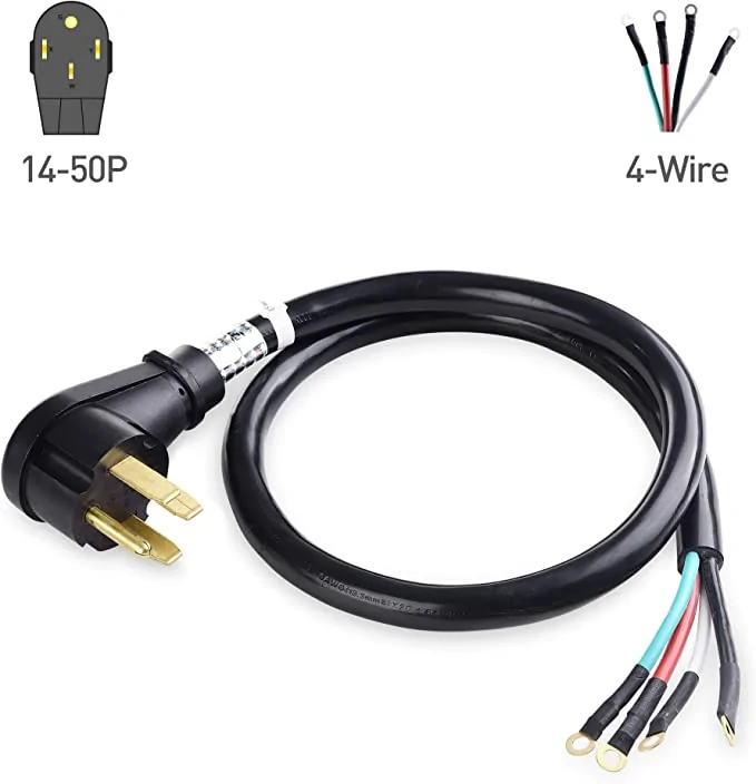

for the adventerous DIY home improvement master you could:
  1. order one of these units
  2. order one of these https://smile.amazon.com/dp/B07TD9KPKJ?psc=1&ref=ppx_yo2ov_dt_b_product_details
Porsche Taycan New 19.2kW Porsche Wall Charger Connect -- Discounted Price via Black Friday Sale 2022 8478703F-0776-4A7D-B038-07BCC9A09F46
NOTE: EVSE's (including this one) only use 3 wires (2x120V hots + ground) - the fouth wire in this power supply cable (white neutral) will _NOT_ be used, and there is no connection inside this EVSE for the neutral wire - you'll just wire nut it and leave it unconnected inside the unit since it's un-necessary and unused). Green Wire is ground, Black Wire is 120V power, Red Wire is 120V power…hook the ground to the ground inside, and the two HOT's (Black & Red) to the power inputs, ignore the white wire) and you've wired your "hardwired" EVSE to a NEMA 14-50 plug
please turn off the breaker while doing any electrical work.
and simply replace your PMC+/PMCC…and reuse your existing NEMA 14-50 plug
that is possible - but there are non-Porsche EVSE's that can do 9.6 kW and will plug into your existing NEMA 14-50 plugs for way less than $1200'ish
but it's an option…
Disclaimer - don't take home electrical install advise from the internet - and make your own sound judgement as to if you want to proceed in this manner.
the upside of this unit is that today it's a 40 amp 9.6 kW unit - but in the future you could upgrade your EV charging circuit, and just adjust the settings and boom, your 9.6 kW EVSE becomes a 19.2 kW EVSE - so if you upgrade your EV charging circuit (new wire + new breaker) you can just reconfigure this unit and it will then be a faster charger - no need to purchase another EVSE to get faster charging service.
the amazon supply cable referenced here makes this hardwired unit plug&play with your existing NEMA 14-50 plug - you can upgrade and hardwire it later…
