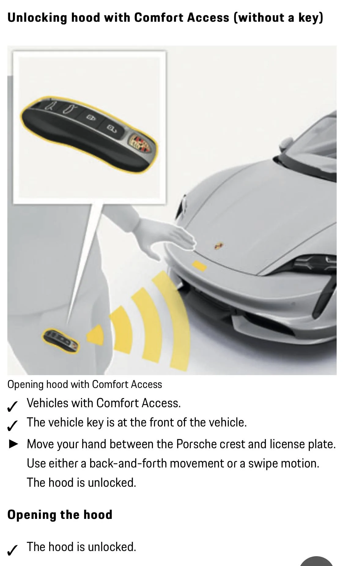

I have not had issues opening the trunk with my foot; however, I have not had similar luck with the frunk.
Please explain how to trigger using Comfort Access to open the frunk; I must not be doing it correctly. Do I presume, correctly, that you need a key with you for Comfort Access to function?
louv
Don
Sep 6, 2019
1,154
3,728
Maine
The title in the “Good To Know” app is slightly misleading. It says “without a key”. What they mean is “without pressing the buttons on the key”.
Porsche Taycan New feature to open trunk with your foot? BFD27377-260E-4F7F-81C2-F42288427821

Thank you. I was missing the obvious.
