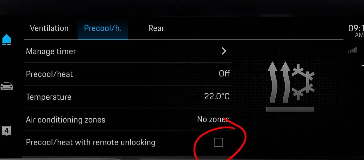

SO I have had my Taycan for almost a week not..have a few questions, hopefully you can help me answer
1. -Every time i get in the car the heated seat and steering wheel want to come on. I have gone in my app and set the automatic cooling/heating and clicked seats off and it still seems to come on.

1). the first one, you should turn it off in the profile and on the PCM as mine would cool or heat the seats for 5 minutes every time you opened the door (unlocked it).

Disable preheat on unlocking doors (PCM Vehicle setting).

Both have been figured out thanks yo you guys
