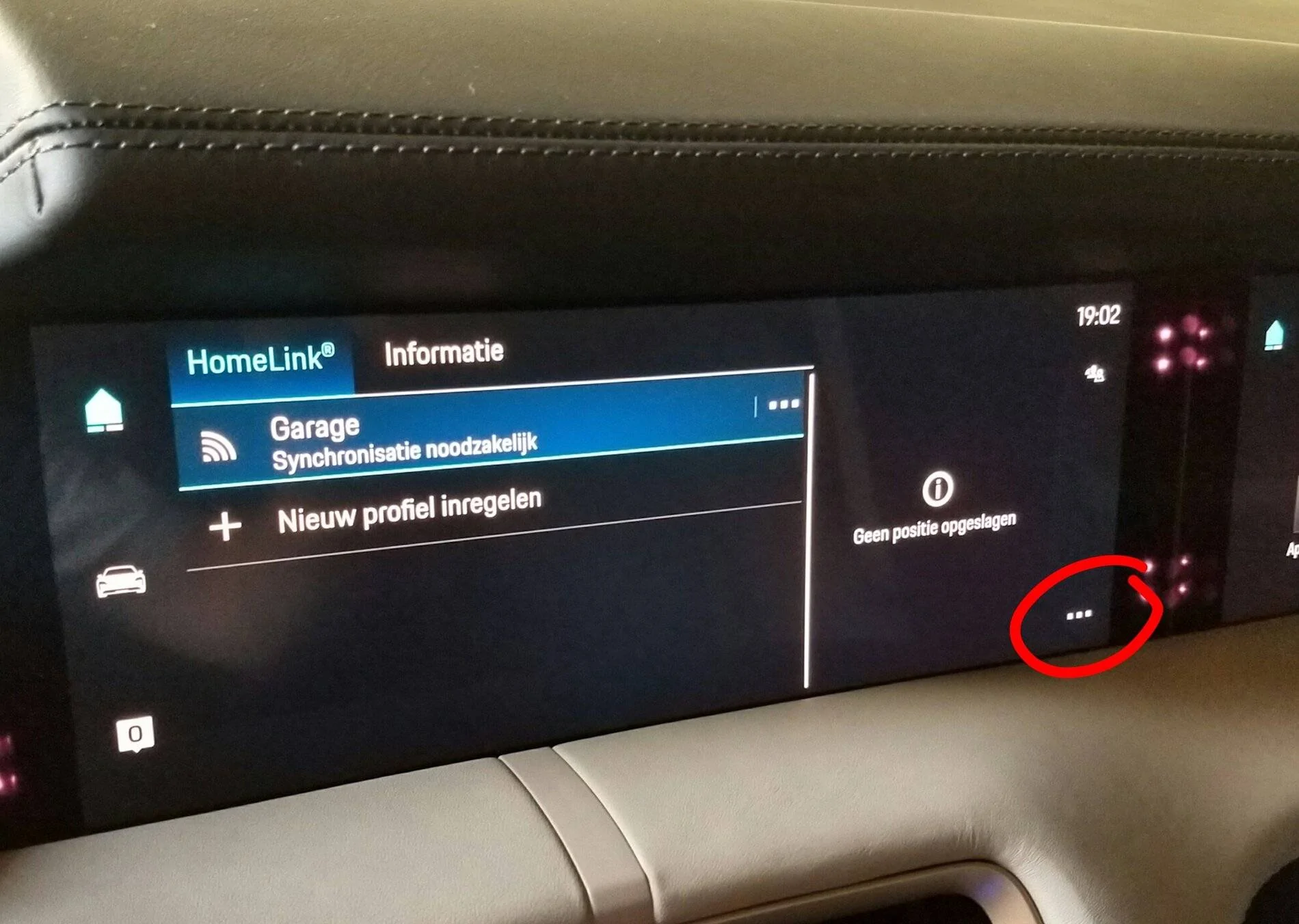

Thanks. That worked.
You can use the "three dots" on the right, it opens another menu.
PS You can see the reciever between the displays, 2×4 red dots on the right (only on camera, apparently).
