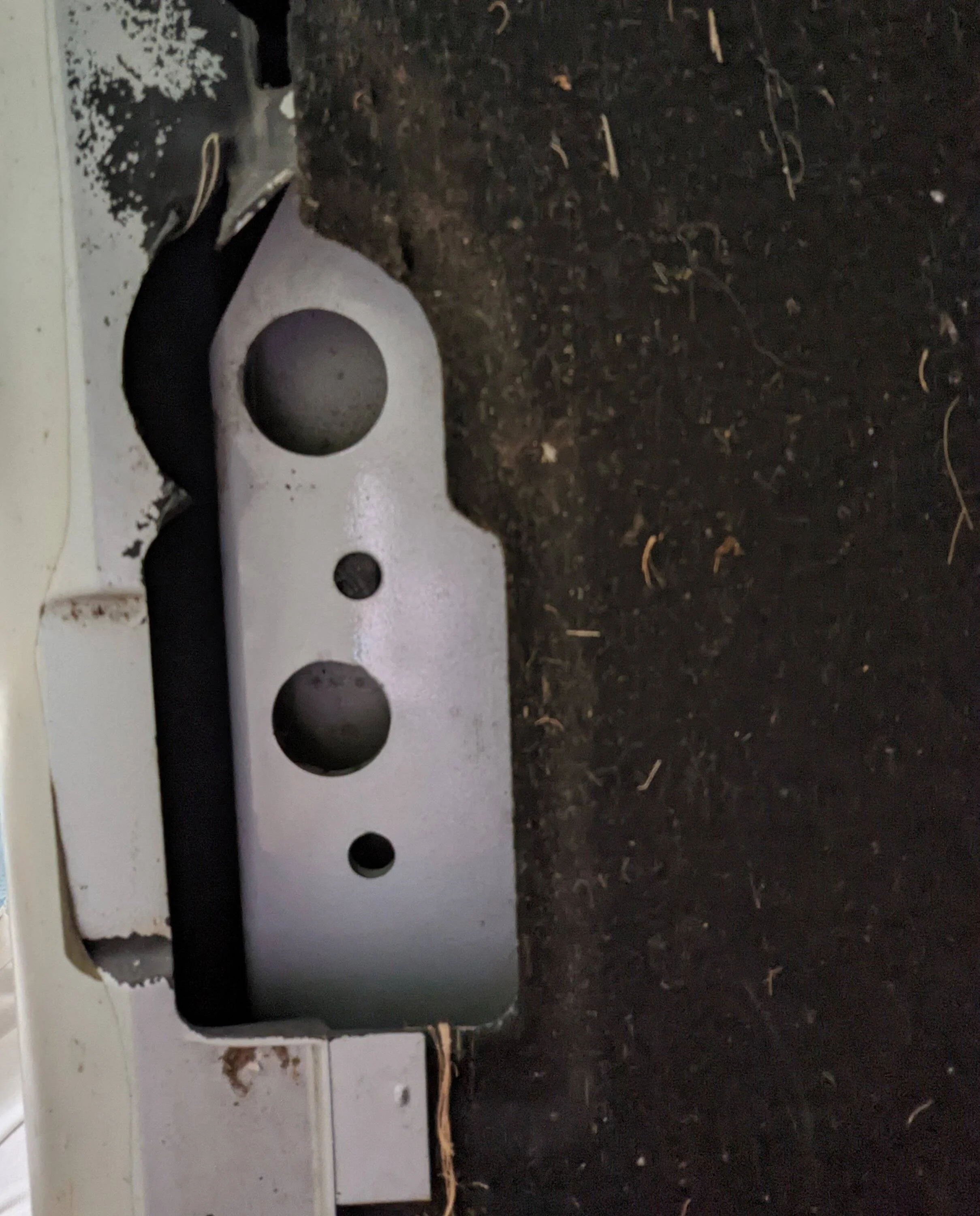

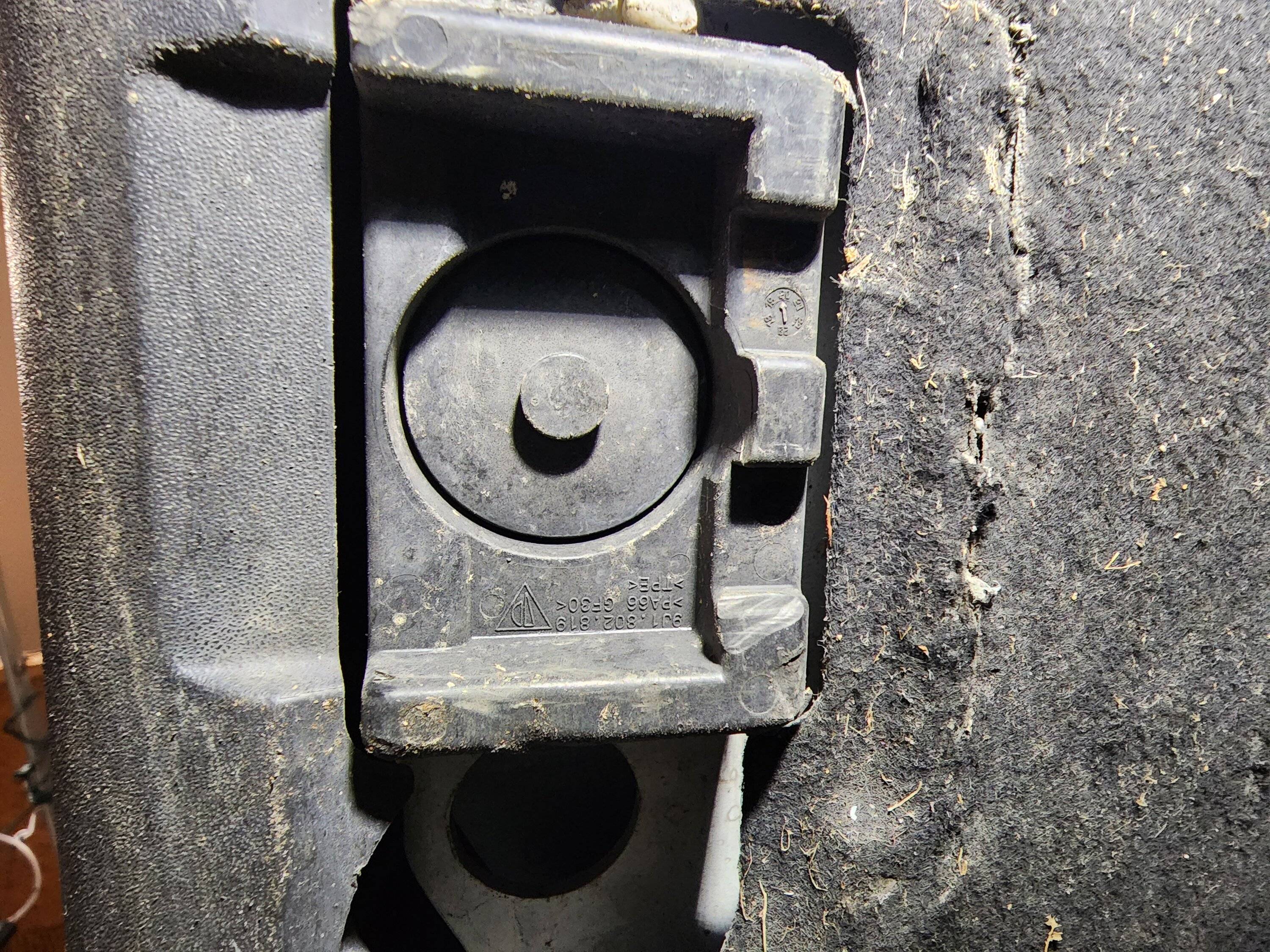

After reading this post, I took a look of my car and realized one of the plastic jack covers is missing (front right side). Anyone knows the part number or where can I order a replacement? thanks.

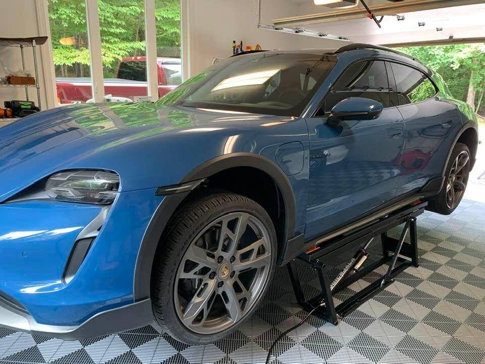

I would get the
7000TLX
Extended Frame Length
I have the 7000TL, but I had to add the frame extenders due to the jack points being too wide
+1, good tip. The lift point spread of the Taycan is 53" min to 63" max, and so the TL model is too short.
Curb WeightTire SpreadLift Point SpreadGround ClearanceRecommended Model
≤ 7,000 lbs.≥ 71"37" - 60"≥ 4"7000TL
≤ 7,000 lbs.≥ 76"43" - 66"≥ 4"7000TLX
(Source.)

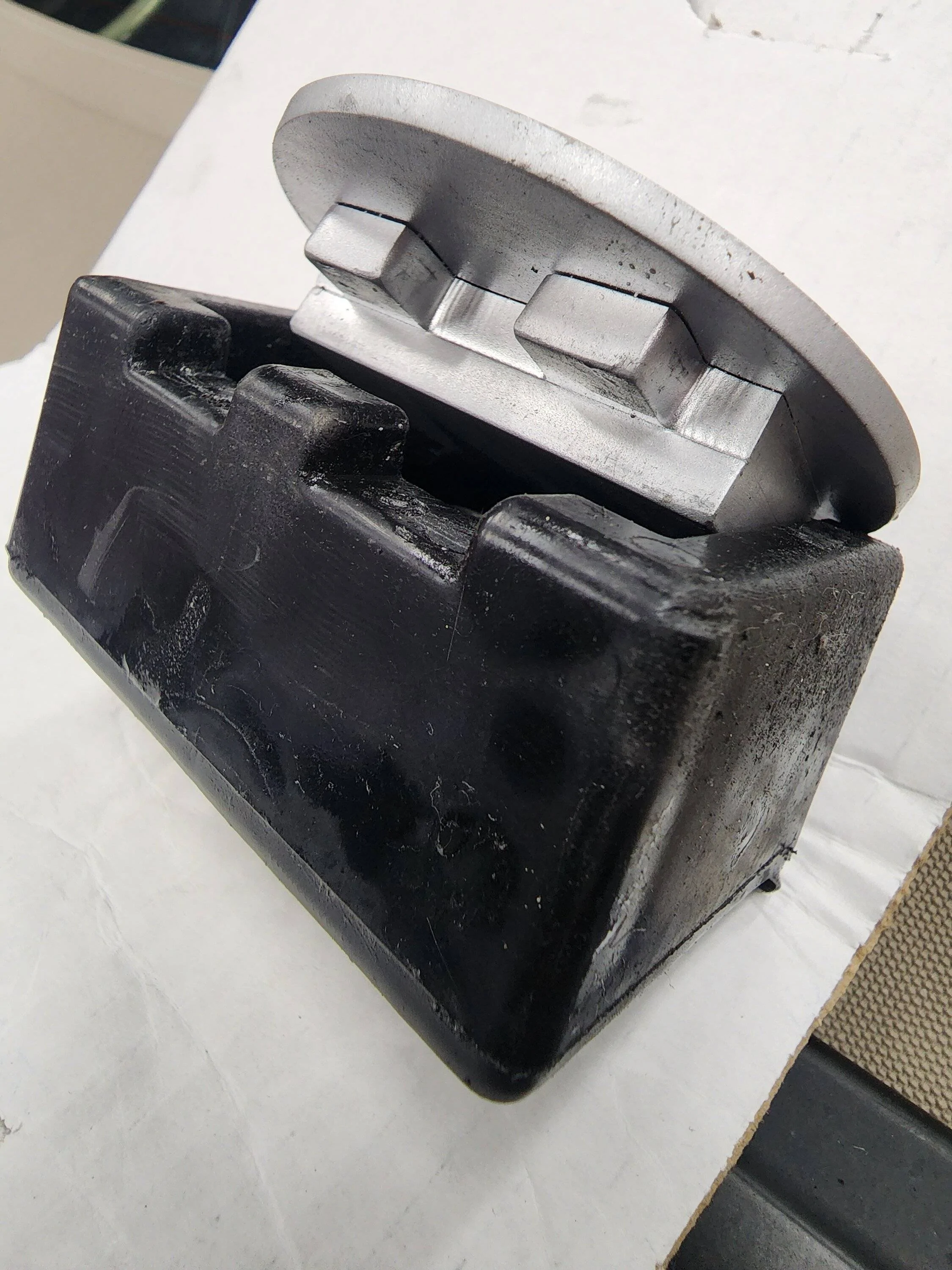

Well someone has been feeding misinformation about the Taycan 4S. I have a 2020 Taycan 4S and the Jack pad are supposed to have Two little fingers on the Jack pad to fit 100%
This is what my Buddy and I came up with based off of the Manufacturer Specs.
This is what they look like.
Zero play and fits like a glove.
Made out of 100% Steel and will last ?
Let me know if your interested in getting any. Made in the US and quick shipping anywhere.
Thanks David aka

@PCASSOO I don't think it's reasonable to use words like 'misinformation' or 'supposed to'. The Taycan jack points are the same part as the Panamera, and similar to the Macan and Cayenne.
The shape is vestigial - the older sibling cars came with a scissor jack and spare wheel. The rectangular hollow was intended to provide a reliable receptacle to locate the crappy & dangerous scissor jack (which didn't come with an exquisite inverse jigsaw-matched contact plate).
The small cutouts are a convenience to allow light through to make it easier to locate and to position the jack / jack pad.
You can find quite a few different jack pads for the Taycan, Panamera, Cayenne and Macan, all with a similar design - high durometer urethane with a basic rectangular protrusion on top. The benefit of the urethane ones is that they don't chew up your jack points.

Well if you want to trust your 6,500 lb car on a little widget that doesn't fit 1,000% your braver than I.
The ones we made are made of Steel and will last forever and Not in anyway Harm your panels under the car. The Biscuit has two additional fingers that come off of it and Locks it in 1,000%.
Let me know if anyone is interested in getting a set or 4 jackpads?
If you want to Color match your Porsche's Paint Code that can be done too.
I myself don't need a matching Jackpad. Lol
All items are Custom fit to our cars and USA Made and we will never run out of Products.
Thanks David aka Pcassoo

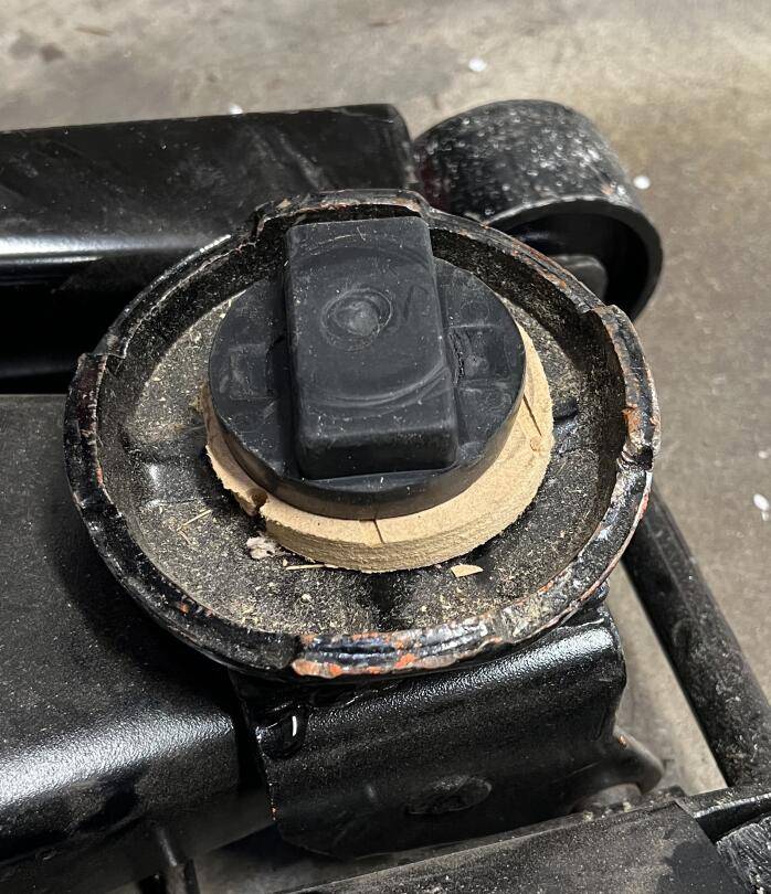

Very nice. Not sure the price and weather it would be worth while. I've been using an inexpensive rubber set of pads advertised for MB and a piece of wood I cut from an Ikea cabinet mounting rail. Works just fine to jack the car, noting scratched, nothing broken.

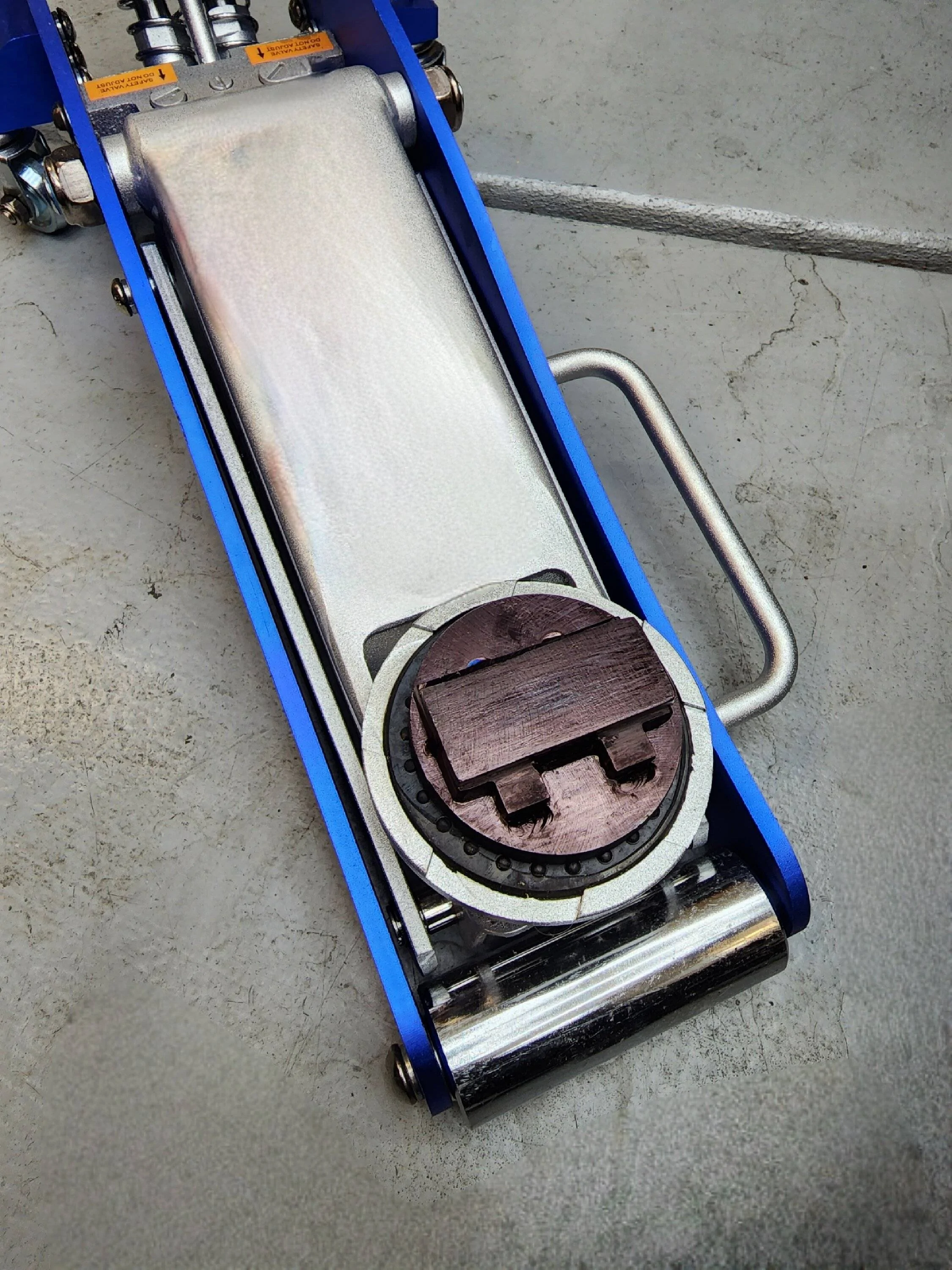

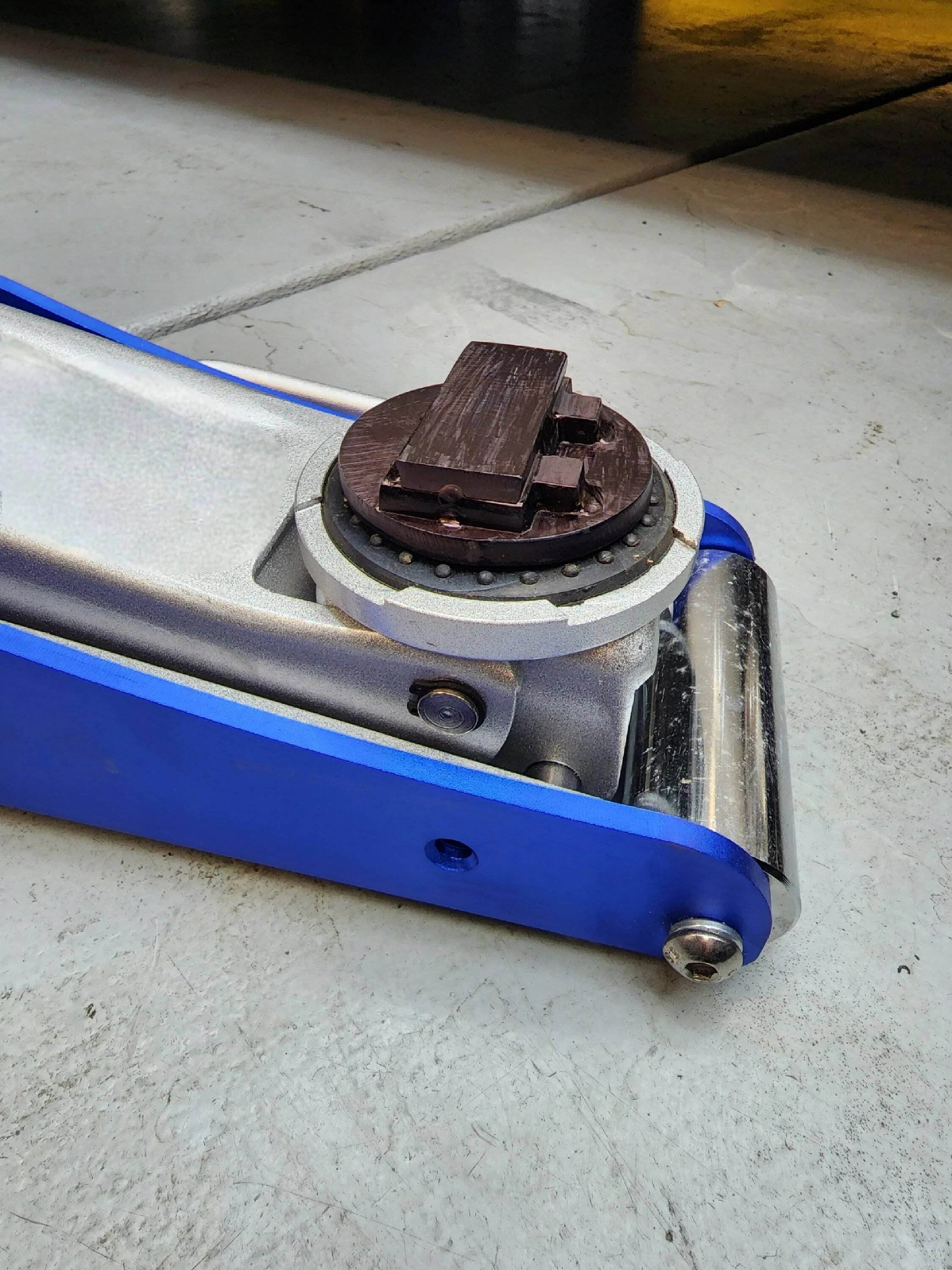

Oh Boy.
That's cool if that works for you but when you want to switch over if you ever do just let me know.
I Love mine and you won't need any wood to lift the Jackpad off of your lift. The video clip shows exactly how the Jackpad works and Locks the car in 1,000%.
