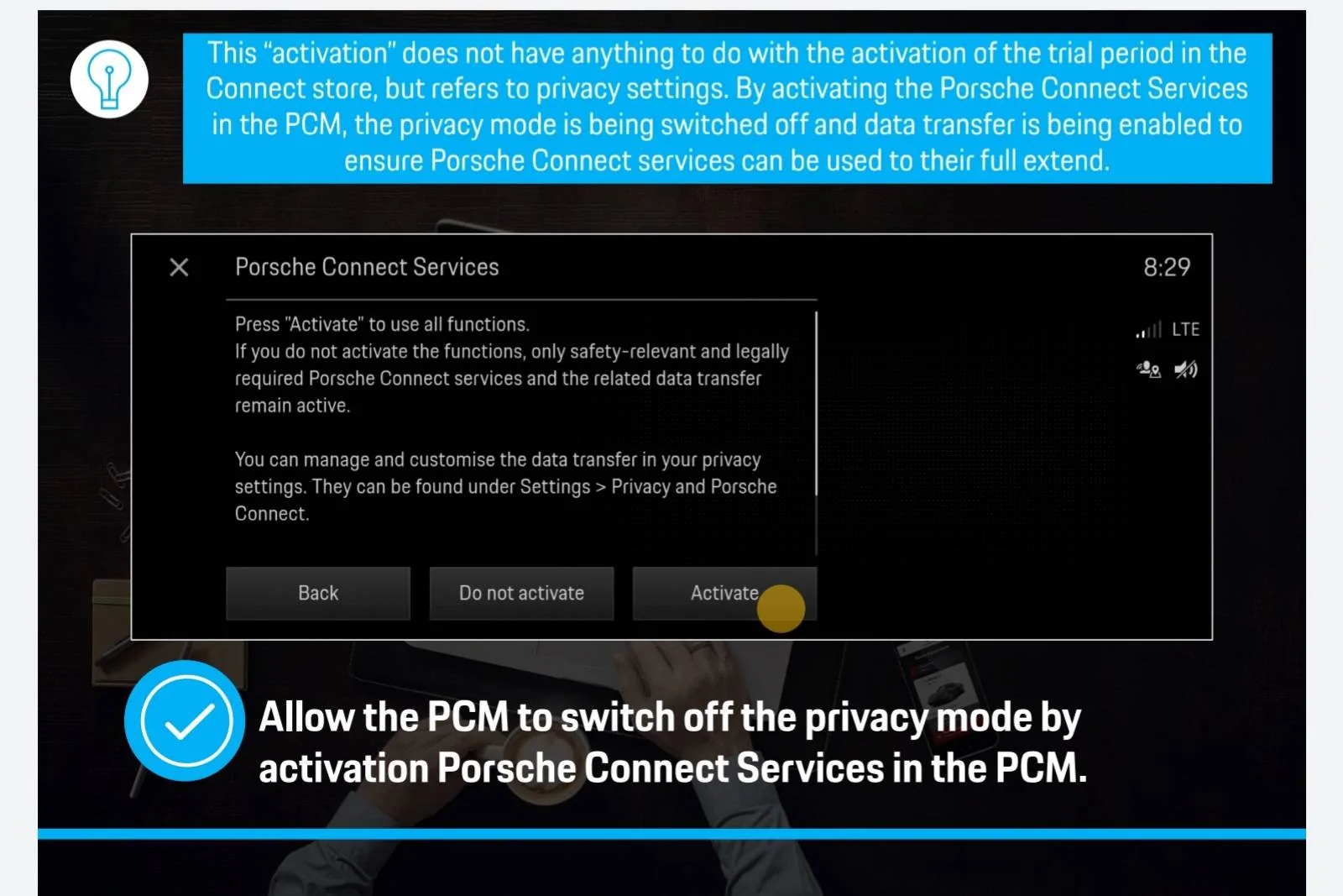

These 2 could be linked. Because you are not automatically signed in you also loose this setting? Maybe when the automatic login problem is solved this will 1lso be solved.
You also need to activate the Porsche connect services.
