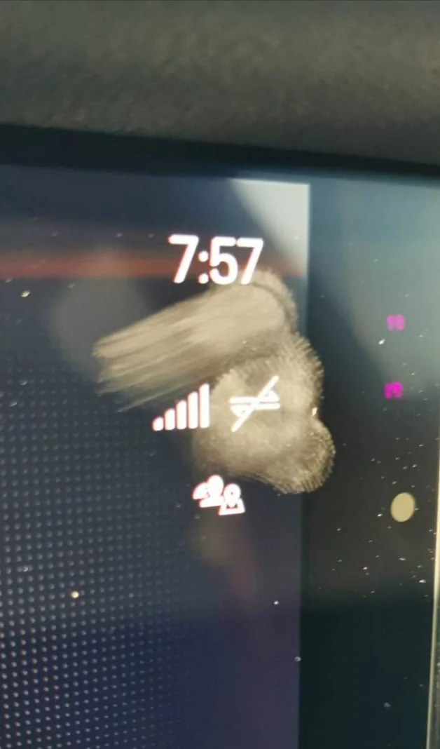

Hi,
My car is unable to connect to Porsche since August 27th.
Last update to Porsche Connect was around 1:00 AM at that date.
Today I found out that the car is unable to make a data connection, I can't listen to internet radio, no google traffic is updated, no online destinations available and so on. Car is telling me: no data connection available. No LTE picture visible either in my screen.
Porsche Taycan No data connection - anyone else having the same issue currently? IMG_20200901_145243
Am I right that there should be a LTE picture?
I called the dealer, they tell me that there is a global issue but I can't find anything recent on this forum, I would expect that others have reported it already here?
Anyone else having this issue?
Cheers

This sounds very similar to my issue. I have the same icon with the slash through the connection. There is no connectivity as a result- I cannot use Apple Music in the car, and none of the traffic data that I used to receive on my maps is displayed any more. I cannot connect with my vehicle with Porsche Connect anymore.
I went to my dealership and showed this to them today. Their product ‘expert’ was puzzled and took a number of photos, and said that they would need to take the car in to get it resolved.
Ok yeah, seems to be the same issue...
Wondering what they can do about it, I'm thinking about a hardware failure.
Lets keep in contact about the progress, my car is going to the dealer tomorrow morning, they expect to hand it back on Wednesday.
I had the same issue a few weeks ago. Long story short: Porsche Centre Amsterdam replaced a faulty control unit (regelapparaat) and quote/ unquote: ‘resetted the Com box behind the replaced unit’. Works fine ever since.

Interesting...At Porsche Amsterdam they were the ones who were insisting to replace the unit whereas I was conservative as I was not convinced that that was the cause of the problem. I thought it had to be a software issue and not a hardware failure, the car was just 3 days on the road, so pretty new. Nevertheless the replacement unit got shipped from Germany and it works. So far the dealer was right in their approach.
