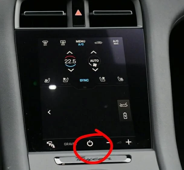

A lot
FWIW, have you tried to press the center button on the lower center display where you can check and uncheck the different displays (exactly the ones you mentioned)?...

Dee
Dee
Dec 14, 2018
63
2,658
3,119
A lot
Well? Did you?
Once you select/deselect them they may become "more firm" into the system so to speak.
Happened to me on several settings and now it's a 100% score.

Well? Did you?
Yes, tried that after the 2nd time the screens went bank -no joy, didn't fix it.
