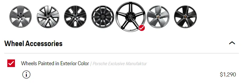

They charged me 2.5k to repaint the wheels.
Ridiculous! Factory ordered is only $1,290. As to the workmanship, it looks like they did not prepare the surface well enough. The blue is releasing from the black.
