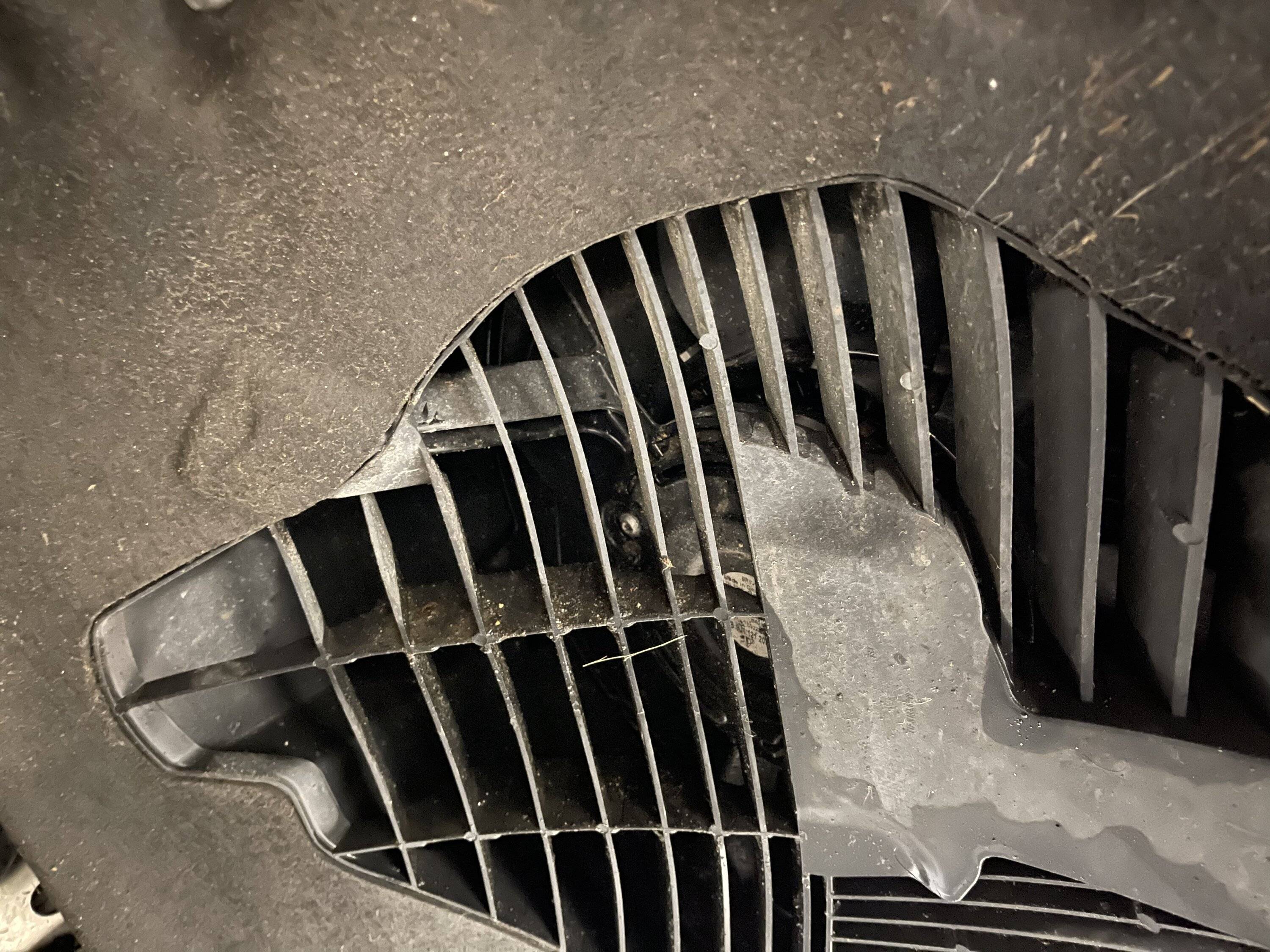

Any for a picture to show exactly where this is on the car?
This is the area in the front wheel arch, directly in front of the tyre and behind the cooling fans and air intake. As you will see, there is little to stop road debris/grit/spray entering this area and damaging the fans - it is being widely reported.
Hmm ... thx for sharing - looks like a prime area for some wire mesh but of course you'd rather not restrict airflow in any way so prob a bit dicey to play with (w/o modeling the effect*) especially should any addl warranty issues arise - still mesh could mitigate the issue substantially.
(* i.e. I'm guessing Porsche would have thought of this and mesh not there already due to impact on airflow?).
This looks like a prime candidate for having some sort of a mesh wire to protect from debris.
Would it be possible to attach a mesh wire cutout (of the same polygonal shape) and hold in place with 5-6 screws.
What is the surrounding material, is it 'plastic' or a 'felt' like material?
