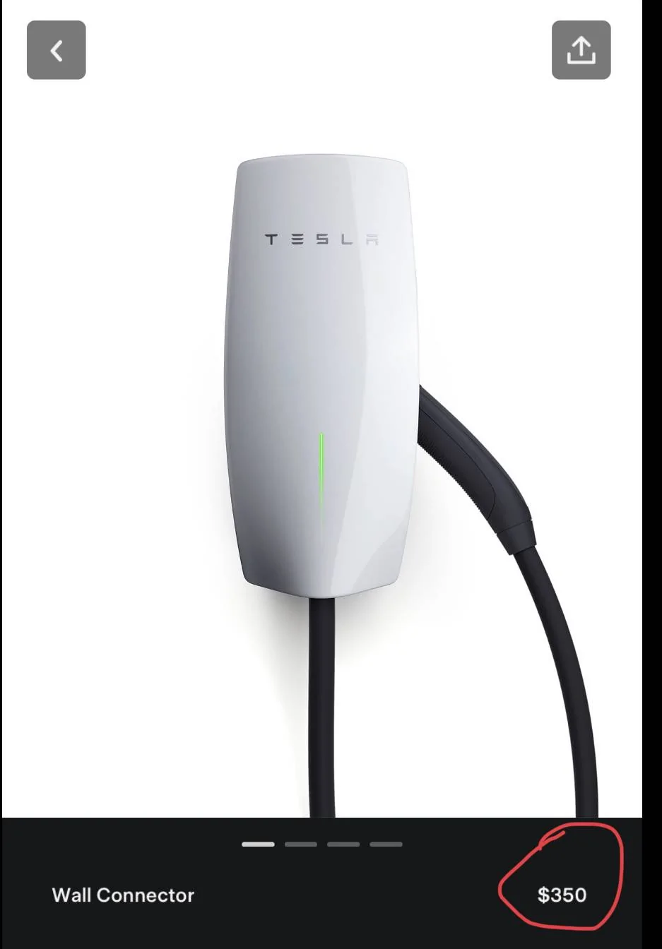

On sale until end of year - $350 - this is _NOT_ the J-1772 version - but has same feature set (adjustable charging to 60 amp breaker) - power sharing, and optional colored face plate…this will REQUIRE a TeslaTap (or equivalents) - but it's a great EVSE for $350
Porsche Taycan [North America] - Get your Tech from a Tech company… Tesla J-1772/Universal charger review E905F58C-3B7F-45C9-9B99-E8FA4C94CFE5
160
5,809
8,642
…and your car from a car company.
I'm a Porsche customer because I believe they make the best cars and in other aspects of my life I gravitate towards "the best" in what ever category I'm choosing to spend money - that doesn't always mean spending a lot of money, but often the two correlate
even the most die hard Tesla hater and Porsche fan (sometimes one in the same but not always) has to admit Tesla does tech way way way better than Porsche - that doesn't mean you have to buy a Tesla vehicle, but you can leverage their tech expertise to make up for for Porsche's lack of tech expertise - and the primary way you can do that is to ditch the wonky and troublesome PMC+/PMCC and replace it with a Tesla J-1772 wall charger
I can love my Taycan and admit Porsche makes about the worst EVSE in North America and I can purchase an EVSE from someone else - cause it's not supposed to matter…
just like I did - and having spend less than 2 hours swapping my PMCC w/NEMA 14-50 plug for a Hardwired Tesla Wall Charger w/J-1772 connector - we're up and running.
all I can say is so far so good
and it's only $550
no Tesla Tap required - it comes native with one of the nicest, sleekest and easy to use J-1772 handles I've seen - and I splurged for the $75 "colored" glass front that almost matches my Gentian Blue Taycan
over the next few days and weeks I'll report on any problems but given my past experience with their EVSE's this one is a great product
