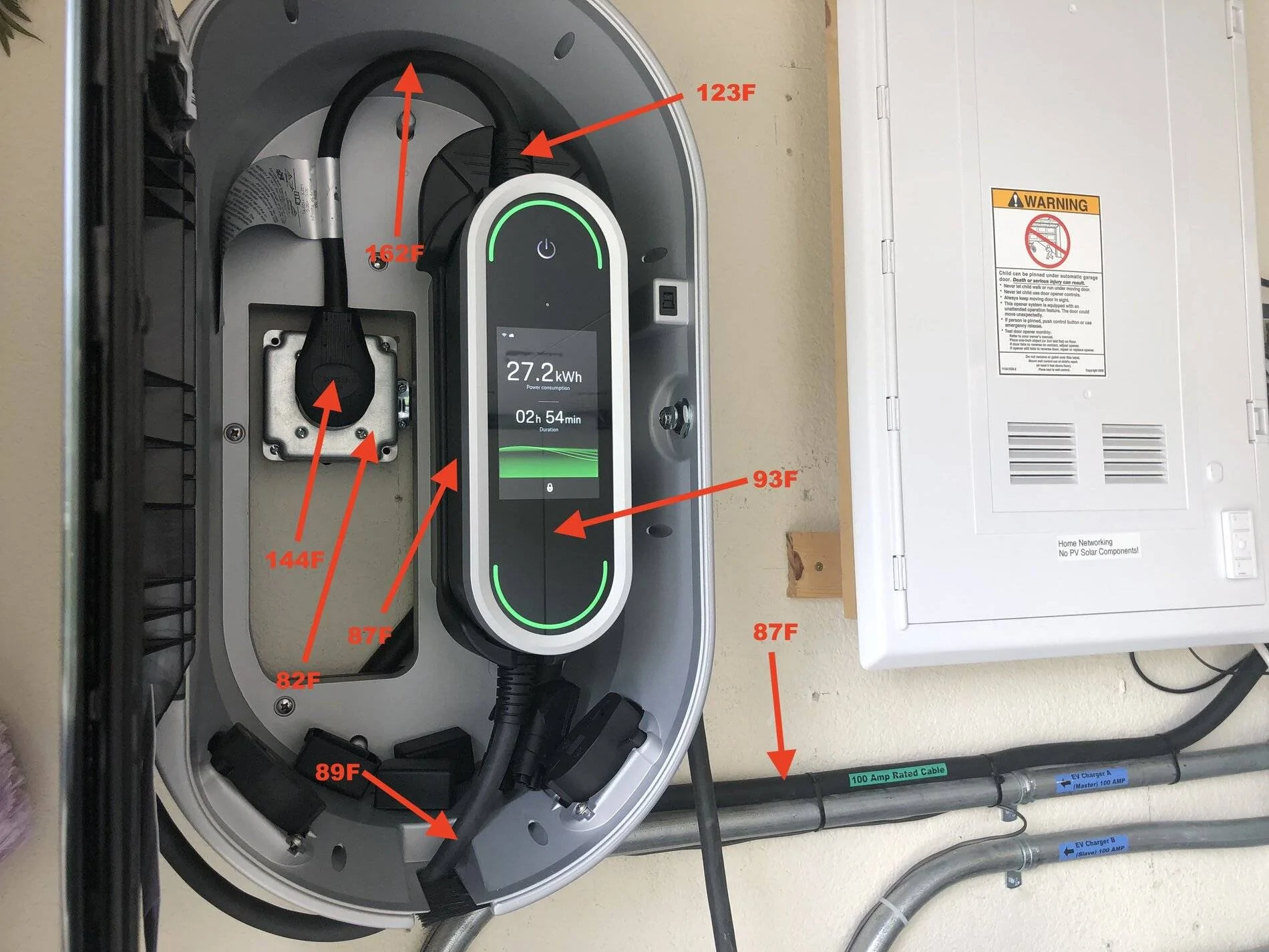

What would nice to know is what temperature was reached by your supply cables (as far away from the EVSE as possible since it will be pushing heat to those cables too). Better yet, have a comparison of all these temperatures when using Tesla WC vs. Porsche's PMCC or PMWC, drawing the same current in the same ambient temp.
160
5,808
8,640
my Tesla wall chargers supply cables never break above 90F-95F - I've measured them @ 48 amps…6 gauge wire - the Porsche stuff is just so so so bad.
Dave -
There are two cables on the PMCC - one that connects to the NEMA 14-50 connector and the other to the J1772 connector in the car. What is your thought about Porsche sending each customer a 6 or 8 AWG replacement for the cable that connects the NEMA 14-50 plug to the PMCC?
According to your temperature tests, that seems to be the only cable that is reaching temps >90ºF, so perhaps this would resolve 90% of the issues that cause shutdown during charging and/or destruction of the NEMA plug.
To me this seems like a low-cost resolution, if it would work.
Thoughts?
160
5,808
8,640
Dave -
Thoughts?
I agree 100% - the only problem is the power supply cable - the NEMA 14-50 and 6-50 cables are woefully inadequate
the power supply cables need to be replaced/upgraded - and this should've been done months ago - this solution should work across the product line (VW, Audi, Porsche).

Hubris - I mean that sincerely - I believe they still 100% believe the problem is not their crappy supply cable, but those stupid american's using $12 NEMA 14-50 power outlets (they are not entirely wrong - but their cable thermally stresses the hell out of a NEMA socket - one could argue they could be less stressful to their host sockets) - our 162F power supply cable is not the problem (which by the way with 6 gauge wire would cost less to make than the cost of the Hubble power socket they are recommending)
their cable may be "technically correct" given insulation and wire gauge - but a different wire gauge would run cooler and be less stressful to the host socket. The cheap NEMA socket isn't melting itself - it's absorbing heat from the Porsche supply cable - and over the course of days/weeks/months it gradually fails given the thermal stress it's been subjected to from the Porsche supply cable's normal operating temperatures. A different power supply cable design would have lower normal operating temperatures - and thereby transfer less heat to the crappy $12 NEMA socket…while Porsche's cable may not be "at fault" it's at least contributory negligence - their cable design demands a higher quality NEMA socket that has more robust thermal characteristics. Their design unnecessarily thermally overwhelms lesser sockets.
I've also tested my unit running at 40 amps. Even on hot days I'm not seeing anything like these reported (very high) temperatures. That said, since these reports surfaced I began mostly charging the Taycan at night, esp. in the summer.
