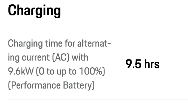

to achieve Porsche specified charge duration of 9.5 hour (see below) - you will need to temporarily adjust your PMCC each time you use it - or purchase an alternate 9.6 kW EVSE from a vendor other than Porsche.
Still not as bad as Tesla which advertised 691hp for P85D's, only to later admit that it was battery limited to 463hp from the factory. In other words, in order to achieve the advertised spec you would have had to replace the $40K battery in the car with one you'd have to design yourself because Tesla did not at that time sell a powerful enough battery.
