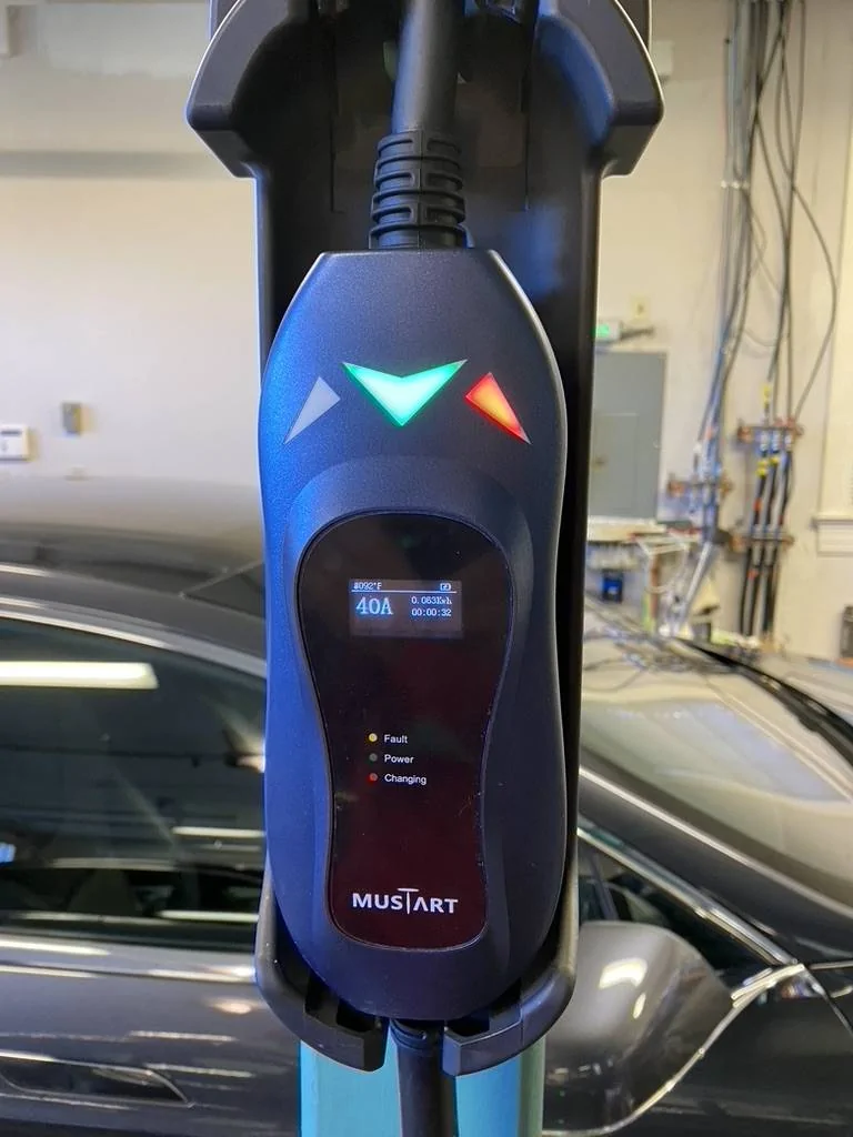

MusTart is cheap and a fine solution to the issue. I even managed a field-expedient re-use of the Porsche mounting device. As a bonus, it only takes a few seconds to start charging:
