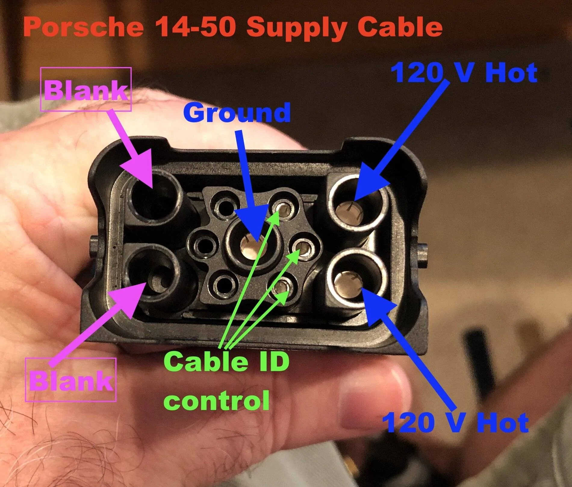

@daveo4EV Can the PMCC be hardwired if the issue seems to be the supply cable not being rated for 40A use? I have a Gen 2 Tesla Wall Connector, GE WattStation and Siemens VersiCharge. They all have 14-50/6-50 plugs and the NEMA plug is just connected to the 3 lug connectors inside the unit. I removed the NEMA plug and hardwired GE WattStation and Siemens VersiCharge.
I haven't seen the internal of PMCC but can't the PMCC be hardwired this way if the supply cable is just a pigtail connected to the 3 lug connectors inside?

I think the pigtails might be smarter than that - they seem to tell the unit what charging current it can pull. I could be wrong, and maybe it’s as simple as the different pigtails making different connections inside the unit.
Pardon me if this has already been answered but I read through at least 10 different threads and didn't come across it.
anything can be jury rigged - but the PMC+/PMCC supply cable is modular - and the PMC+/PMCC is porsche proprietary…so you'd have to "hack" together a supply cable with the custom porsche connector - cracking open the PMC+/PMCC is potentially possible, but honestly a waste of time given there are suitable alternatives for $200 - the PMC+/PMCC isn't that strong of an EVSE product to make it worth while to "salvage" it in my opinion…there is nothing about the PMC+/PMCC that worth retaining in my opinion...
the most straight forward solution is an alternative EVSE for very very little money and effort.
yes this is true…
this post - shows the "porsche" end of the power supply cable - you'd have to "hack" a better supply cable and "meld" it into one of these connectors - possible source for one of these connectors? a porsche supply cable "part" from Porsche parts - $200 - I can purchase an entire EVSE that won't overheat/melt for that price…
https://www.taycanforum.com/forum/threads/nema-14-50-supply-cable-heat-data.1940/page-7#post-26697

yes this is true…
that the cables are "smart" - there are extra connection points inside the porsche supply cable to "tell" the PMC+/PMCC the cable's rated capacity - so that the EVSE can inform the vehicle as to the maximum AMPs to be pulled…
this post shows the internal structure of the proprietary Porsche supply cable connector.
any "hacking" of the PMC+/PMCC would have to be via one of these connectors - or cracking open the PMC+/PMCC which I consider futile and illadvised in terms of effort and potential outcomes…
