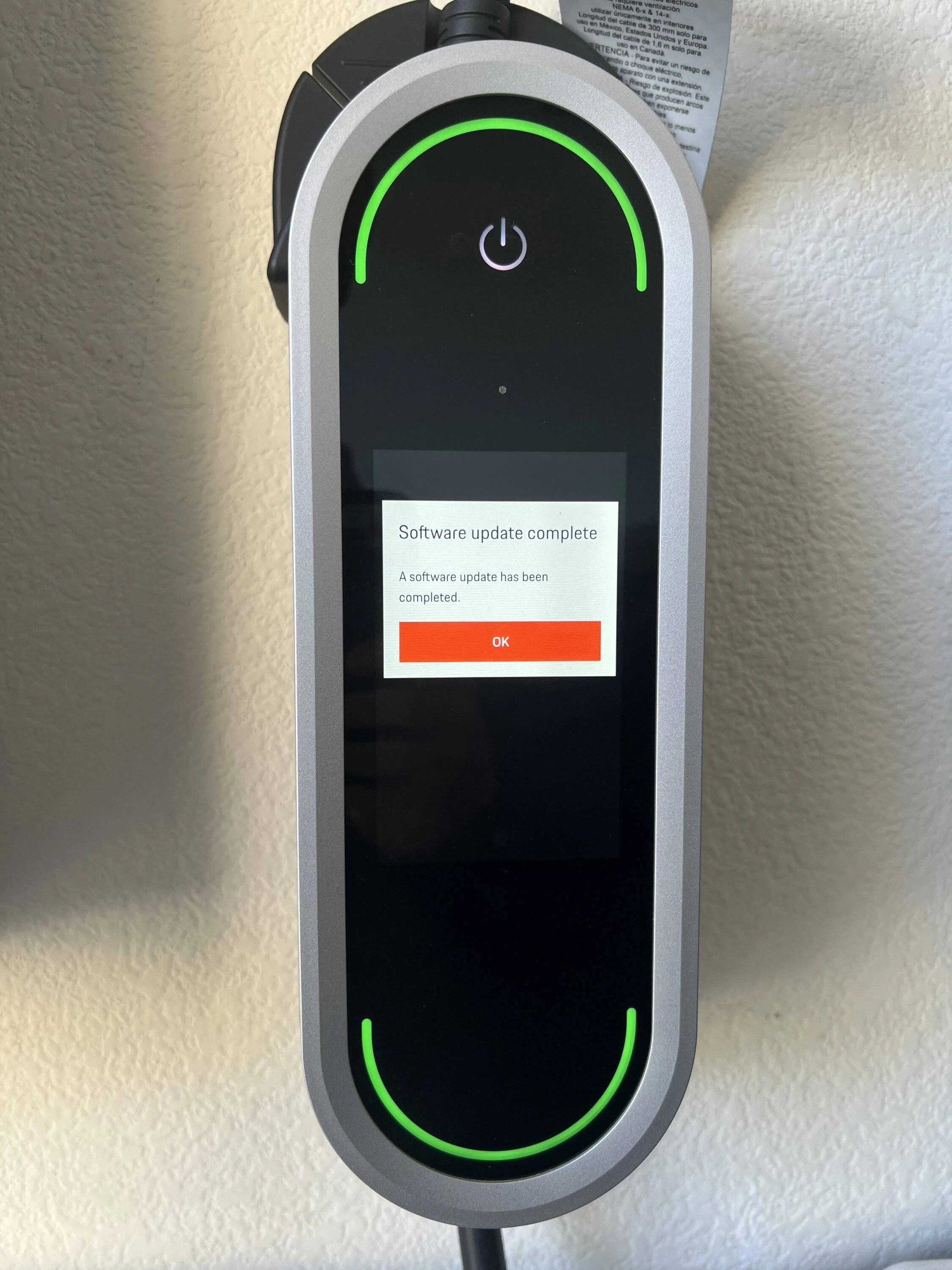

Disabled my WiFi (never used it anyway); did anyone verify if the reboot amperage could be set using the tech login vs the user login?
I just tried this process on my PMCC unit with software version 3014
steps follow:
  • power PMCC unit up
  • wait for startup
  • verify unit is in default 20 amp state
  • verify unit's IP address using network status
  • connect to unit's web portal with "home user" password (tricky to find a webbrowser that will ignore the insecure self signed cert - working around this is another hurdle for the average user)
  • adjust charge rate to 40 amps via PMCC web-portal settings
  • return to unit - plug into vehicle - initiate charging session - verify 40 amp charge rate on PMCC LCD screen
  • terminate charging session with in vehicle charging control
  • unplug charging cord from vehicle
  • verify PMCC charge rate is still at 40 amps
  • power down PMCC unit (I unplugged it from NEMA 14-50 socket)
  • power PMCC unit back up
  • observe that PMCC unit has returned to default 20 amp setting
  • be disappointed
  • repeat process for "customer service" user password via Weportal
  • no joy - PMCC unit returned to default 20 amps after power cycle
  • repeat process via LCD screen settings
I have tried 3 methods to set the unit's charging amps above the default 20 amps - in all 3 cased (LCD settings, web portal home user, web portal customer service user) the setting is temporary and the default 20 amps is restored after a PMCC power cycle.
welcome to your new 4.8 kW EVSE courtesy of Porsche's apparent mastery of OTA updates for their North American EVSE fleet. In it's default configuration Porsche's PMCC will take over 19 hour to fully charge your Taycan if it is nearly empty.
to achieve Porsche specified charge duration of 9.5 hour (see below) - you will need to temporarily adjust your PMCC each time you use it - or purchase an alternate 9.6 kW EVSE from a vendor other than Porsche.

They got me too 😕. If my car chargers to target 85% overnight during low rate hours I don’t care. If not….George is gonna be upset.
steps follow:
  • wait for startup
  • be disappointed
thank you for the diligence on the testing! I guess I’ll be leaving the WiFi and update stuff both off for now. I don’t really use the WiFi link anyway; I changed mine to 30A some time ago and not had any issues with it getting warm. Most of the time 20A wouldn’t be a concern; but I don’t like it being forced on me.

So has anyone here actually installed the update and confirmed that 1) it does change the charging rate to 20A, and 2) whether or not it is changeable post-update? I was also able to interrupt the installation of the new update this morning and have turned off automatic updates for the time being until there's more clarity on what this update does and what options we have post-update.
I installed the update in the US an hour ago
the default is set to 20
you can change charging rate on the device or online from anywhere from 6a to 40a. Note that right after doing the update, turn it off and on, otherwise can’t set the rate on the charge, but can still do online.
Since I prefer charging at 8a (since I charge overnight from maybe 60 to 80 on a daily basis), I don’t care that it defaults at 20.
It would be good if it remembered your preferred default, but for me that is such a trivial issue.
note Also that any changeyou make is only for that session, since the device eventually shuts down and then defaults back to 20.
