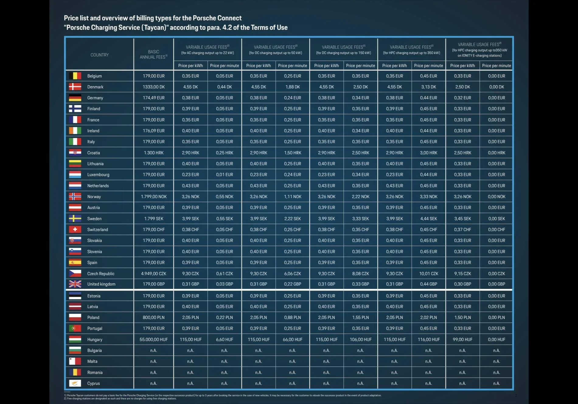

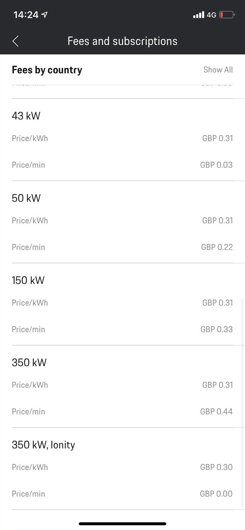

2. Your Ionity charging seems very wrong. You mention you got 100 kWh and the price you paid seems to indicate the same. If you have registered with Porsche Charging service the cost should have been 0.30 GBP per kWh. And you will not have charged 100 kWh in 40 minutes,as your car only charged between 13% and 88%. That would indicate about 65 kWh perhaps. If your battery had been preheated with the help of the navigator to that charger, you should be in an ideal condition to experience a fast charging session of 20 minutes or so. That is assuming you were not sharing a charger with somebody else and Ionity worked as it should. The charging profile for the Taycan on a Fastned Charger 350 kW is enclosed. You can see that the charging throttles to 150 kw quite soon and it is very slow after 80%.
Enclose are also the official Porsche Charging service cost as per January

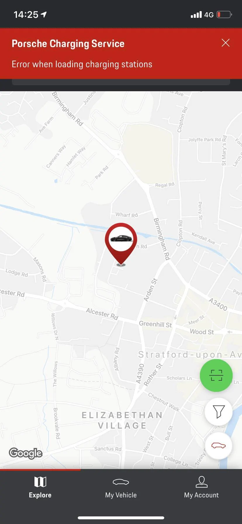

Yes I have registered and waved the card but it didn’t work, also tried to scan on machine, checked app etc.
How do I start the charge? Via App which doesn’t seem to work.
ps will be back at same charger in 46 mins on return Journey, again it’s set in planner, with a 22% arrival. How ever today my cars sat Nav is intermittent and phone charger doesn’t work, also my phone won’t connect to car.
if you click the green symbol on the screen of Porsche Connect, it will bring up a scanner if you allow the app to access the camera. Scan the code on the Ionity charger with that.
This has worked fine for me.

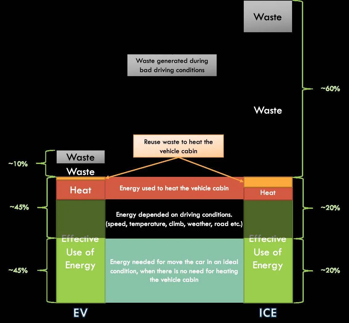

On EVs the range seems to much worse than you are used to with ICEs, probably because you compare the fuel gauge with the SoC/Battery gauge. It's no surprise that in really bad conditions you will experience that the range is cut by half, but with ICE it seems better. I'll try to explain why by the drawing below, where I use bold figures.
If you have two identical cars, beside the drive trains (EV and ICE), you will need the same amount of energy to move the car in equal environment and conditions. To create this energy the EV use its electric drive train and the ICE use the combustion drive train. To be kind, approximately 90% of the stored energy used in the battery are used to move the car, where as 10% is waste under ideal conditions. For ICE this 40% use and 60% waste.
In worst case, in bad conditions, you need to double the energy to move the car the same distance. Since EVs are such more effective than ICEs, it must almost use the double of the stored energy in the battery, than under ideal conditions. For ICEs it's not so noticeable, since it may have to use approximately 20% more petrol.
The ICE have the advantage of better use of waste to heat the cabin, where as EVs are more depended on use stored energy in the battery. Taycan have the heat pump option that will help in that manner, however it's not so powerful since its less waste (energy) to reuse.

First off, you were not charged £67. That is the pre-auth card fee for Ionity. It will change to the actual amount eventually. However, you are going to get charged 69p per kwh for the privilege because you didn't use your Taycan Charge card. Expensive mistake. If the card does not work again, try a different bay.
