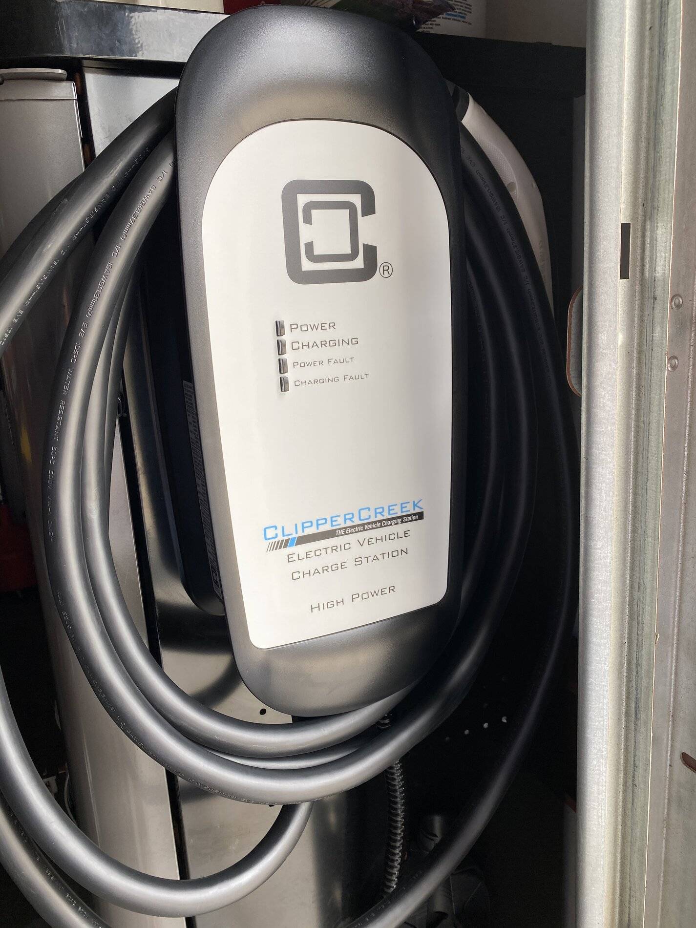

Add me to the list of verifiers. Just installed a ClipperCreek HCS-60 and my car is happily charging at 10.56kW. AND Bonus Points - NO HEAT issues anywhere. Breaker fine, conduit fine, power whip fine, charger cable to car fine. ALL components remain at ambient temps after 45 minutes of charging.
THANK YOU @daveo4EV !!!!!!!

Would love to see your set-up.
Porsche Taycan Observed Behavior: North American 2020 Taycan has max 11 kW L2 charger (48 amps) not max 9.6 kW (40 amps) 883566D4-4813-46A8-A5F9-D2F44EAD4051
It is VERY straightforward. One 3-wire power whip. Wire nut on the common. Done! Swapped the 50-amp breaker for a 60-amp breaker. Already had 6AWG in the conduit. Total 30 minutes to swap from 14-50/50 amp breaker to 60-amp setup.

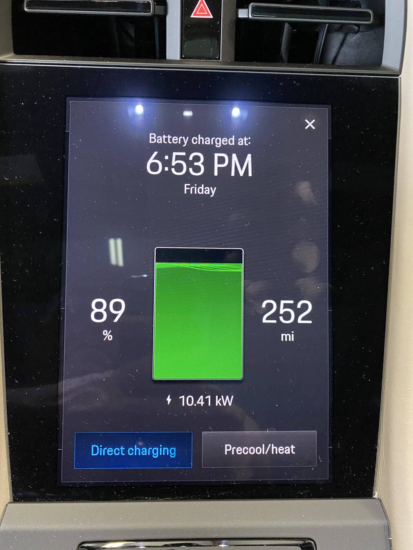

Can you set any charging parameters with the Clipper Creek or are the charging profiles within the vehicle and the Clipper creek follows them?
Porsche recommends not charging beyond 85% for day to day charging. Are you in “Direct Charge” mode every time you plug in and it charges to 100%?

The picture shows that he is in direct charging mode. The car will therefore ignore profiles and charge to 100%

If you want to charge at 48A, you need a 60A circuit, and the charger will need to be hard-wired, as there are no residential outlets that are rated for more than 40A continuous (like a 14-50).
You can get a charger like the Clipper Creek pictured above, or any other charger for a 60A circuit and then have your electrician wire it all up.
