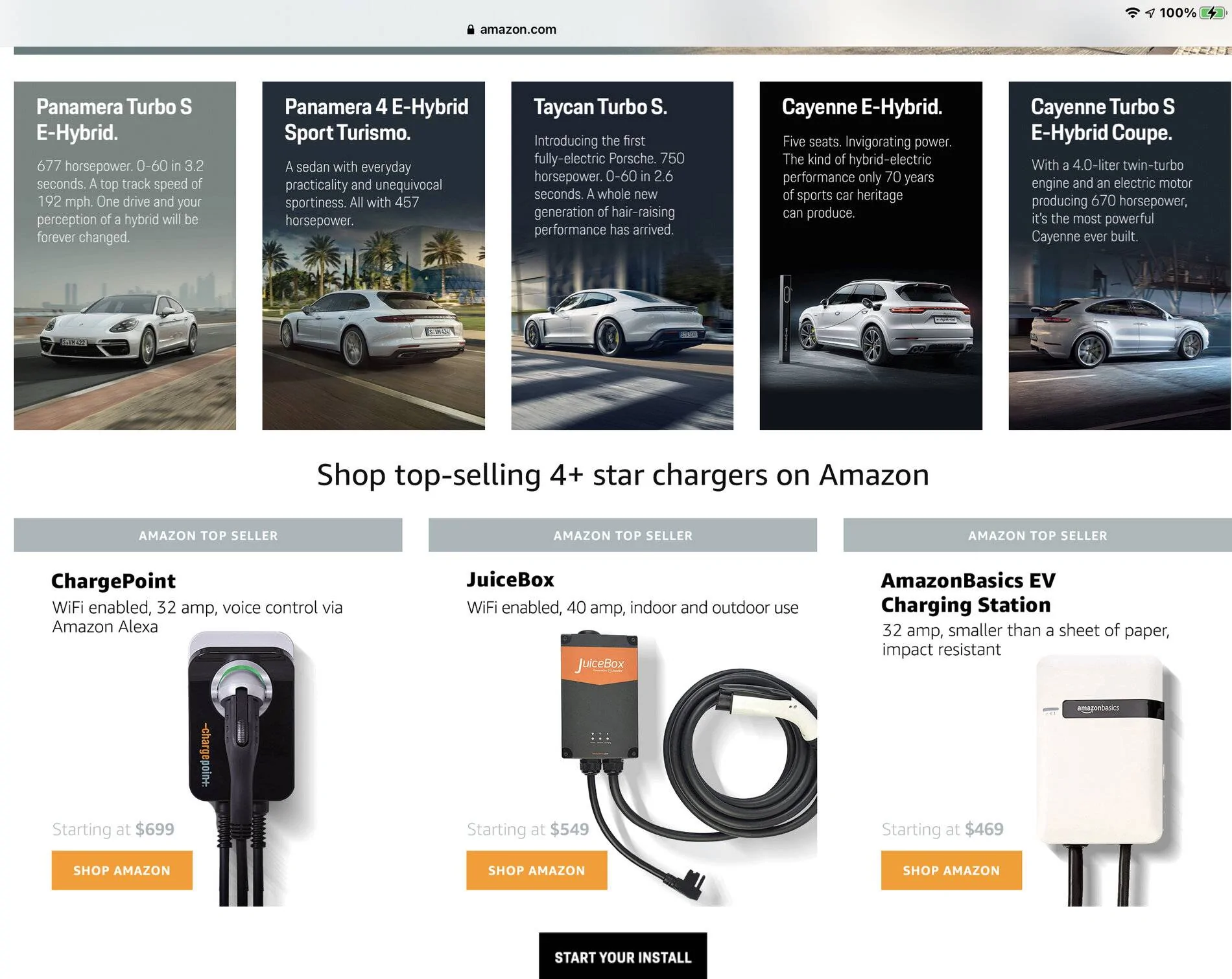

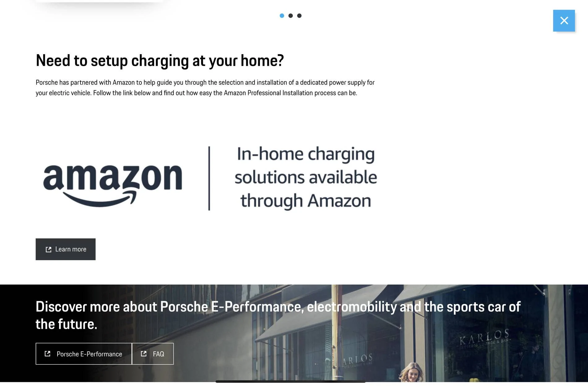

Porsche‘s own website recomends using Amazon to install your Ev charging equipment:
https://www.porsche.com/usa/models/taycan/taycan-models/#charging~open
Porsche Taycan Observed Behavior: North American 2020 Taycan has max 11 kW L2 charger (48 amps) not max 9.6 kW (40 amps) F7B26AF3-F883-4132-AAF4-6CD1996E81F1
the amazon website the Porsche USA directs you to:
https://www.amazon.com/porschecharging
does not list or sell any Porsche branded EVSEs see photo below from the site
Porsche Taycan Observed Behavior: North American 2020 Taycan has max 11 kW L2 charger (48 amps) not max 9.6 kW (40 amps) 035E9DC2-E5DA-4F64-86BB-17D5E50DA3A0
the pure stupidity of the response you have receieve from Porsche and the pure lack of thought or understanding about EVs is what i hate about the existing manufacturers doing EV’s - I’ve gotten similar BS from my other EV vendors: Ford, Chevy, and now Porsche - they simply don’t understand and you asked an organization optmized to support gas cars to render a thoughtful opinion about something they clearly do not understand.
my Chevy dealer gave me the same BS when I bought my 1st Bolt - when I asked about the included EVSE with the Bolt - which is only a 12 amp 120 volt charger. He said you can only use the Chevy provided charger. I pointed out to him it would take nearly 70 hours to charge the car using the Chevy provided charger but the chevy specs said the vehicle could be charged in less than 8 hours at 7.68 kW. He then told me that is only the case with “fast chargers” not home chargers and I might damage the Bolt if I used a non-Chevy home charger. when I pointed out fast chargers are 50,000 watts and the Chevy site documentes a 7,680 watt L2 charging rate, and the provided Chevy charger only does 1,440 watts - he had no repsonse, because he was clueless and wrong.
Porsche’s own north american website directs you to a vendor that will recommend non-Porsche EV charging hardware be installed.

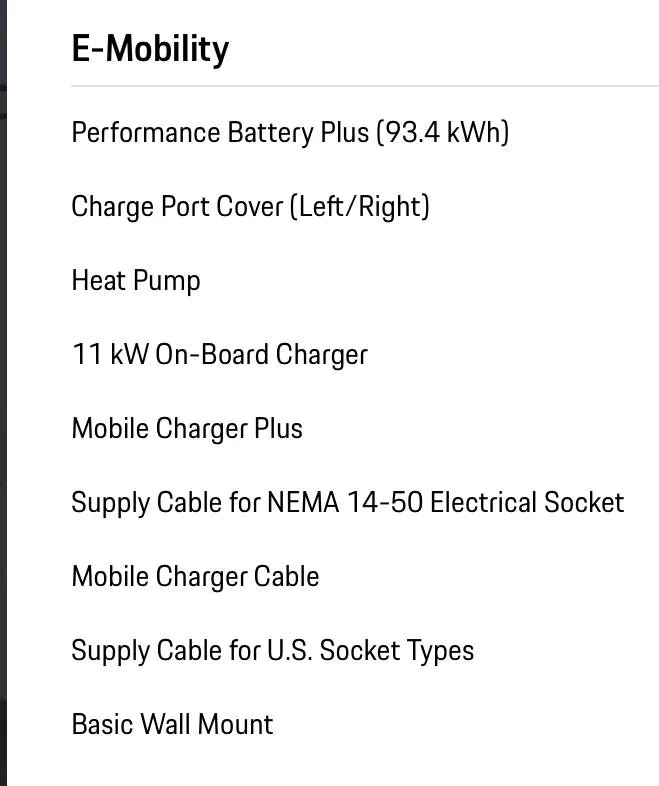

hey porsche finally updated the Standard Equipment for North American Taycan to note "correctly" that the onboard charger is 11 kW!!!!!
OMG it only took them 3 years!!!!
note the screen shot I took this morning for standard equipment for a Taycan
11 kW Onboard Charger!!!!
Porsche Taycan Observed Behavior: North American 2020 Taycan has max 11 kW L2 charger (48 amps) not max 9.6 kW (40 amps) IMG_1718

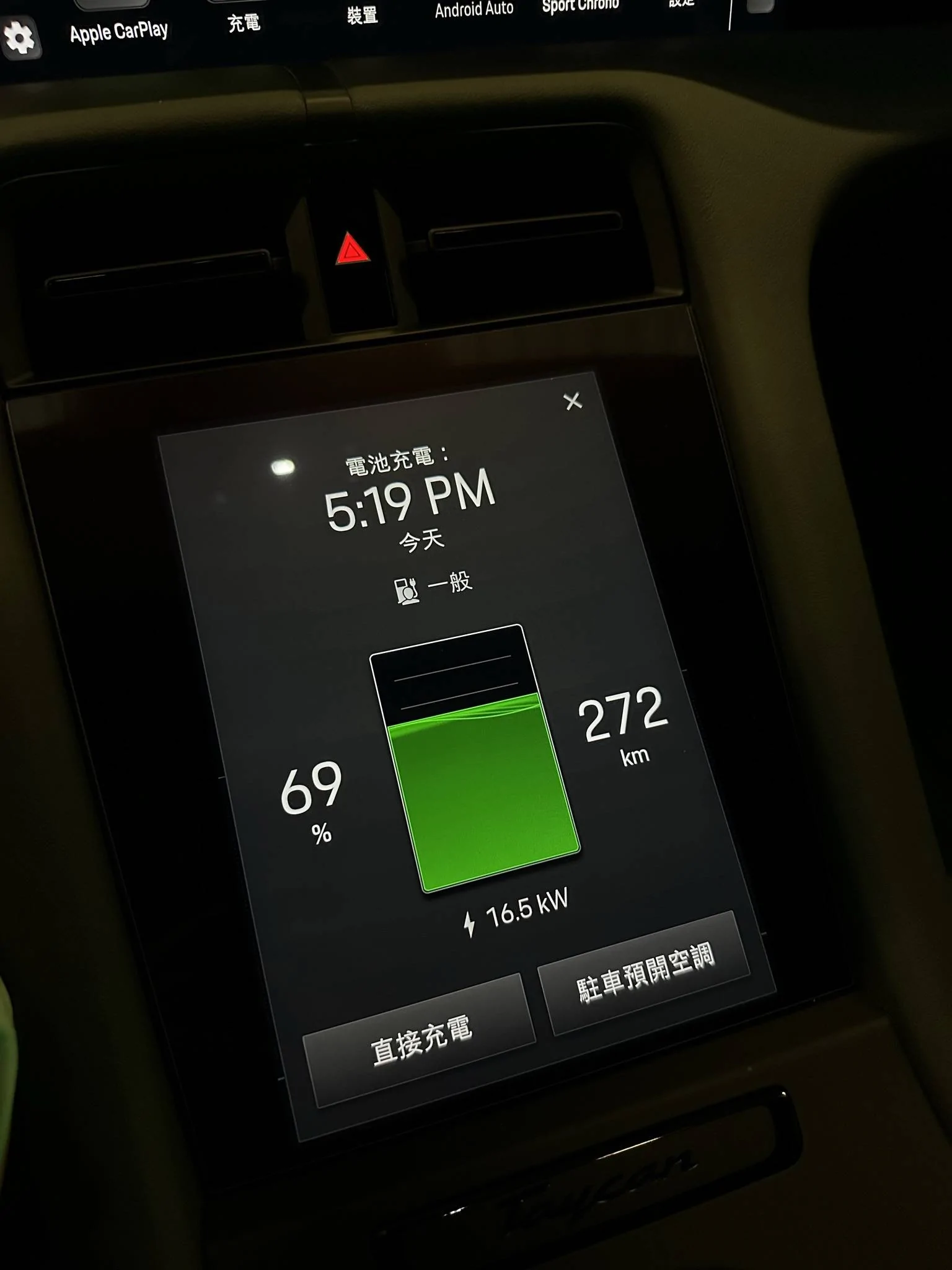

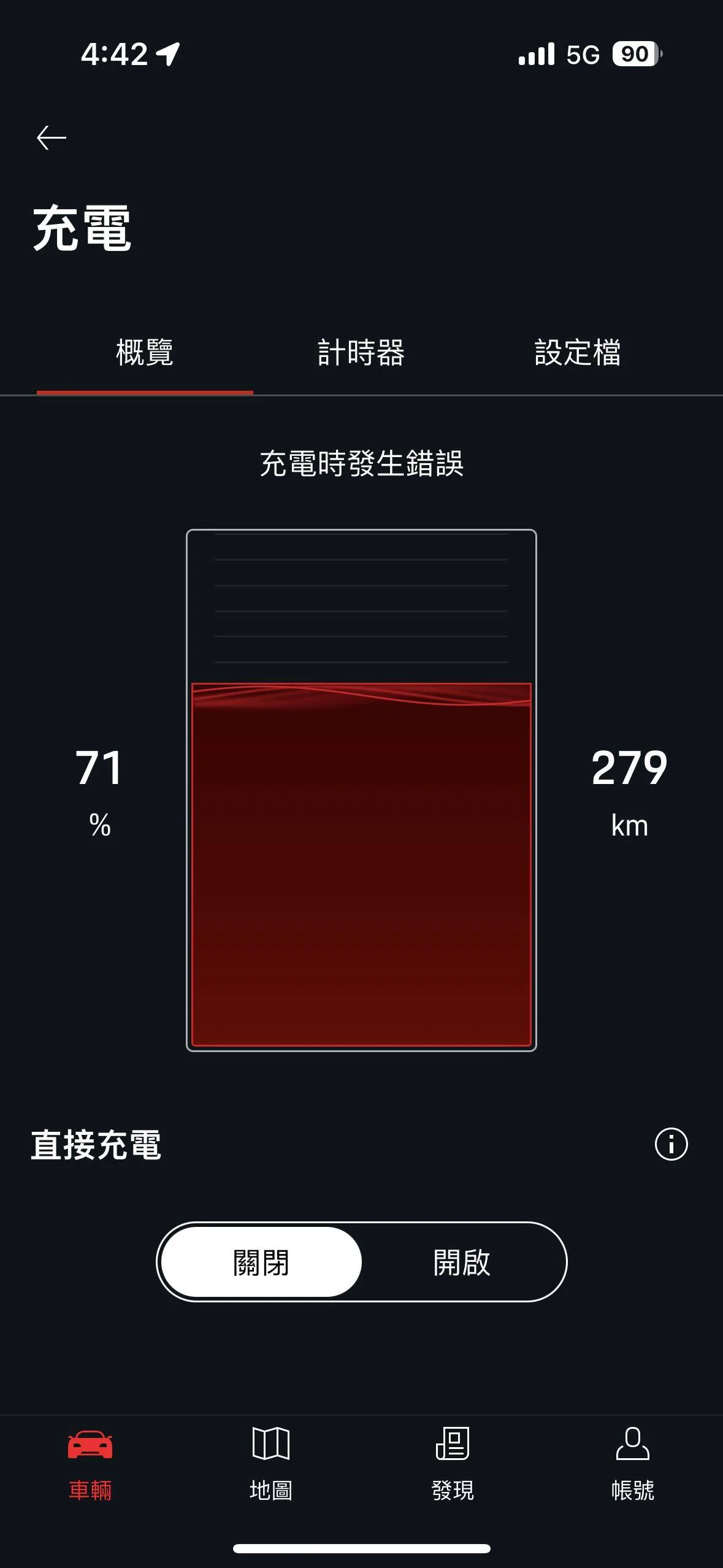

Hi Dave,
Did you know the maxaium Kw AC charger we can use?
Because I use 220v/80A charger in the public parking, will always get failed messager after 10 mins.
My Taycan is MT23, equip with 22 kW AC converter should be okay for 17Kw charger I think....

Hi Dave,
I'm onlly familiar with North American stuff - but this appears to be a faulty EV charger that you're using at your location - or have the dealer check out the onboard charger for your vehicle, but I know very little about charging outside North America - sorry.
I think I found the root casue, Taycan only support 11 Kw AC with 2 phase.
Which means 220V/50A.
If you want reach faster AC charging you will need 3 pahse for example (32A/220V or 16A/220V)
