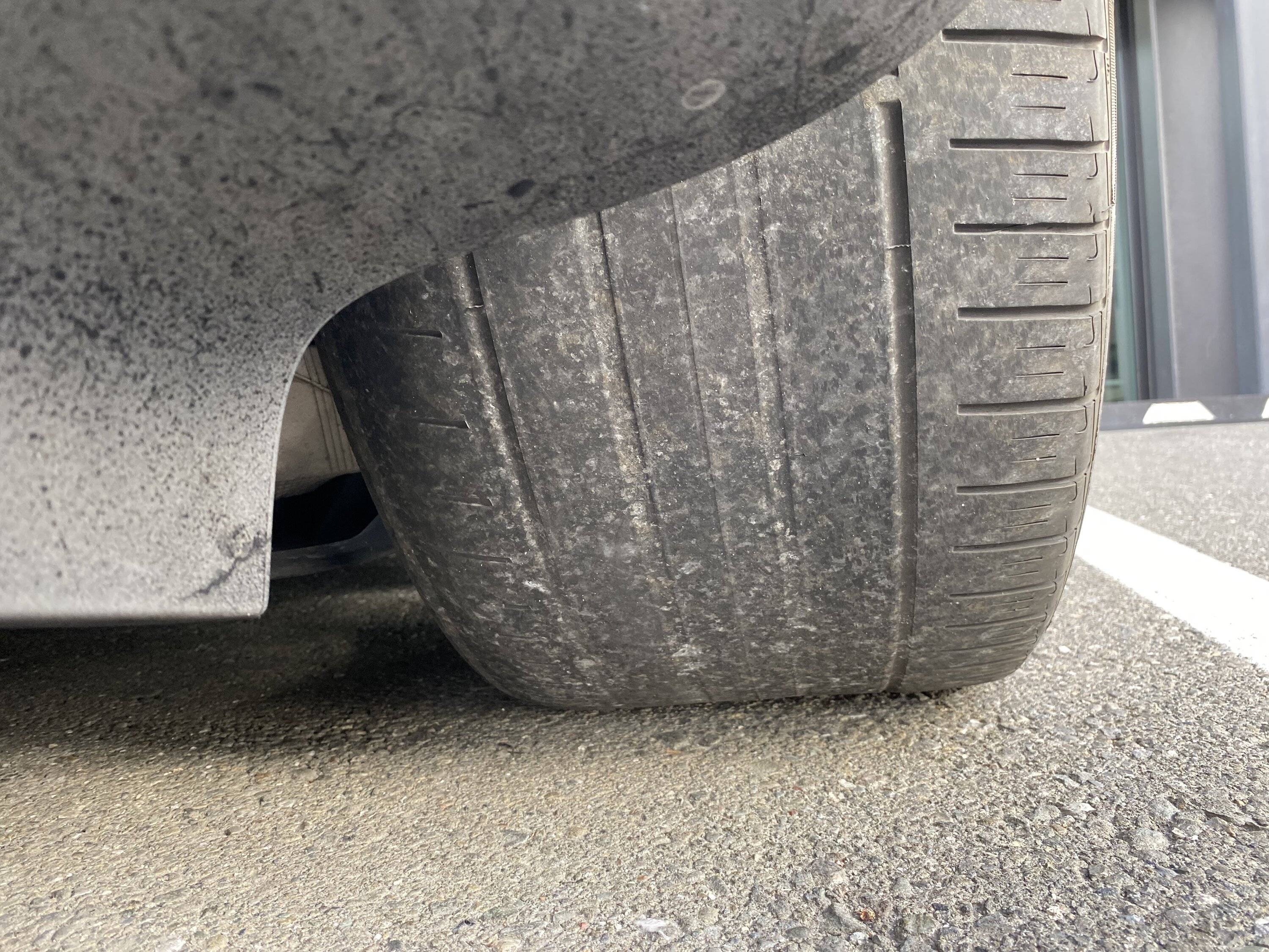

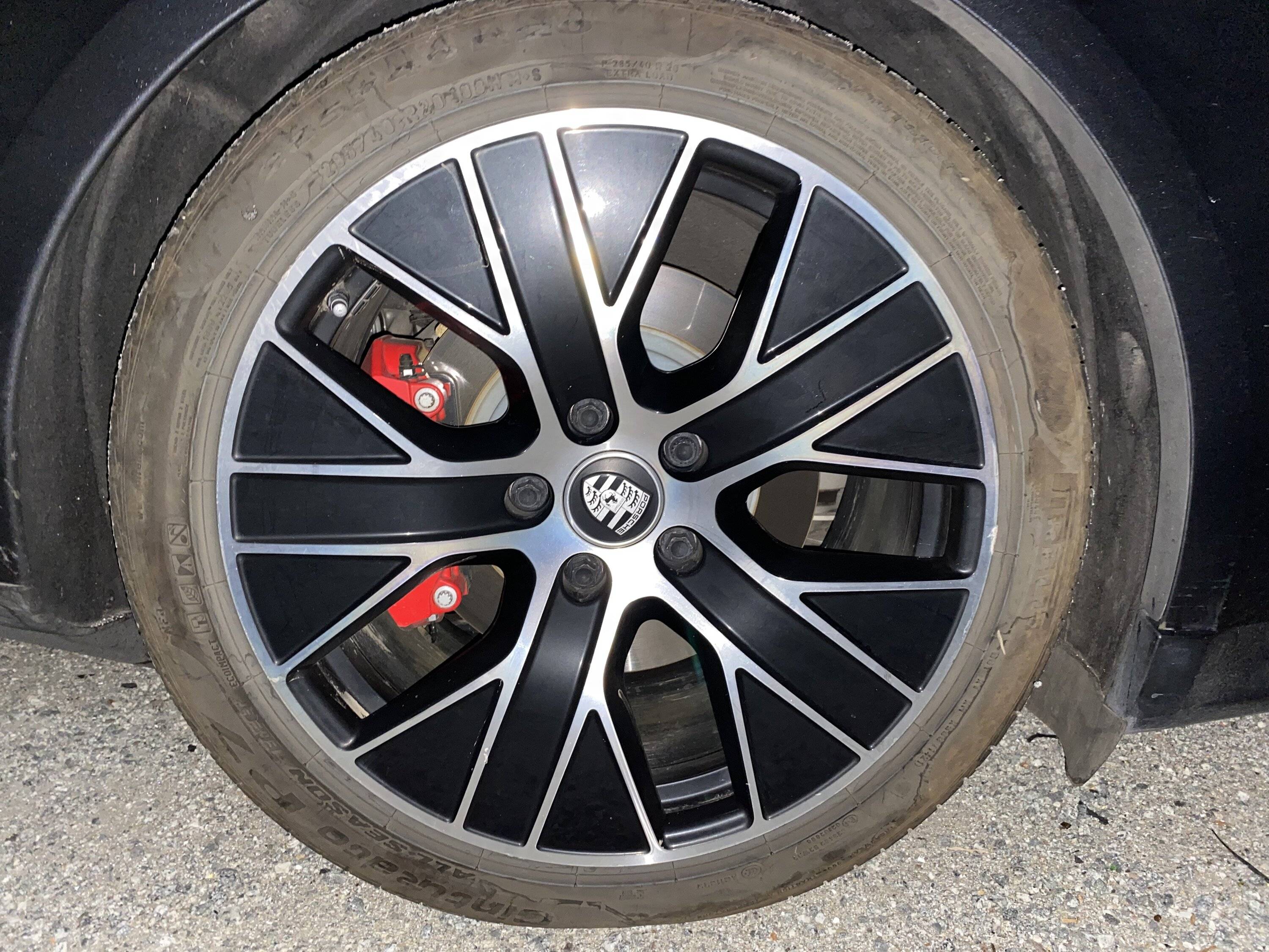

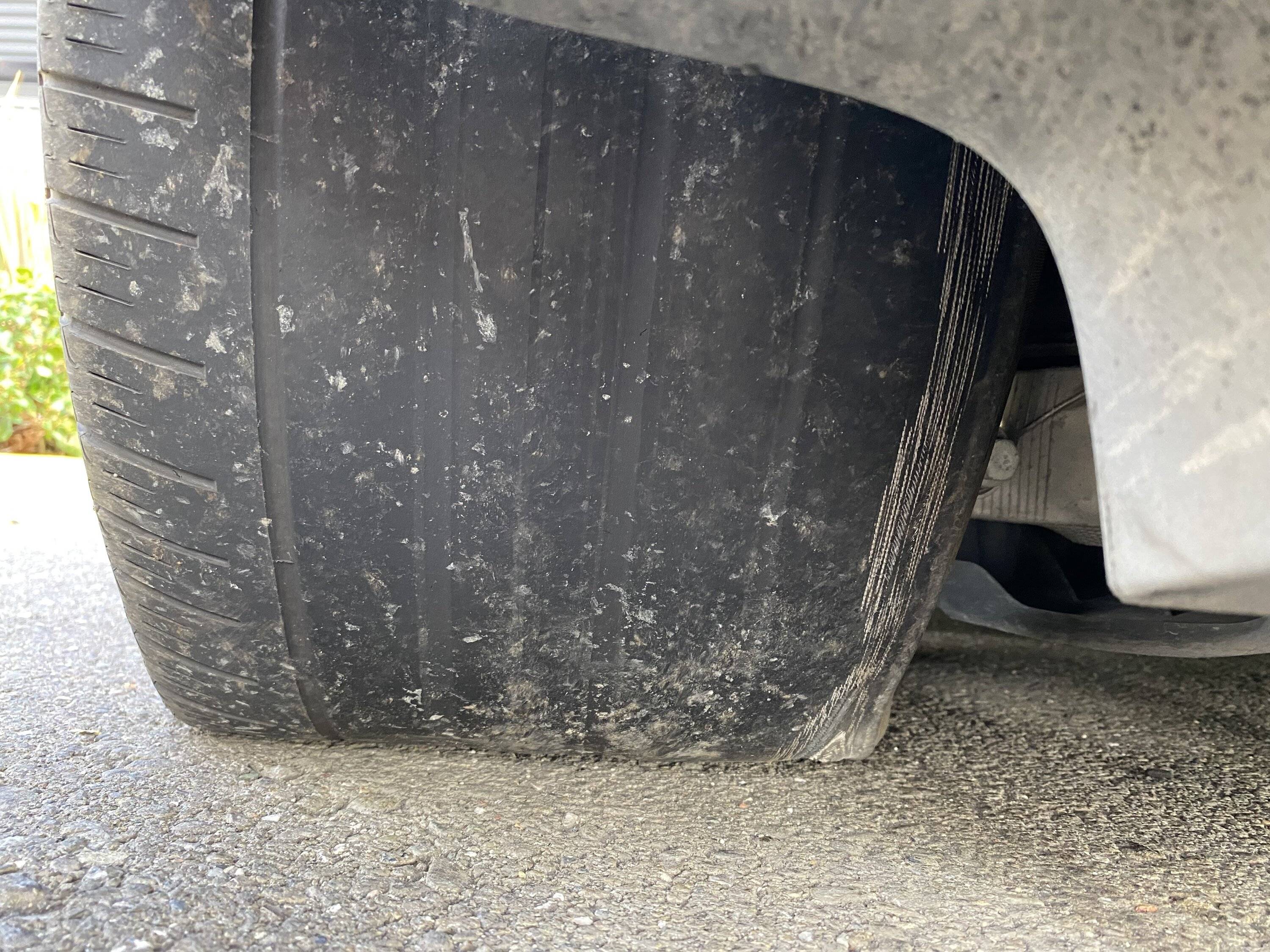

I had my rear tires fail on my Taycan 4S after only 13K. My first set (Continental 20" AS) got about 28k and wore reasonably evenly, the replacements. I got this set in April are the Pirelli Cinturato P7 All Season and at only 13K I had a core and a blowout on the rear trying to nurse back to bay area.
Others seen this kind of excessive wear to the rears? My service department has no comment yet.
lots of negative camber, lots of weight, lots of power equals tires that get eaten like pop-corn
I'd have some camber taken out (at the expense of some handling) so at least the tire wears more evenly.

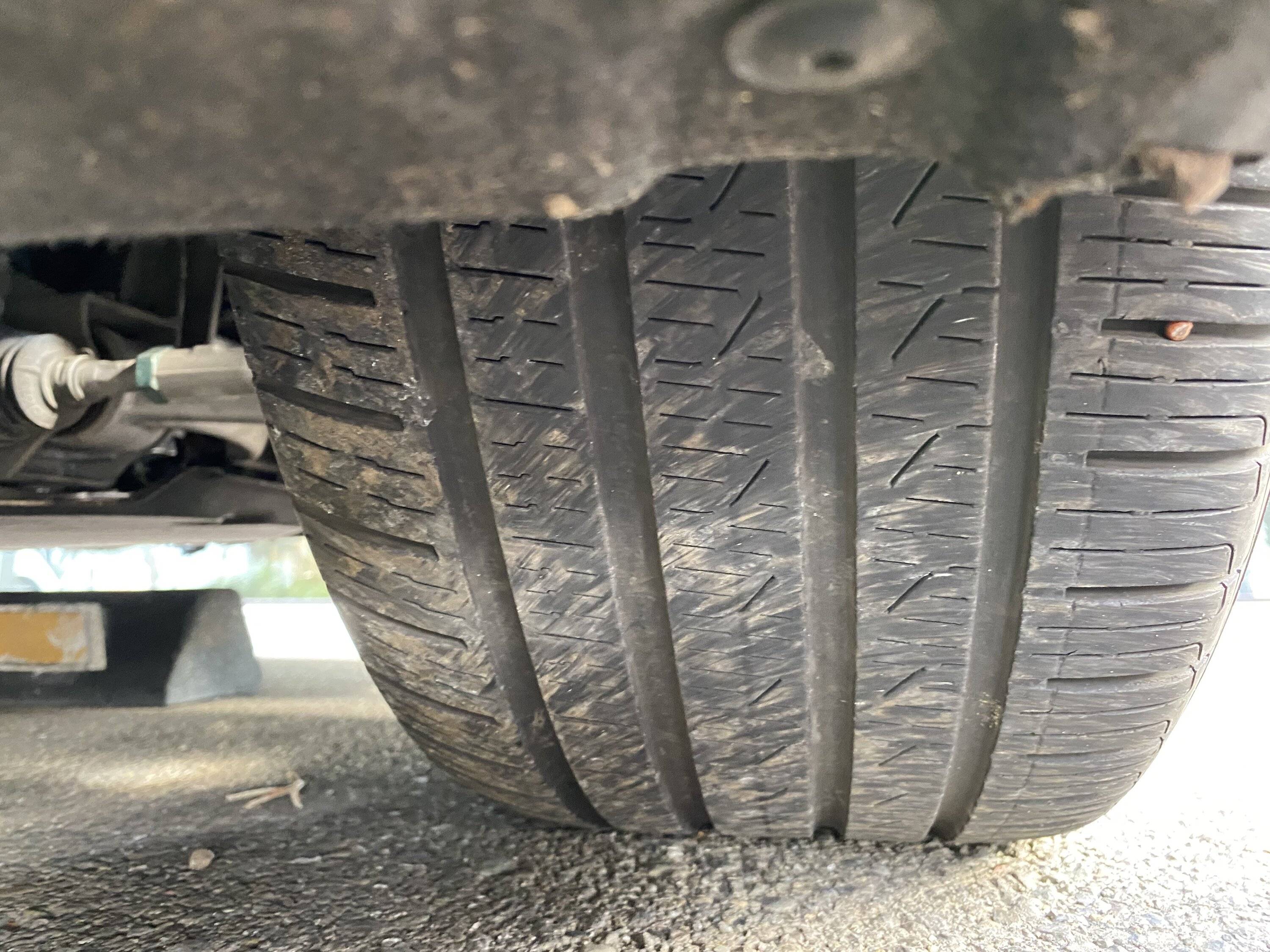

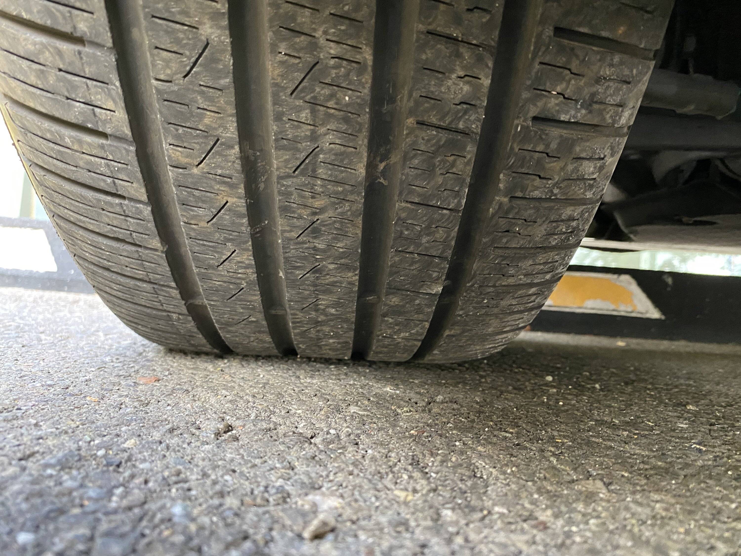

Camber affects where the wear occurs and toe affects how much wear occurs. IMO, your rear camber looks fine. Rear left and front right looks like are wearing way more than rear right and front left.
Out of curiosity, are there a lot of clover leaf ramps where you live and are you taking these cloverleaves in a spirited manner?
Given that the Taycan should be close to 50/50 on weight distribution and given that it's AWD, you should be getting pretty even wear on all 4 tires. More on the front if you tend to take turns spiritly and rears more if you like to feel the acceleration.
My recommendation would be to get the rear toes settings checked. I'd recommend getting the dealer to set the rear toe to zero or at least closer to zero.

Thank you Sherman, I agree with your suggestion. I didn’t do much spirited cornering, my other half is non-spirited and usually with me for longer travels which was the majority of the miles.

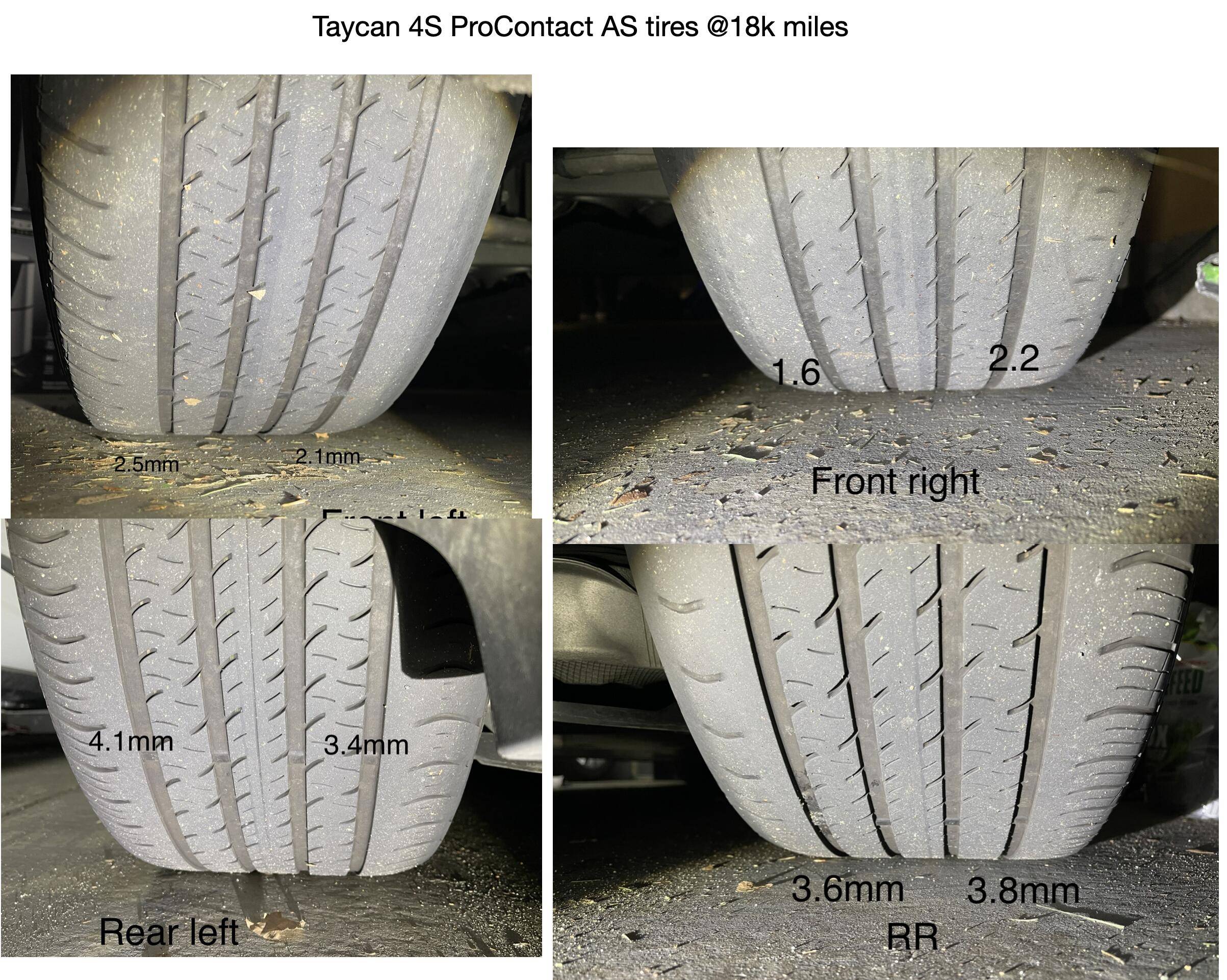

I'll add to the thread with my data points. This is after 18k miles of daily med-hard driving, biweekly mountain runs in Northern California (Highway 9). The inside is consistently wearing faster than outside just like everyone else. I measured the treads remaining for your reference.
I plan to keep track of this with the Michelin PS4's I'm getting soon.
