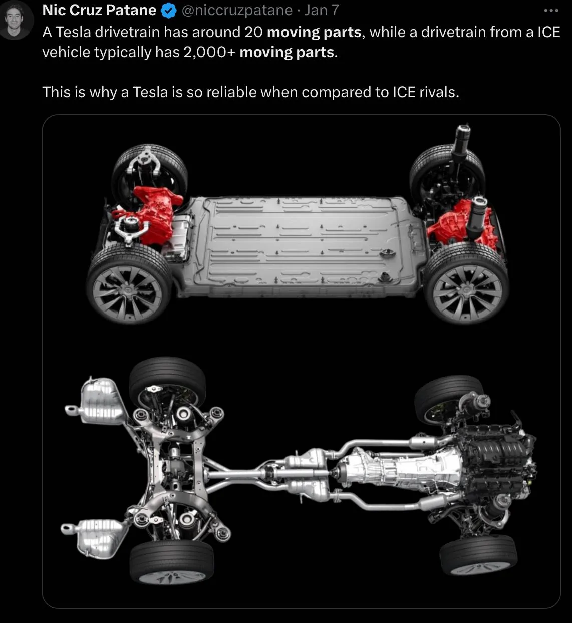

If this guy is vaguely correct:
20 moving parts in Tesla drivetrain
2000+ moving parts in typical ICE vehicle drivetrain
… I wonder how many in a Taycan drivetrain.
I bet, given the service bills (first year, Tesla: £0, Taycan £400-£1500 depending on OPC appetite/attitude) that a Taycan is a fair way up that scale.
Sometimes, especially when the software in my Taycan fails for the n+1th time, I just wish Porsche had hired 10 people from Tesla to sort out the tech and keep the engineering simple; and left the rest of their team to focus on sustaining the incredibly good road handling.
Porsche Taycan # of moving parts in EV vs ICE IMG_1686

All EVs have a small amount of moving parts and depends on the configuration / options added when it comes to the Taycan.
Once upon a fairy tale we all assumed less parts less servicing less cost....that ain't true as dealerships have an infrastructure to protect.

This is a recurring internet claim, and one that is deeply logically challenged.
First, electric cars have thousands and thousands of parts...just like gasoline cars. Most of the parts are nearly the same (or exactly the same). Seats, tires, windows, motors and sensors (I mean the motors that do things like move seats, windows, wipers, etc.)
The big difference is the drivetrain and fueling system (where the "fuel" is electrical energy for one, and chemical for the other). For both of these types of cars there are lots and lots of parts.
And, stay with me now, they all move. It's a car. Some move within the car, some move along with the car, some move when touched or activated.
If you think there aren't moving parts in an EV, see this video of the dis-assembly of a 2012 Tesla Model S motor.
Move ahead a decade, and here's Elon Musk bragging about a Tesla S Plaid motor in 2022, in which he talks about such things as "sleeves" and "rotors." and three different motors (each of which have their own set of parts), and torque vectoring and adaptive suspension and regenerative braking. He notes, with considerable price, that the overwrap for the main motor has to hold the rotor together when it spins very fast. That torque vectoring and adaptive suspension and regenerative braking all add additional moving parts, as well as performance.
Those brakes are worth discussing. ICE and EVs typically have four tires, and four sets of brakes. Each set of brakes has its own set of parts--whether there is an ICE engine or a electric motor pushing the drivetrain. Lots of parts.
Here is Tesla's parts catalog online, for one part of one subassembly for just one wheel:
https://epc.tesla.com/en-US/catalog...tegories/8e8db24b-4c2f-4900-ac05-2cbe08f716e5
I counted 22 listed parts for just one portion of one brake system (it was the rear brake). Some parts can be purchased in "assembly", so one can't tell exactly how many individual items are in this group of parts, at least from the online catalog. But it is more than a few, and this is just one part of one of the four brakes.
The Tesla Model S Plaid is indeed very impressive. But it is not a car with "20 moving parts," or 200 for that matter.

I’m not sure what your confusion is, but the original post specifically said drivetrain. It didn’t appear to be trying to hide anything, which is what your response seems to suggest.
And there’s a huge difference between “parts” and “moving parts”.
Parts that don’t move (and no, they aren’t “moving” just because the car is moving🙄) are not going wear, or at least not at the rate as moving parts.
And what “moving parts” do you think regen braking adds…?
I’m having discussions right now at work regarding the preference (mine) for solidstate (triac) outputs vs relay (electromechanical) outputs. Why? Because as long as your don’t overload them, the solidstate outputs will last decades. The electromechanical ones? Not so much. And which part do you think fails? The electrical or the mechanical? Actually, to be fair, arcing is a common failure, especially with inductive loads without surge suppression, and one might consider that an “electrical failure”, but the failure is really that it stops moving.
Regarding the drivetrain, electric motors (if not subject to damage from overloading/heat), will last a very, very long time.
That said, the battery is a more complex energy storage than a gas tank. Charging is more complex task than filling a gas tank.

(Wading in) while I agree that purely mechanical systems have to contend with “wear”, i still find it disingenuous to compare the number of moving parts as the sole indicator of reliability or longevity. On the electric side, capacitors explode, soldering fails, repeated heating/cooling causes brittleness..
On the IC side: an engine may comprise thousands of parts - not all of them are moving, and just because they’re moving it doesn’t mean they can’t last for decades/millions of miles driven. The same “moving”/friction aspect is also what makes mechanical assemblies fairly resilient (not to mention the ease of servicing).
The comparison is a nice tidbit, but its usefulness is limited to depicting how vastly different two solutions can be - it’s not necessarily an indicator of quality.
I agree, but all other things equal, non-moving will last longer/have less issues than moving. Everything else is not equal though; as I made point about energy storage and refilling being more complex in an EV vs ICE. Refilling specifically, it’s difference of active vs passive. It’s a passive system in an ICE vehicle and it’s active in an EV. Passive is preferred to active, all other things equal.
Yes, other components can fail, but I don’t think it’s typical if things are kept in operating temps and not overloaded to create excessive heat. At least, thats been my experience.
Agree, but I have to service my ICE vehicle more frequently, and this is a theme of things with moving parts, they need both more (quantity) and more frequent service to be kept in operation. I see this service need dichotomy play out in industrial machinery with different equipment designs that serve the same function.
I’m not sure I follow this one.
Yes and no; comparing one individual part of two different systems doesn’t tell you which one is better as a whole. But it still has its utility.

As a mechanical engineer who worked on the design and running of Formula 1 racing cars for my whole career I really appreciate the mechanical simplicity of EV running gear.
In an IC engined car not only are there a lot of parts but quite a lot of them run hot enough to damage their own lubricant which needs filtering and frequent replacement.
The power bandwidth is so narrow a multi-ratio gearbox is needed to match road speed to usable engine speed.
The engine produces zero torque when stopped so it also needs some sort of clutch.
I don't think we know yet how much more reliable than an IC engine and transmission EV components will be.
I would not be surprised if it were 5 to 10 times better.
The maintenance and service will likely be more on the battery than running gear.

Since no one completed this, let me tell you a little secret. Recuperating energy in an EV doesn't require gears or generators or anything special or extra.
If you apply electrical current to a motor it spins. If you spin an electrical motor it generates electricity. It's a bit more complicated than that, but "adding regen" is very simple.
