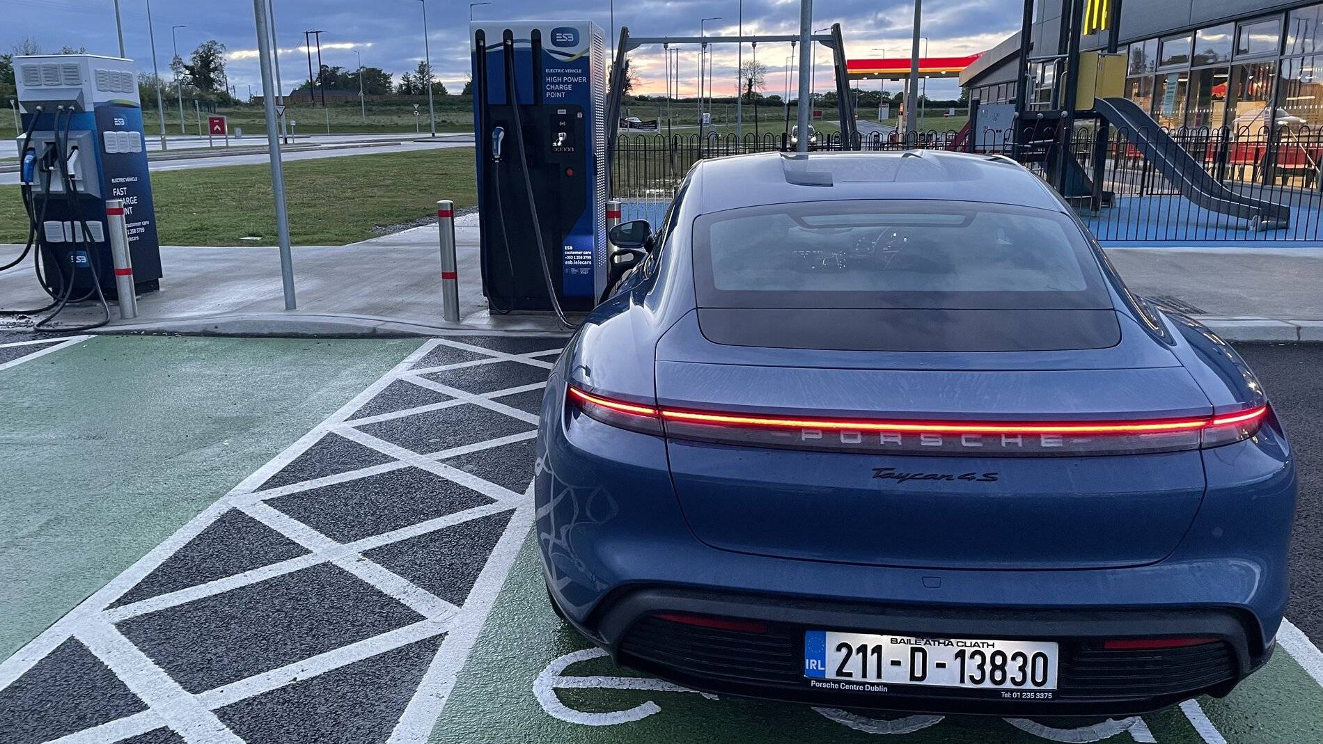

This is a picture of a 400V 150KW DC charger that are popular in Ireland - where picking this option makes a lot of sense. Honestly, given that its just a €350 option and a lot of buyers are confused, they should just include it. But this is Porsche we're talking about here :)
Porsche Taycan On-Board 150 kW/400V DC Charger IMG_0158
