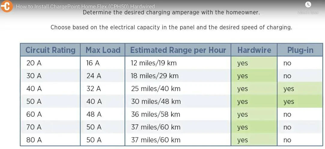

.................. I don’t know of an EVSE which goes to 45 amps: they seem to be 40 amps (9.6kw) or 80 amps.
ChargePoint's (variable amerage) HomeFlex hard wired installation does and it's 48A delivered for a 60 amp breaker:
+1
ChargePoint seems to be the best option if you want the full 11.5kw. I have two of them and that would be my recommendation. Also, getting a 100A+ circuit in your home is not practical. 60A is doable.
