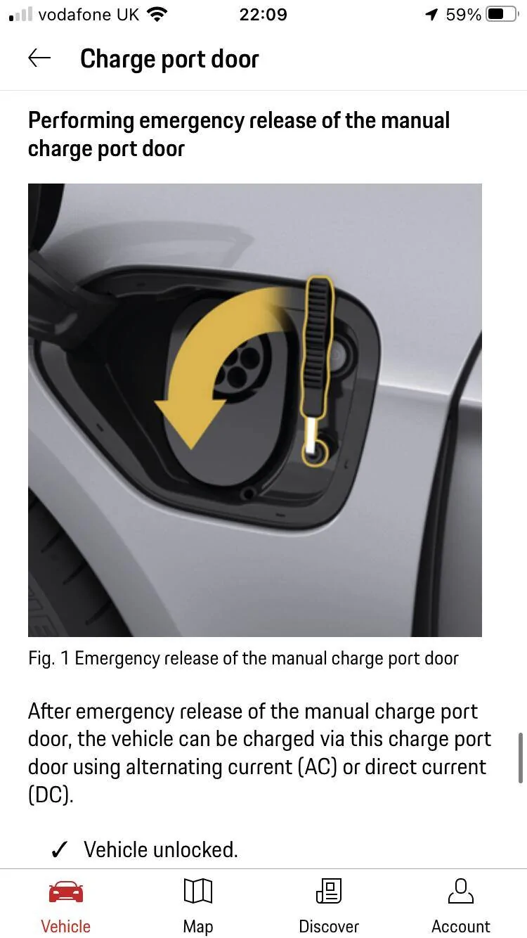

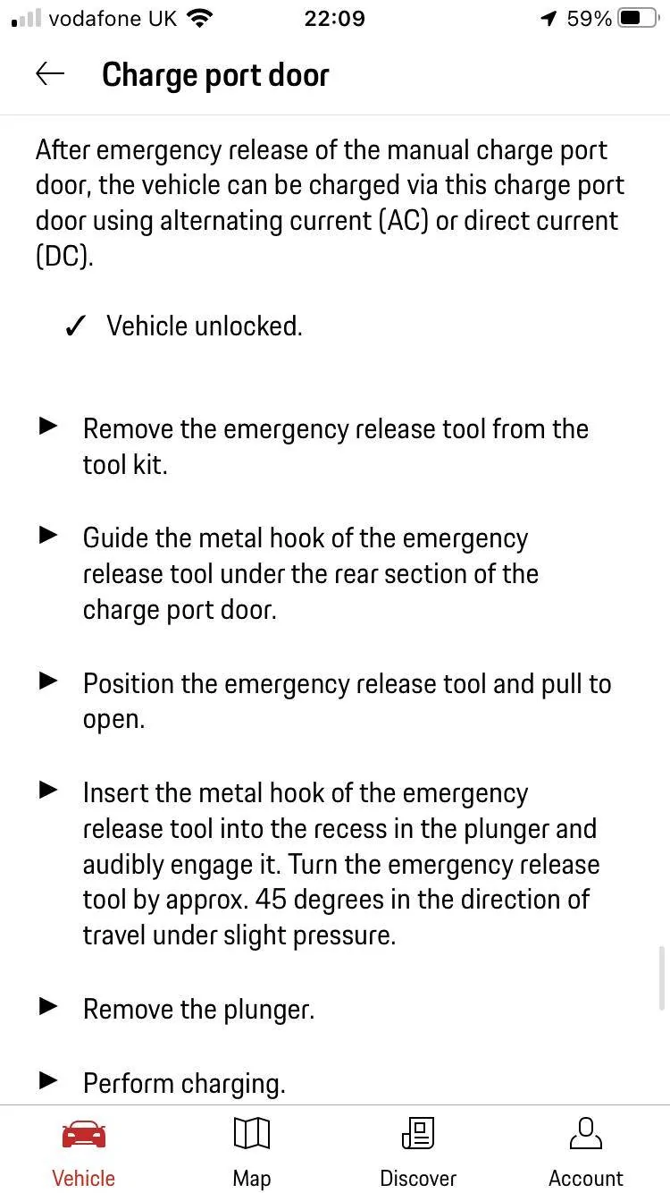

(just to eliminate the obvious) is the other port closed completely? Upon opening a port, the car locks the port on the opposite side.
