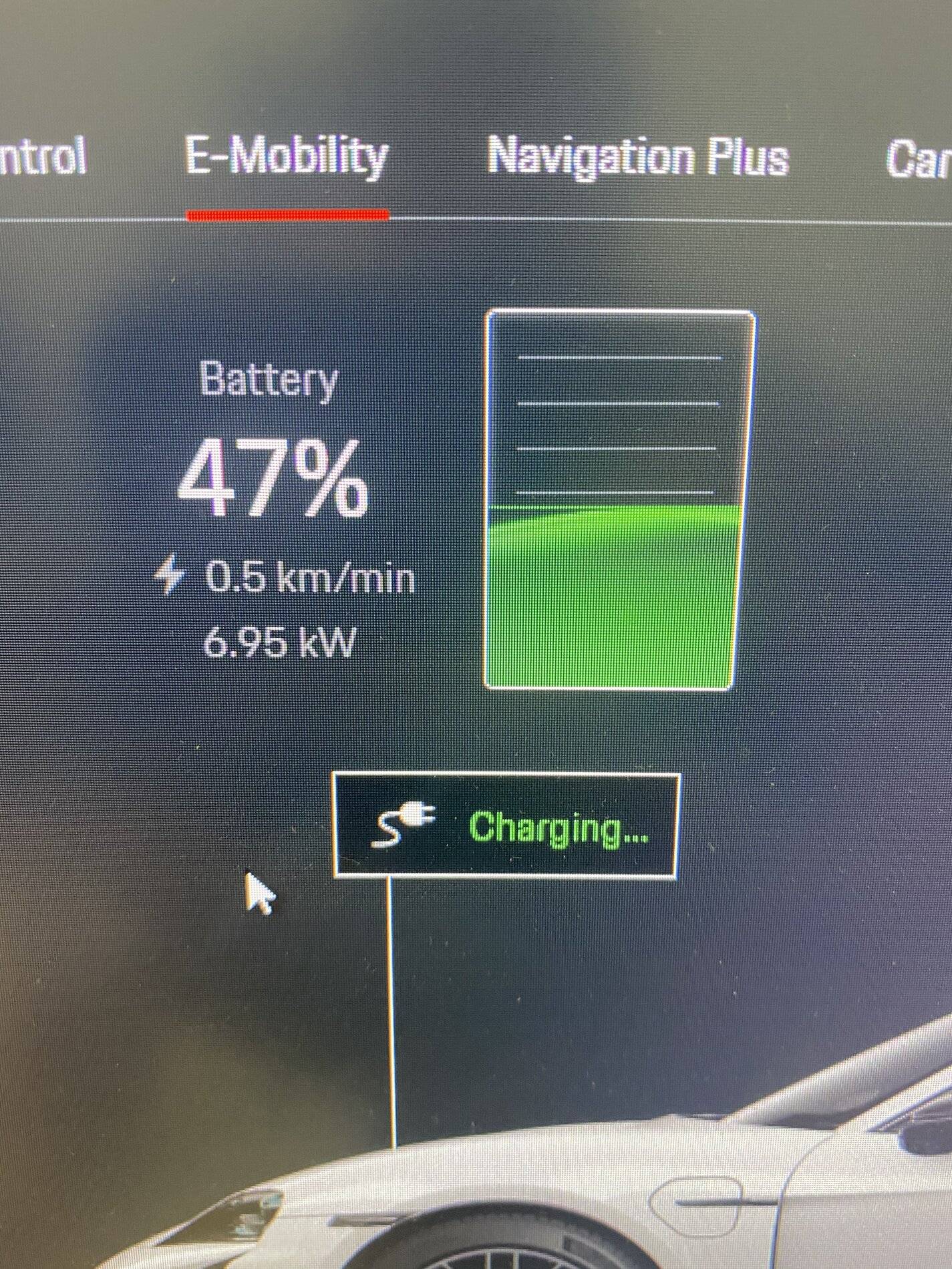

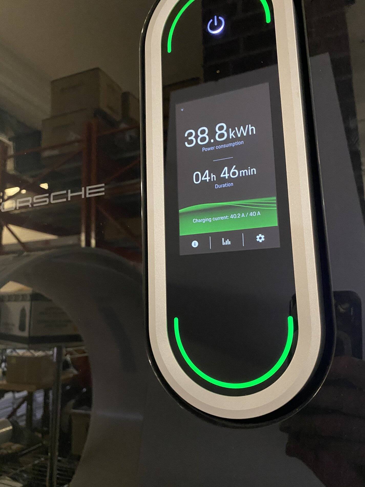

Only getting around 7kw of charging. I have it connected to a 50amp 240 circuit, charger reads 40.2amps. Shouldn’t this be closer to 9.6kw?

Yes it is set for 40amps and showing 40.2 on the pmcc, it is 20C in our loading bay of 4000 sq ft where it is charging in my shop

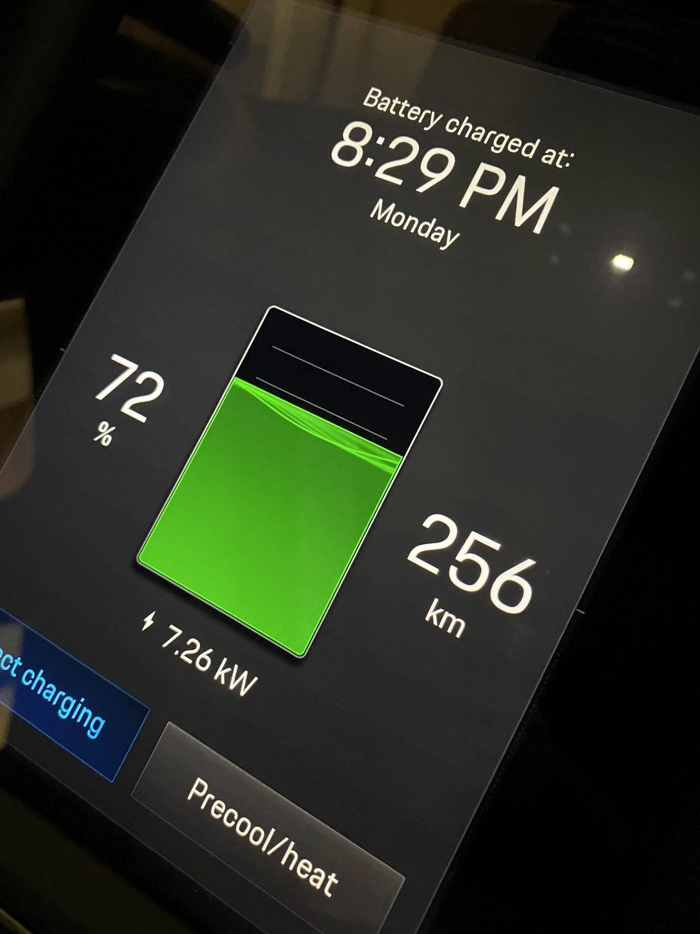

Those were taken at the same time, it’s pretty much as high as it goes
