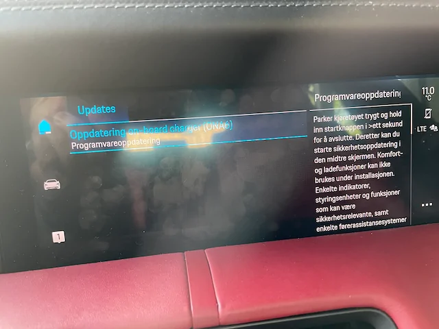

My ONA6 update does not start. I received following messages:
It seems that the update is available.

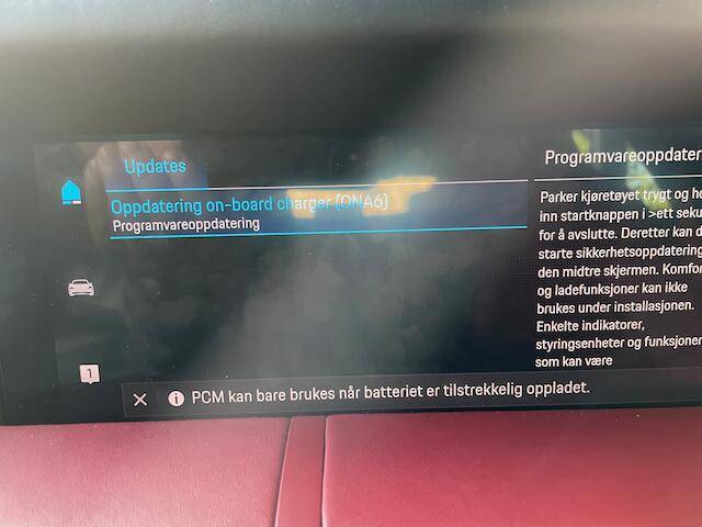

When I put det Taycan in P and holding in the start button > 1s, I received the following message:
The PCM can only be used when the battery is sufficiently charged
BTW the cars SoC is above 90%

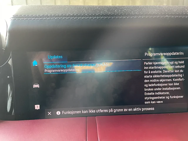

When I clicked on ONA6 to start the update process, I received the following message:
The function cannot be performed due to active process
Porsche Taycan OTA ONA6 failed to update IMG_3723
I have tried to update three days in a row. To day I also experience an error message in the My Porsche app, which said
Something went wrong: The function cannot be performed at this time. Please try again or contact Porsche Connect Support.
Porsche Taycan OTA ONA6 failed to update IMG_3720
I have a MY20.
Have anyone experienced this, and found a fix?

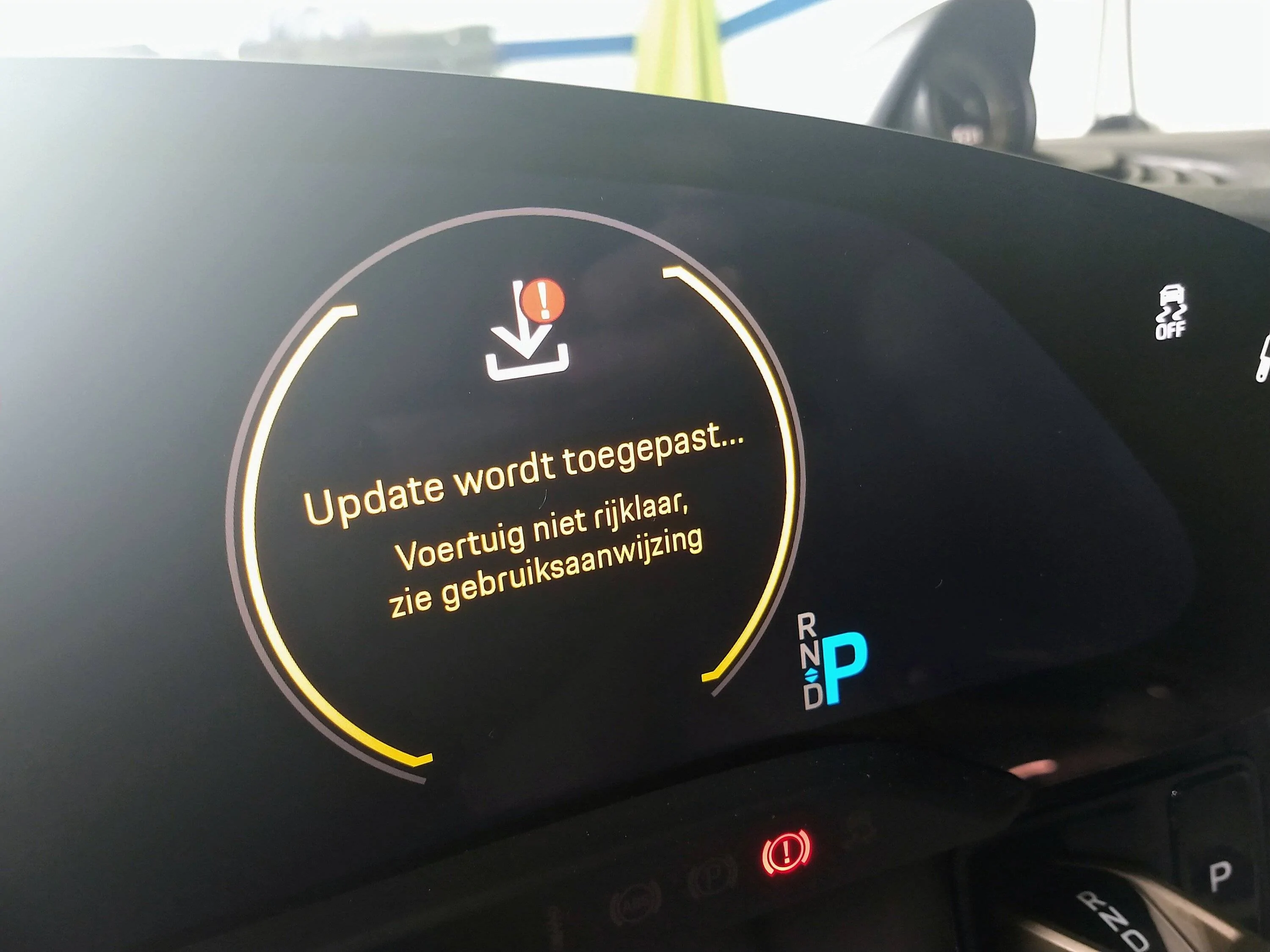

Porsche Taycan OTA ONA6 failed to update IMG_20220721_153152307
When you see the update is being installed (on your instrument cluster ⬆) you can exit the car and LOCK IT.
That was the part I didn't do...
You have to lock it.
So, read again and do exactly what the msg says.
Good luck!
PS There will be a msg when the update is installed.

indeed I had the same experience when I updated what Dee writes. The first time I stayed in the car waiting to finish the update. It failed. The next time I just started the update and immediately left the car and locked it. I waited 15 minutes and when I got back I drove outside the underground parking to have an internet connection and then I got the confirmation that update was succesful. It was either late or linked to have a link to the back end server and hence need an internet connection.
