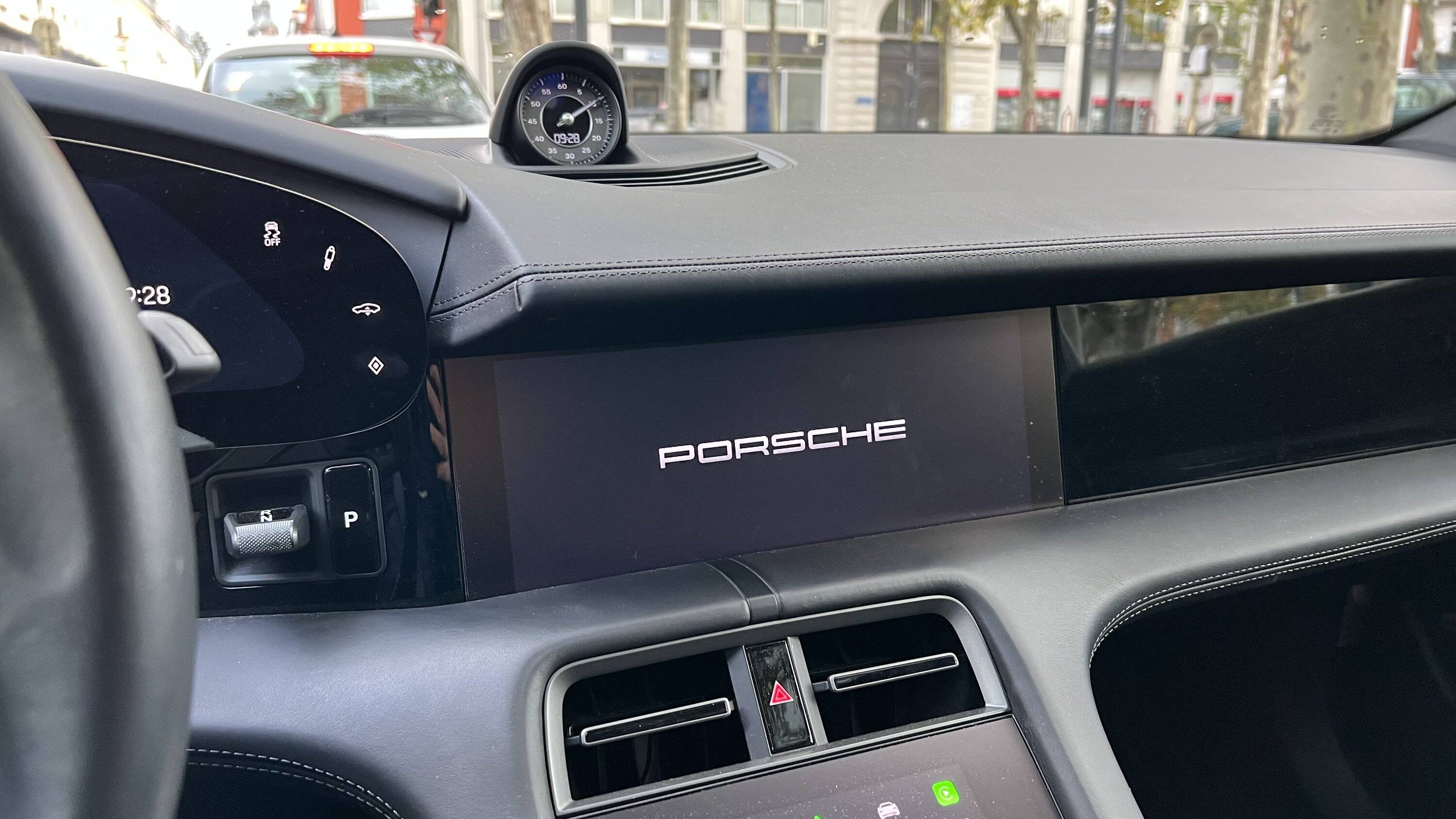

Been having the same issue of PCM freeze (Only Porsche logo) more and more recently, and only constant seems to be in a zone of low cell coverage or when traveling between two countries.
Really annoying when it happens before a trip as you can’t access anything…
