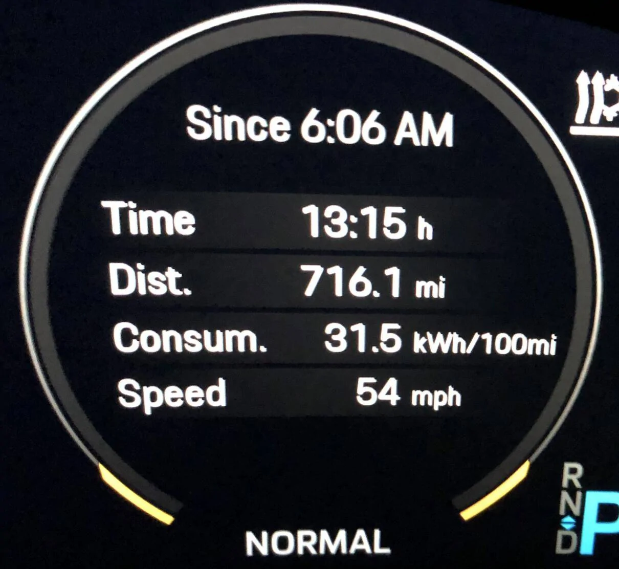

Total stats:
716 miles
Average speed 54mph
31.5 kwh/100mi
The weather was about 30F in the beginning in Boston and was about 55F in Durham when we arrived. It was clear and partly sunny during the entire trip.

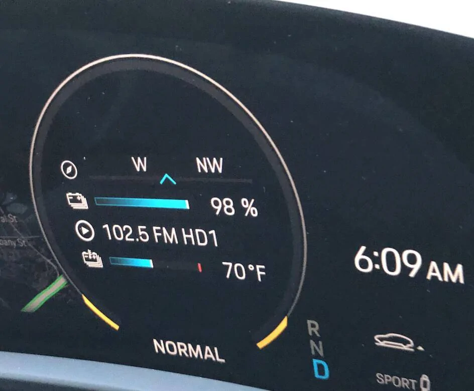

Left Boston at 98% and preconditioned (battery was 70F)

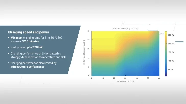

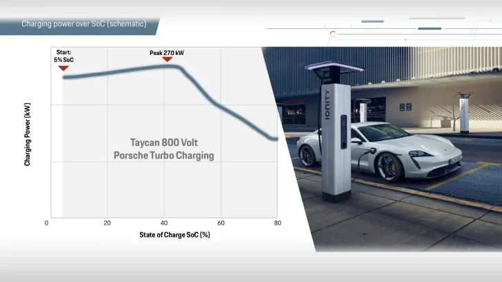

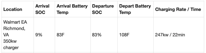

As far as 350 kW vs 150 kW charging, at least on my trip from NC to MS using Electrify America, there were no glitches with the 350 kW stations. On another trip, I did find ONE station where all chargers were "offline" causing me to have to drive 90 miles to the next one along my route (made it with 4% remaining).
Next time you're charging at 150 kW station because the 350 kW station doesn't work, call the toll free number on the charging station and see if they can help figure out the problem - whether the 350 kW charger is off-line or it's "operator error" - after all, you've have time to call while charging "slowly."
And just because it's labeled 350kW does not imply that you will get 350 kW or even a high sustained rate. Typically your "real world" charging rate will average 150-200 kW even at the 350 kW stations and taper off as you get above 80% SOC. Remember, 350 kW is the charger's max capability, but the Taycan is controlling the actual current draw from the station.
Here are some "wishful thinking" graphs that show charging rate if everything (battery temp, etc.) are ideal (actual rates may vary :)

Dumb question (sorry, my tombstone is going to say "He was only trying to help"). You did note that SOME stations are labeled 150 kW while others are labeled 350 kW, right? My experience is that there are more 150 kW max stations than 350 kW stations at the EA locations I've been to.

I had two 350 chargers on my return trip where the charge rate was slow (one was 26kw and the other was 64kw). While I was in Durham, I also charged at a local EA station and the 350 charger delivered only ~60kw rate. In each of these cases, I stopped the charge and moved to a 150. Actually at the Durham location I had some time so I tried another 350 and got something closer to 100. I also called the EA agent and they told me the handshake was poor - for one of the sessions they said the handshake was 75kw. In my experience, when the 350 charger starts out below 100kw it doesn't improve and I just moved then to a 150 where it seems like I've consistently gotten a rate close to 150kw.
On my return trip, I also was able to successfully use two 350 chargers. In each case the rate was about 250, which was great! And look at that - my charge time was not far off from the graph you found showing 5% - 80% in 20 min.

Regarding this: "Dumb question (sorry, my tombstone is going to say "He was only trying to help"). You did note that SOME stations are labeled 150 kW while others are labeled 350 kW, right? My experience is that there are more 150 kW max stations than 350 kW stations at the EA locations I've been to."
>>Yes, there are far more 150s than 350s. At the large EA sites, there were something like eight 150 chargers and two 350 chargers (each of which has two plugs).
