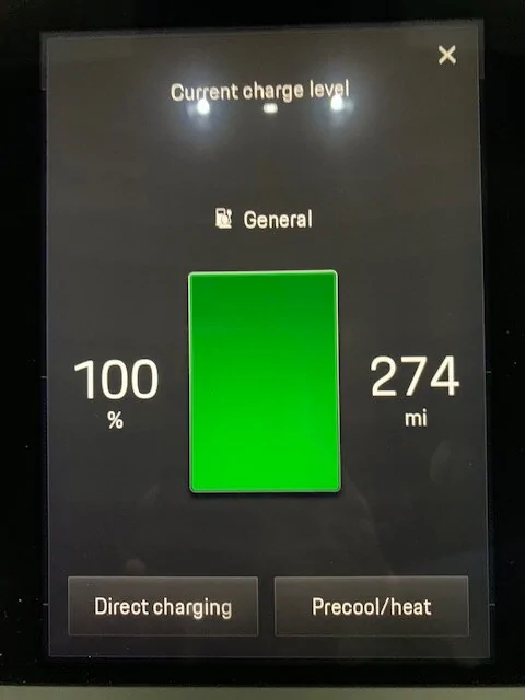

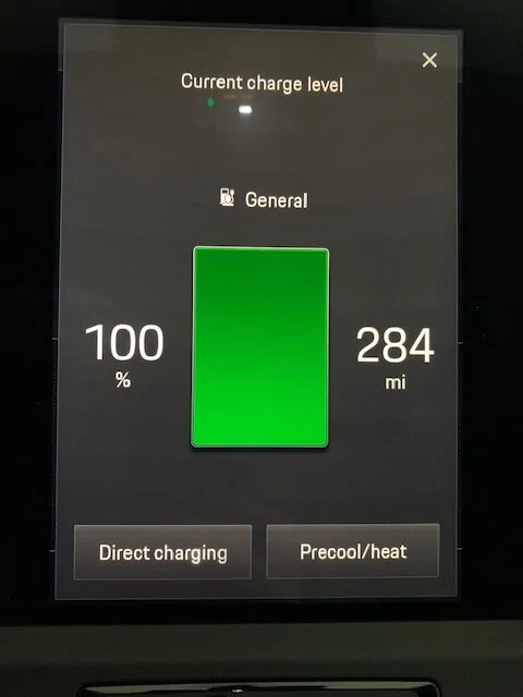

This morning, I charged up to 100% because I will be driving down the Jersey Shore and back soon. The projected range was 284 miles (457 km) while my garage's temperature was 58 F (14.5 C). Before I will be leaving, I hopped in the car and drove down to the bakery to get some sandwiches for the trip. Back and forth only 2.4 miles. When I came back the charge was still at 100% but the projected range now shrank to 274 miles (441 km) because the outside temperature was 38 F (3.5 C).

I'ld be more curious why it stayed at 100% rather than why your range dropped... Its pretty well established that an EV's range drops somewhat significantly in colder ambients (cabin heating, etc). Once your car figured out it was driving in 38f (and seeing the electrical load which was being required) it was simply adjusting its estimate.
As you don't use 100% often, maybe the car is still trying to figure out exactly "where that is"...

Or because 2.4 miles to fetch sandwiches and back is less than 1% of the projected range and the system does not round downward?
I bet you are correct. I didn't do the math... :-(
So, what then is it that you find surprising?
I don't know whether the car looks at the "surprise" outside temp and makes a pro-active adjustment to the estimated range based on some internal tables - or if it simply watches the actual increased electrical consumption and bases the adjustment solely on that. (I think it fair to say that we DO know it watches actual electrical consumption as it does make adjustments based on driving style).
It would be a curious test to take your car from the relatively warm garage and simply roll it outside (don't go anywhere) and see if the range gets adjusted purely based on the outside temp.
I've done this, and yes the car does seem to update range based upon temperature - simply rolling-out the car from the garage to the driveway for a couple of minutes results in the range plummeting.
Good info!
...I guess the next question is: "How accurate is the prediction?"
Good question. I've not been quite so convinced by the accuracy of my car's range o'meter (think others have found it pretty accurate), but I've found that the "colder" estimate is definitely closer to reality than the estimate in the garage.
