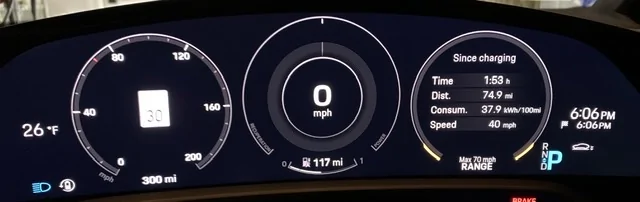

Ok so I suffered all the way back today in Range mode. I drove mostly on highways in Range mode, which limits you to 70 mph.. I was driving 65-70 most of the way. There was not preconditioning, temp was 30, the car was outside all day and I had heat set to 72 (and seat heat and wheel heat on). Same driving style. I drove a total of 75 miles and battery went from 85 to 50 for this trip. So 35% for 75 miles=214 mile for 100%->0. This is actually pretty good for temperature that ranged from 26-30 and with cabin heat. This lines up with the cars self reported 37.9 KWHr/100 miles (221 mile range for 84 KWHr capacity).
Keep in mind this is the “larger” battery. I will now STOP driving in range mode, I mean come on! :)

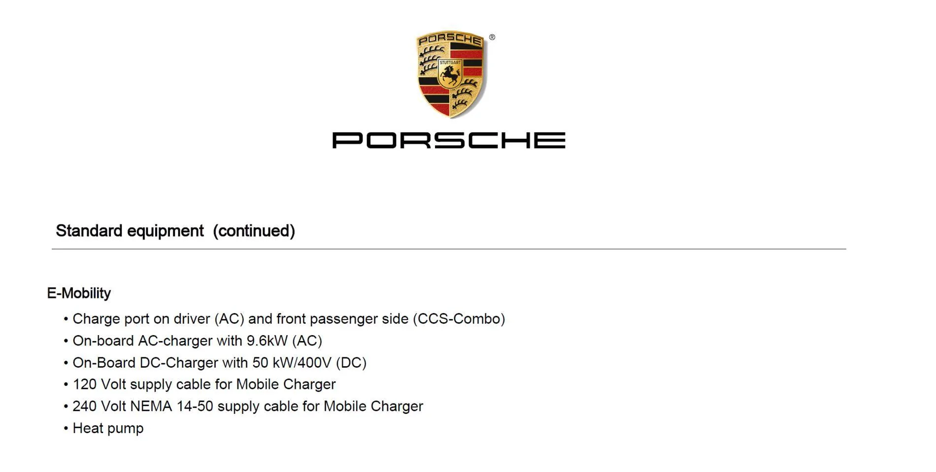

svp6
Oct 6, 2019
113
104
MN
4S
All US cars have a heat pump as standard. Thanks to LFCdan who found it on UK site - it is burried deep....
When you save your configuration on the US site and choose to print rather than just generate Porsche code you will get a pdf document. Scroll toward the end of the document and you will see under E-mobility heat pump.
Voila!
