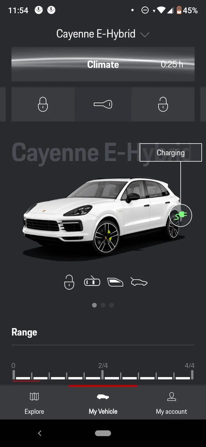

And the Porsche Connect app ... Only thing I wish it had was remote locking and unlocking which I sometimes use with other cars, but that is minor.
That might be a security thing, Porsche was not willing to take on, considering what the car costs...
I don't know about that conclusion. All Porsches are expensive and Porsche Connect offers lock/unlock for the Cayenne E-Hybrid.
I think it will be enabled soon, just not a priority at the moment.
Porsche Taycan Owner Discusses Taycan Range, Battery Longevity, Charging and Related Concerns Screenshot_20200131-235436
Oops, I know that the thread police may be close behind me. If this remote lock issue continues I think we need to move to a new thread.
