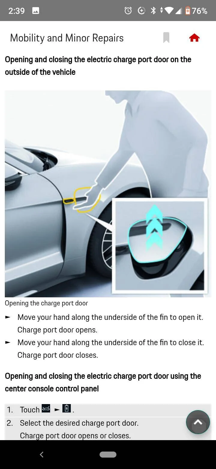

@Mmcdonough love your report.
Per your commitment
5. The charger door on the car can be touchy to open and can cause frustration and I have not found a way to open it without the touch sensor under the charge port door.
6. 250 miles at 80 MPH is the max.
7 try to recharge above 22% it appears to reduce charge time.
I suggest you use the center council control. The same screen where you can open the frunk and trunk.
I suggest you download the "Good to Know" Porsche app from the appropriate App store. It's available for USA I know.

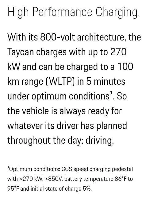

I think that your battery was cold if it was slow at 10%.
You can display the battery temperature on the curved display right hand side. It's an option for that list of details in the summary view. For faster charging you want 86 to 95 degrees F.
You may want to look at a thread I created in December.
https://www.taycanforum.com/forum/threads/optimal-taycan-charging.720/
This is from Porsche.com
