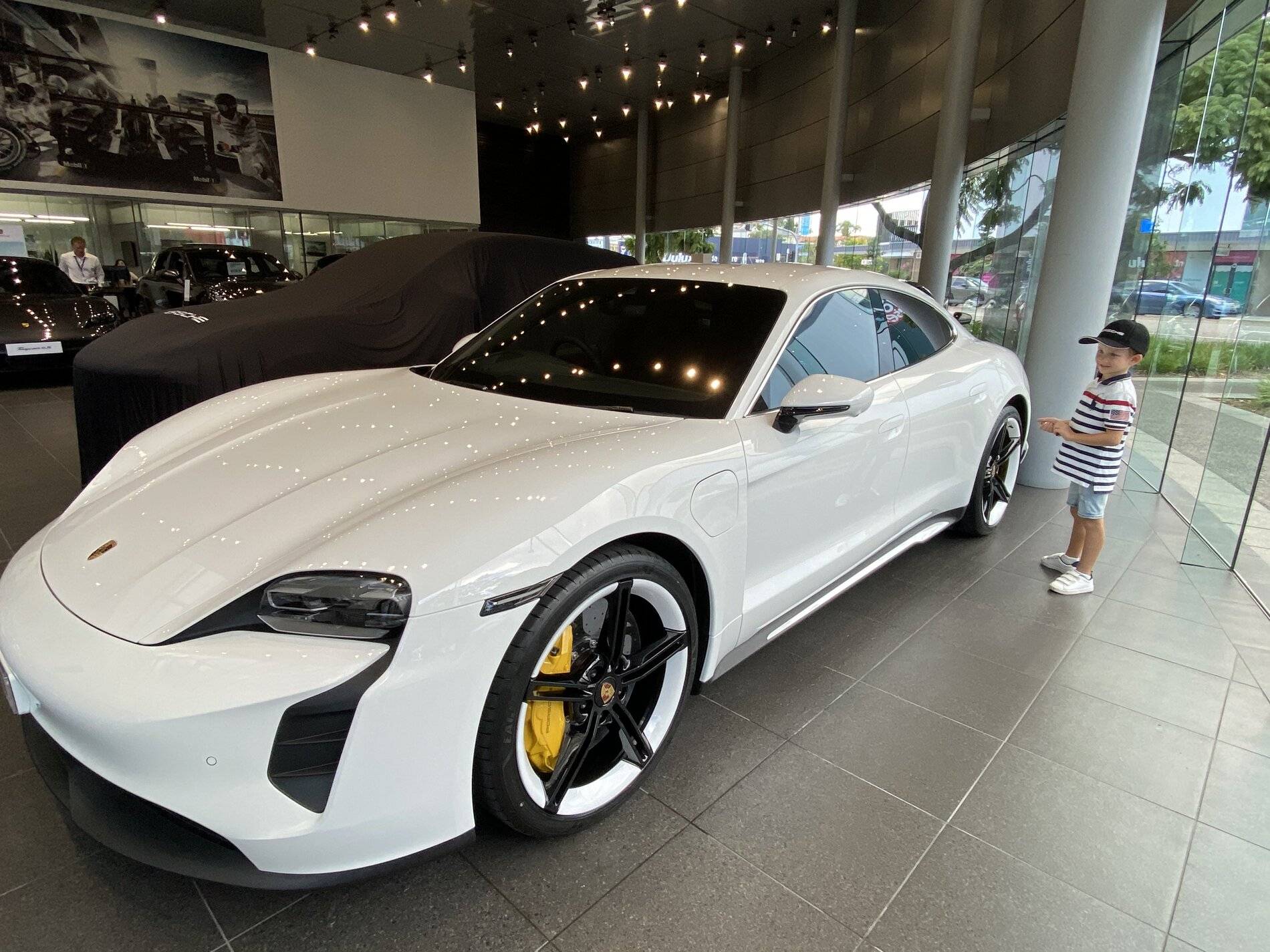

I live on the Sunshine Coast in Australia which after my travels to Florida, pretty similar weather and I didn’t get the pano roof on my 4s. Having said that though I’ve got young kids so it wasn’t so much about the heat for me but also the extra light in the cabin. I just spent the money on other extras, sport kit, yellow brake callipers, mission e wheels.
Nice photo.
If the young man is your son, sell the image to Porsche for the Keep Dreaming revival commercial from 2007, your 2021 version with a Taycan.
I know as a kid I always dreamt of owning a Porsche 911. Fortunate to have gotten it and the Taycan.
Beautiful Taycan yours.
